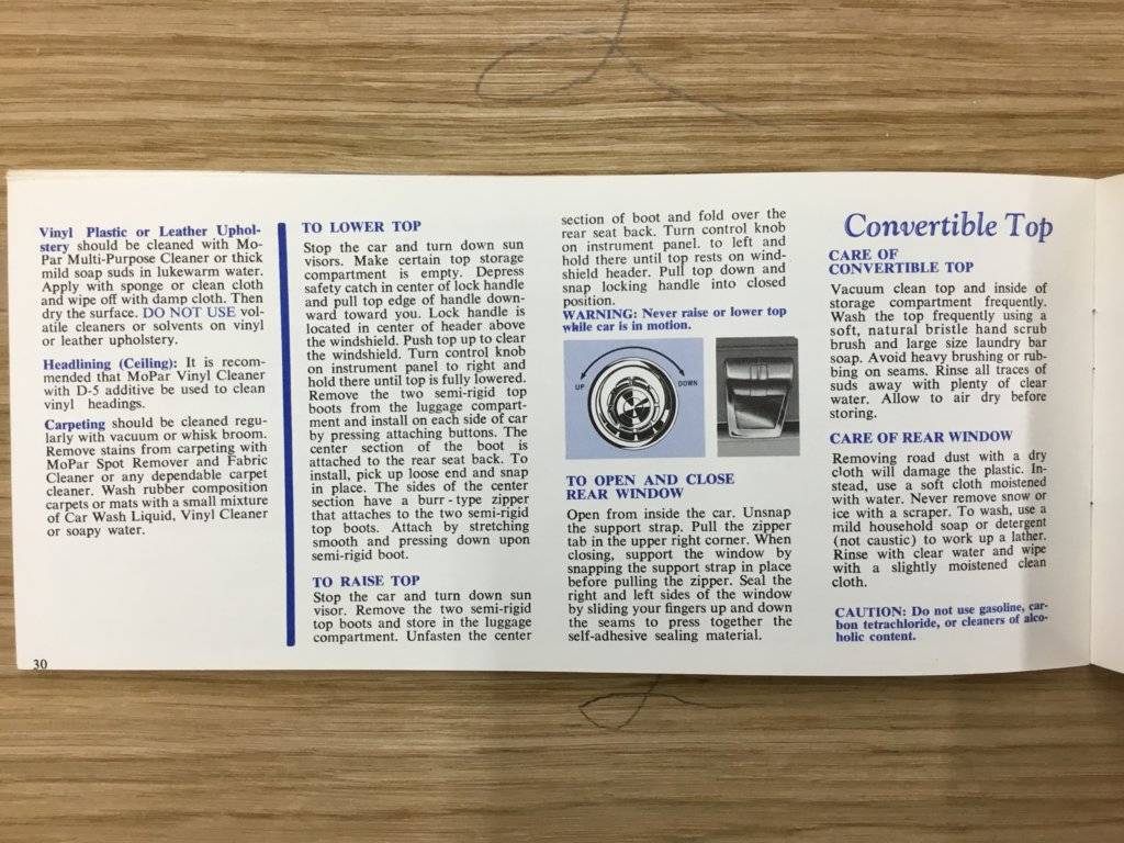

From a ‘66 glove box manual.
Cool, thanks. At least it's not a requirement to unzip the window. That was my big concern. Gotta say that zipping that wndow back into place is a bear. I've lubed the zipper with bar soap, which makes it easier. Having the top up, but not secured, while zipping or unzipping is helpful....
Thanks for the owner's manual pic!

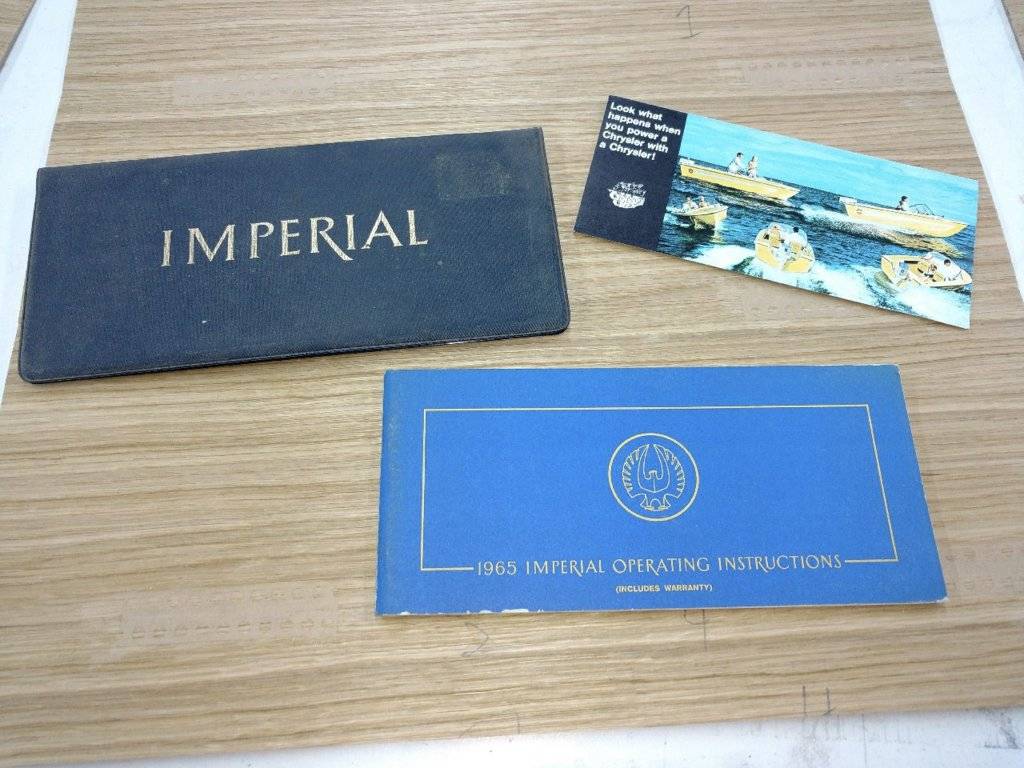

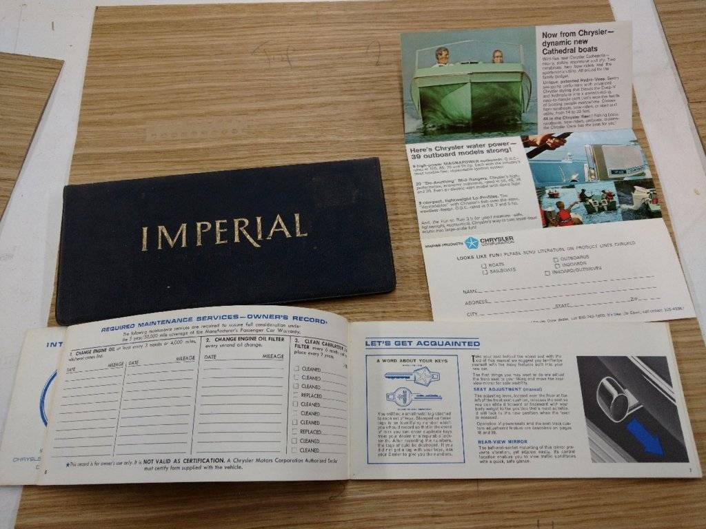

I have for ‘65 as well if yours is missing.
