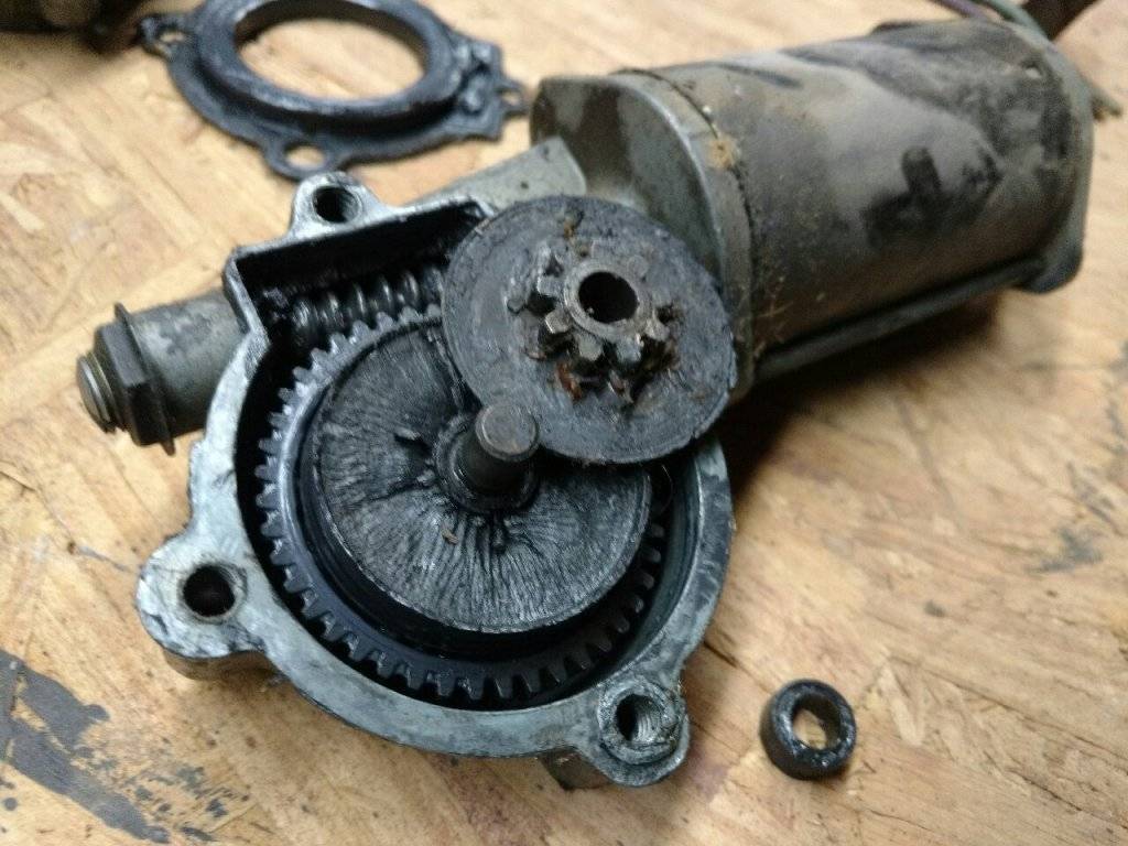

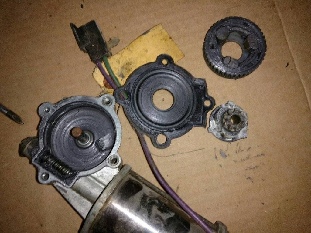

Well lookie here, there are 2 types of gear assemblies but I believe they will both fit all the motors. I think the early ones are the top pic and are junk while the bottom pic is a Motor from '76 with the rebuildable gear assembly, what year they changed I don't know. So we need to come up with some later gear assemblies for your motors as long as they're still good electrically. I may have one extra at most or maybe the later gear assemblies are available, I may have a box with a part number on it we could use to search for replacements. I'll check tomorrow.

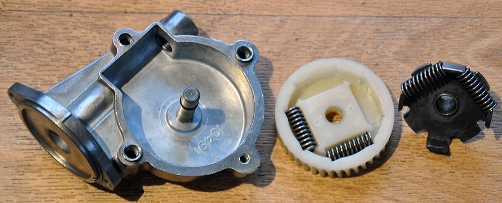

There actually was a third version and probably the best design of them all. With springs which can't fail like the pucks or even the rubber. But hard to find i guess...
I don't know when they changed the design. My '69 had the springs in the front and pucks in the back (or the other way around)...

I'm still not a fan of the steel nut mothod. There was a reason the pucks were the weakest point. If you change to steel nuts, the gear itself will be the weakest point and that's not good because every end stop goes directly into the gear itself.
I agree with this 100%. I also believe the "pucks" are in there as a safety device. I was a kid once... LOL.
You can buy enough delrin "pucks" for a few bucks to do all the windows. The delrin isn't going to break down like the original plastic is. I can't see a reason to use the nuts.

I had the need to rebuild a motor on my former 1978 Lincoln Continental Mk V Pucci and that motor had three triangular plastic pieces which were replaced with urethane ones. My mechanic said the idea was that if the motor was over stressed the plastic pieces broke, preventing the motor from burning out, preserving the motor in any case.
Before purchasing new ones you could try stripping, cleaning and rebuilding yours, then again the Cardone ones may save time and hassle.
