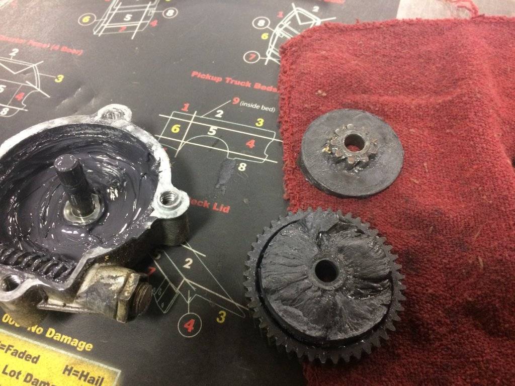

I can anyone tell me what year and application this power window motor might be from. It was just taken out of my 67 Imperial and I was expecting to see the design that had the "pucks" design
Those are the correct motors for the car, the same ones featured in the thread that Doba posted the link to.

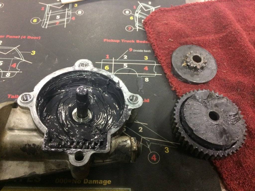

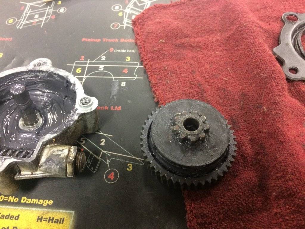

I must be missing something. these three pix show the rubber top with the small gear at the top seared in half, where the illustration in the repair instructions shows a rubber gear not metal piece. not rubber? For the sake of unstanding, do I replace the missing pucks under the seared piece and then try and find an undamaged gear?
Almost looks like someone attempted another type of repair by eliminating the pucks altogether, and replacing it with a flexible rubber and gear combo.
yes, That's my assumption, There is NO way this is the assembly described in the article for repairing the puck. I'm guessing, like you, some attempt to modify the assembly.
Are all your motors like that? You may have to source originals and then do the repair as described, or attempt to glue the pieces you have together, perhaps with rivets as reinforcement. However this fix was done, it obviously didn't last long, and I would be wary of using the same method.
yeah, I had the same thoughts. We are in the process of taking the other windows apart to see what's there and perhaps if original, use those to get the front windows working and disable the rears until I can source the correct assemblies. but thanks for your time
