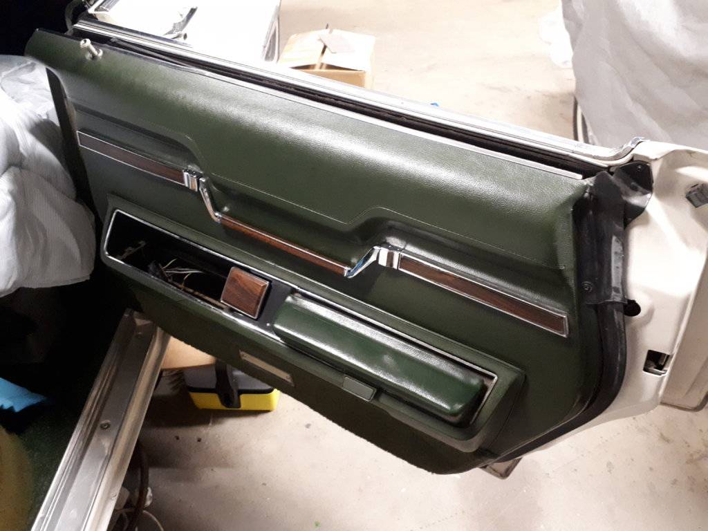

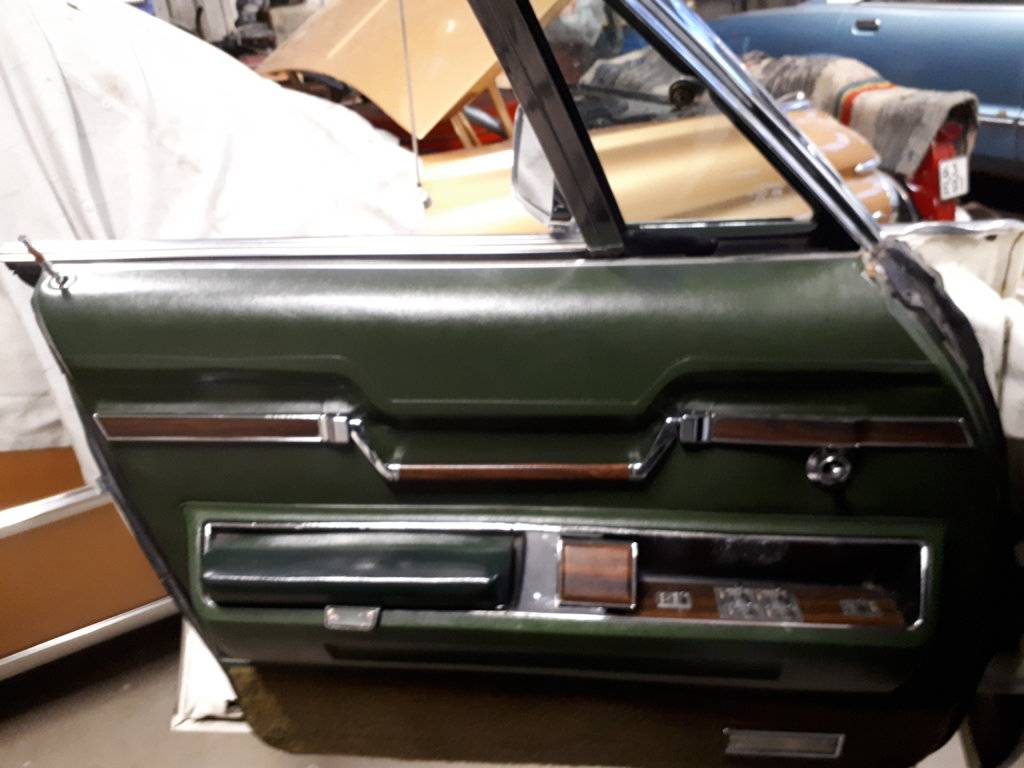

    Now the right rear door is almost complete. The window switch needs a bit better solution to keep it in place.

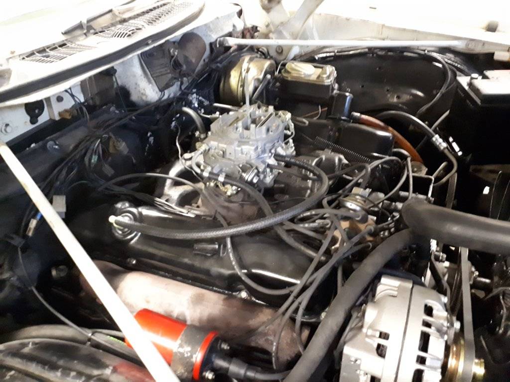

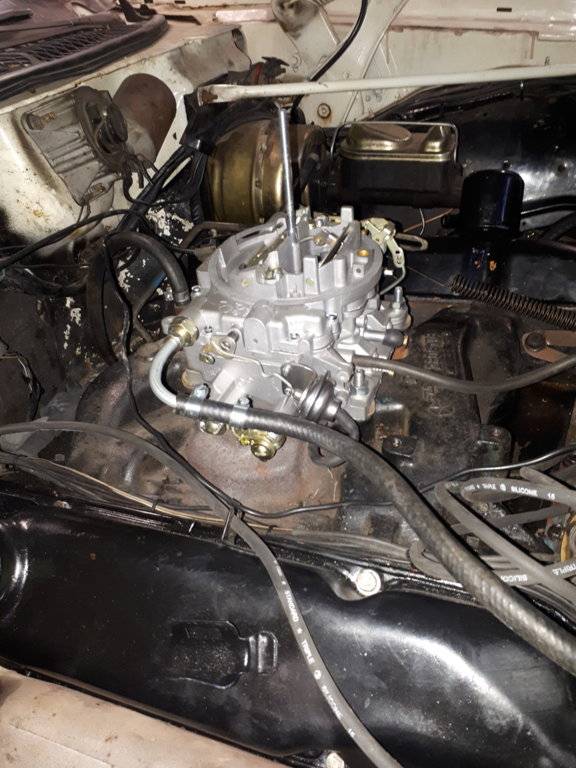

    Replacing the carb is finally completed! :thumbsup:
    The fuel line connector took a few mistakes to get the correct one in hand.
    After getting gas up to the AVS, the 440 ran smoothly.

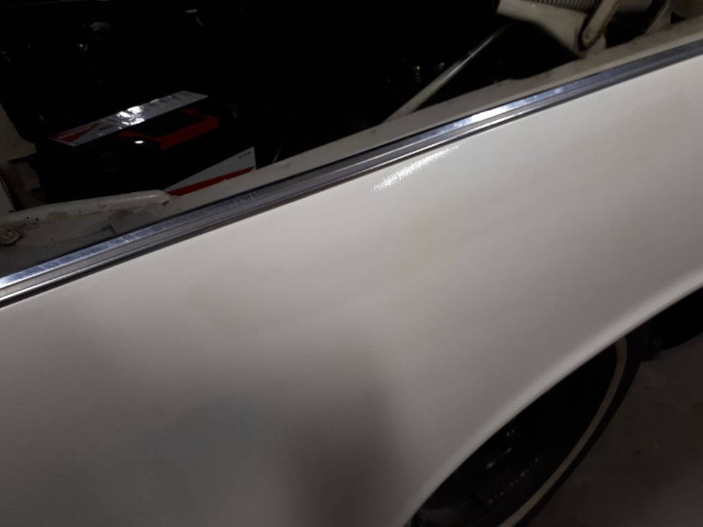

    The left front fender got paint today, but it´s not good enough as is.

    The PCV valve is finally connected to the carburetor. Hose! :rolleyes:

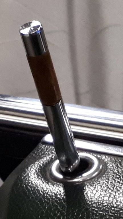

    All the door panels are back on the doors with splash shields also in the back doors. Like you see, I "drew across the lines" with...
    These door lock knobs. At first I was searching for OE style knobs made of metal, but then these showed up. Real metal on top, just a little part of genuine wood and the rest of metal = great! :)
    Plus the shape is completely cylindrical, which doesn't draw attention like dice, cones, etc. and these are the oddity that I didn't compare to any other knobs - just bought them by looks.

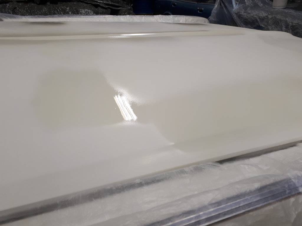

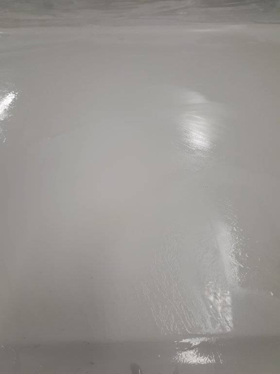

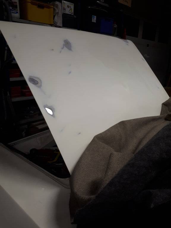

    Currently we've been repainting the hood and front fenders and I decided to spare you from the dust-sand-paint-run-down-sand-paint-more-dust-sand-paint...
    Today sort of mid paint (too yellow for final coats) was sprayed down to cover the primer as well as to show possible grease, holes, whatsoever to sand before spraying the white paint.

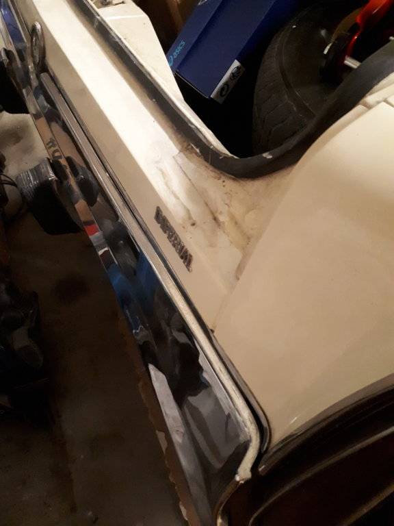

    Sanding continues, part nineteen/damn many. :rolleyes:
    The trunk lid has been repainted on quite a bad base, so it must be done yet another time.

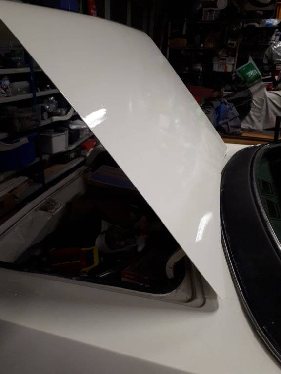

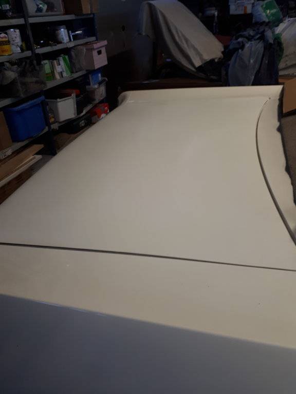

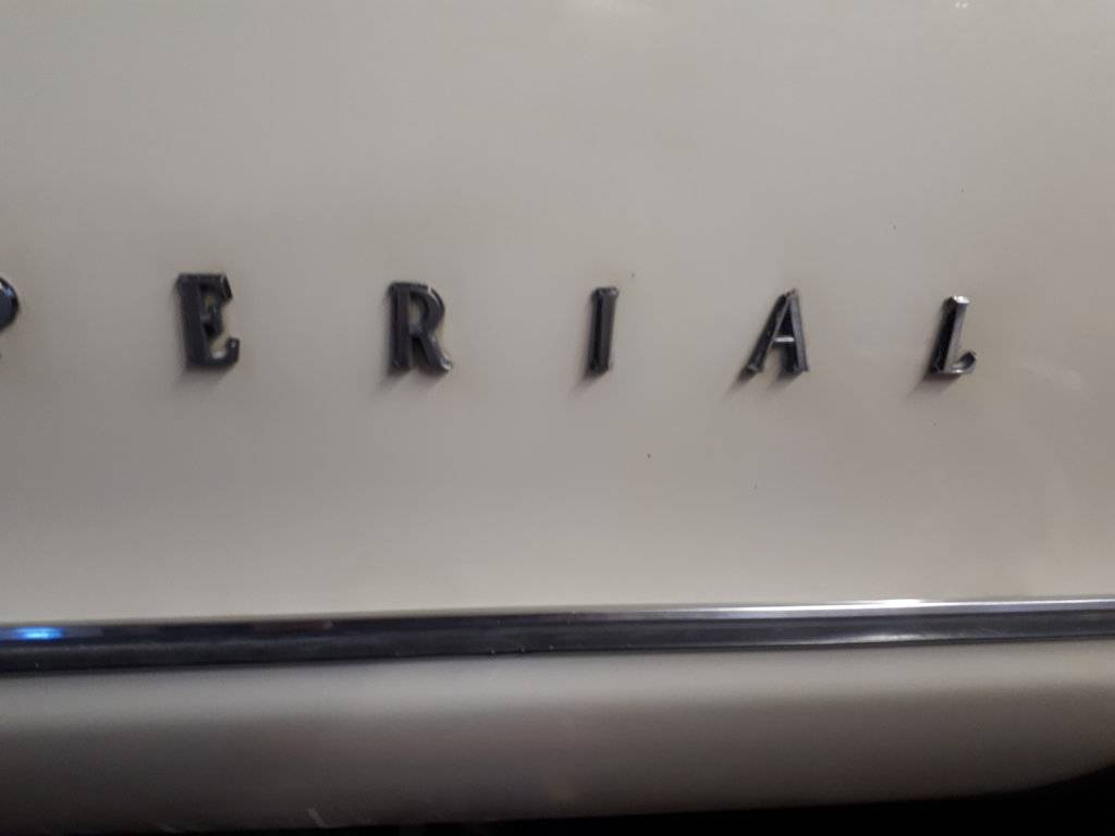

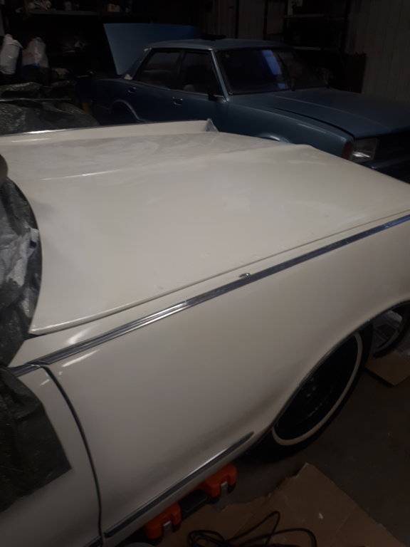

    2 1/2 hours of covering and then painting the hood, trunk lid and inner top sections of the front fenders with not too good results. :BangHead:
    There's sand paper on the shelves, the paint will buff out after sanding... :rolleyes:
    There you see some "artistic license" i.e. I removed the "by Chrysler" script.

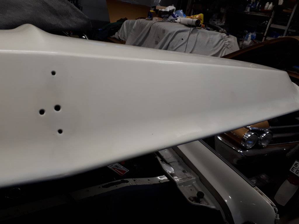

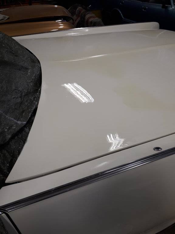

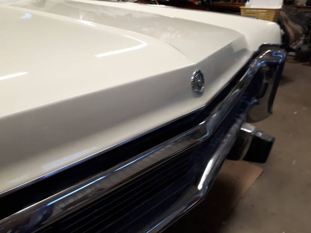

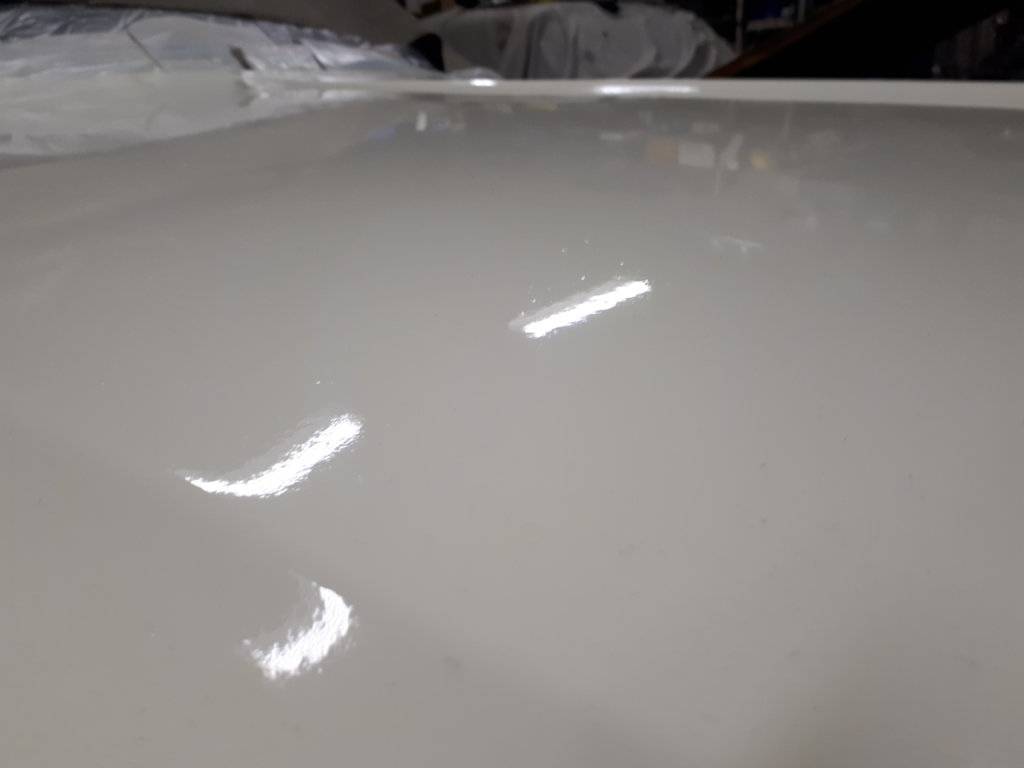

    Okay, the hood is now, well, better. :rolleyes:
    Dad sanded, I buffed and sanded another time.
    There's some slight scratches in the paint, isn't there? :poke:
    PS, water and dust, too.

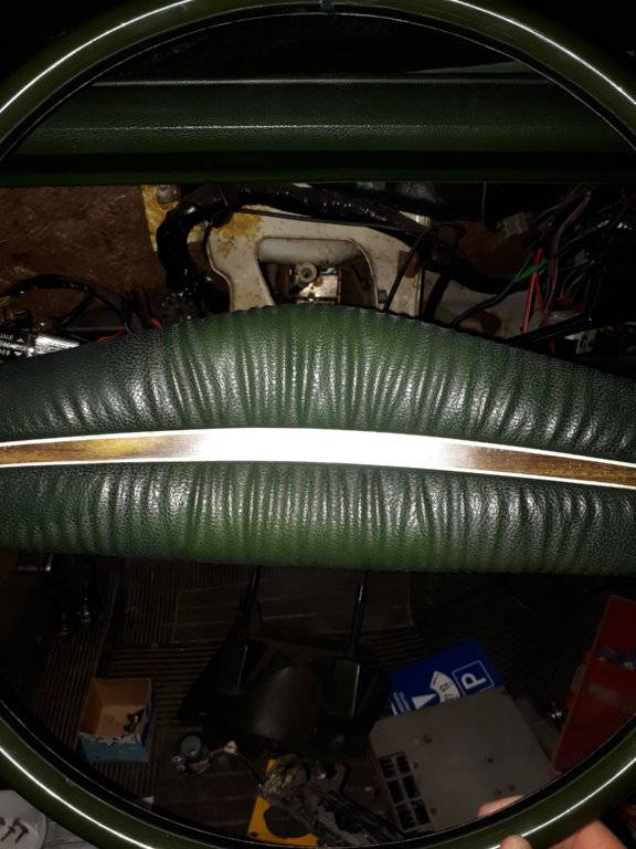

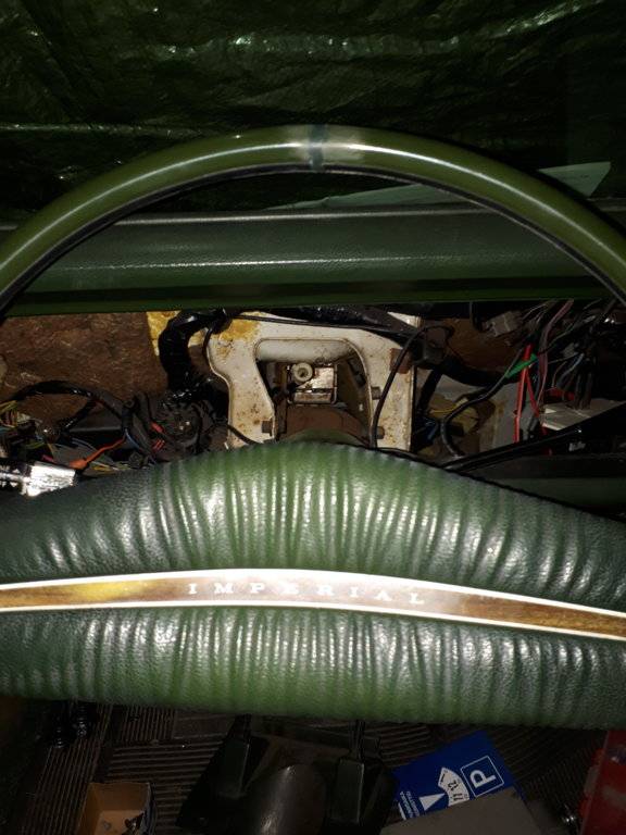

    The steering wheel is back! :thumbsup: Now the horns are functional after taking out the insulation , which insulates the contact spring from everything else than the two tabs, which made of a bottle cap and replacing it with a plastic disc.
    :popcorn: I'm waiting to get the dash ready for completing. A bit of masochism included... :realcrazy:
    It's far from nice, but I'm just fine with this steering wheel for now.

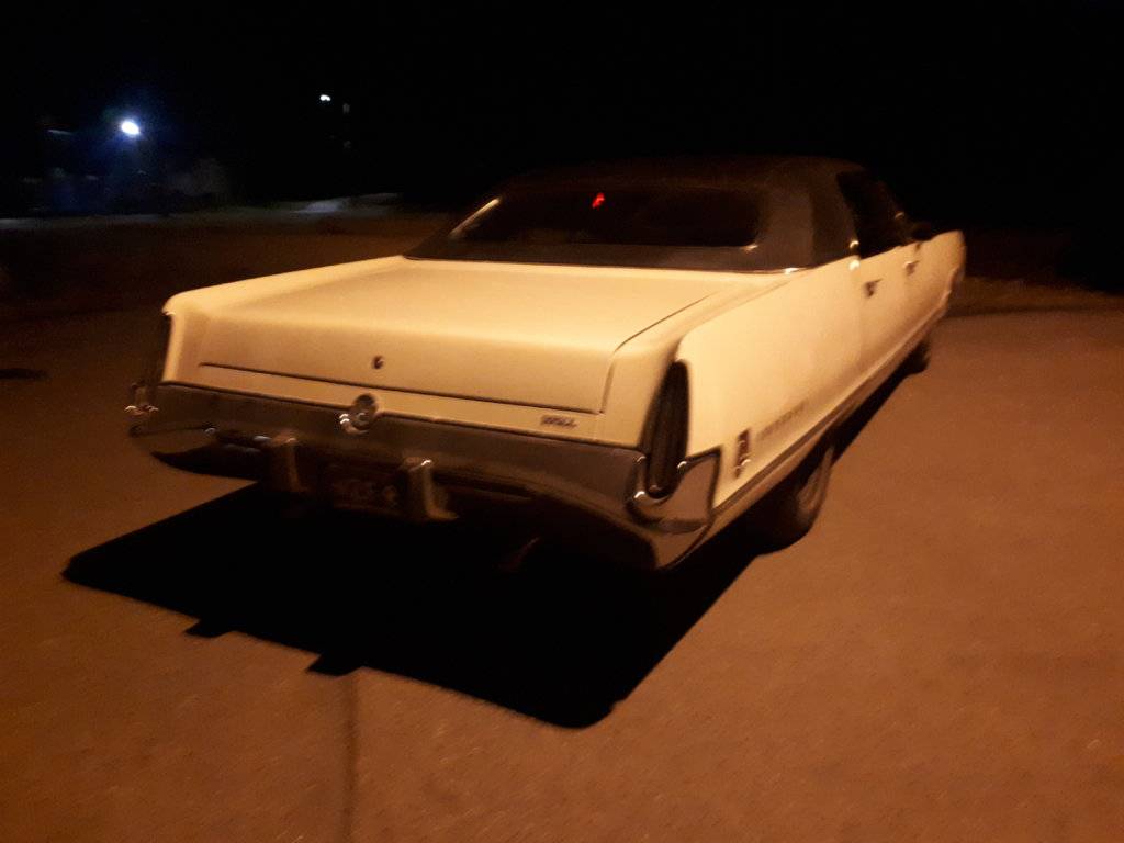

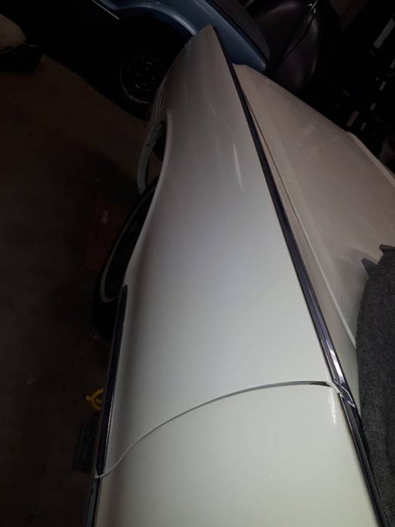

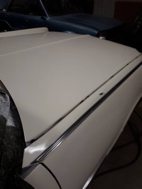

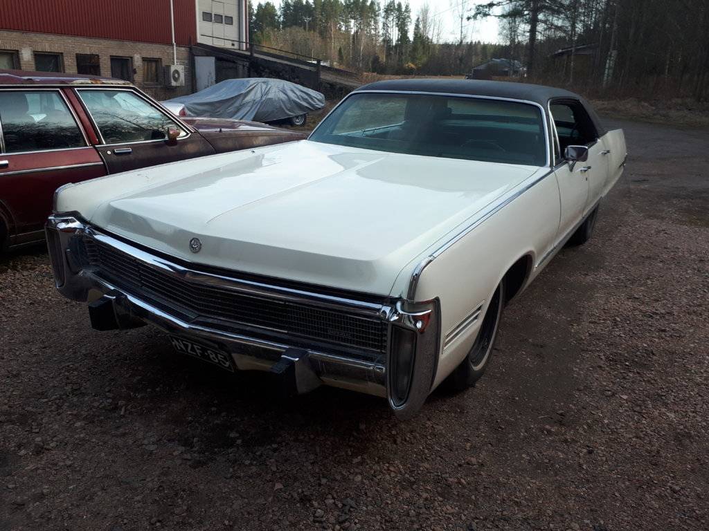

    I got some trim pieces back on and the hood and deck lid are now painted, though in need of light sanding.

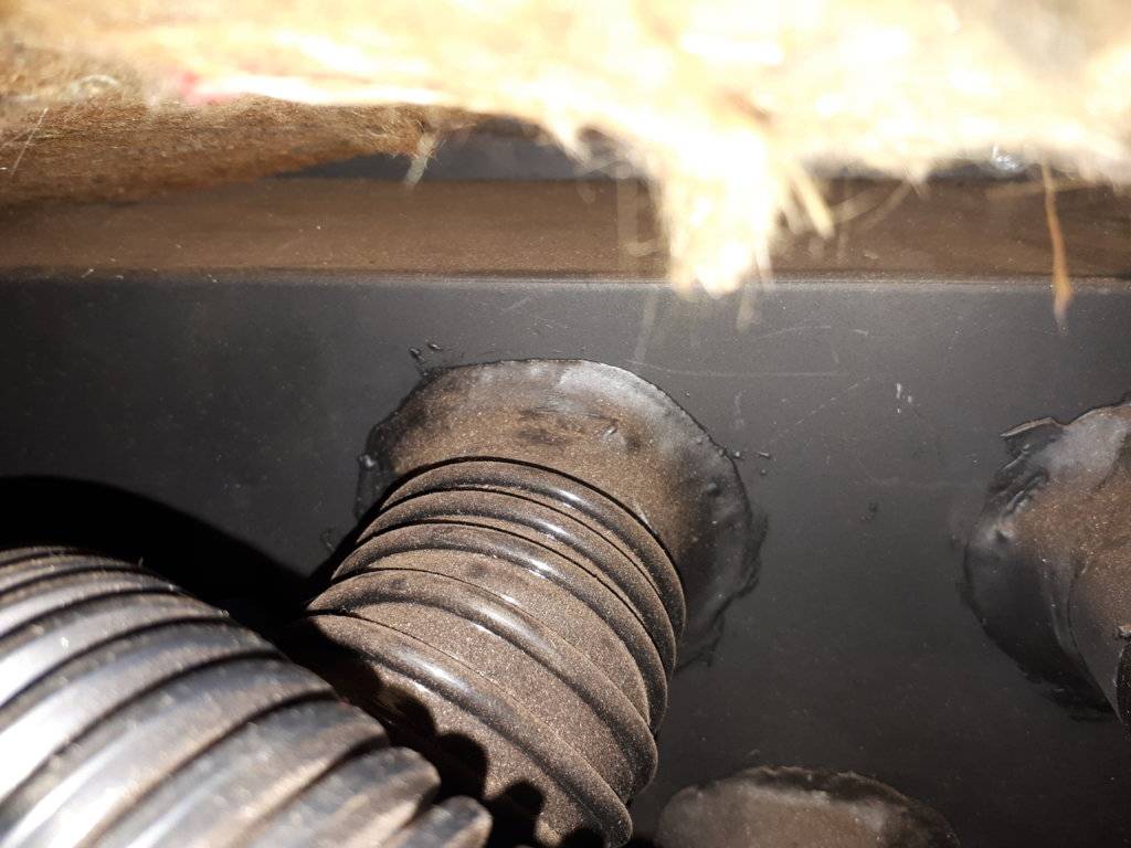

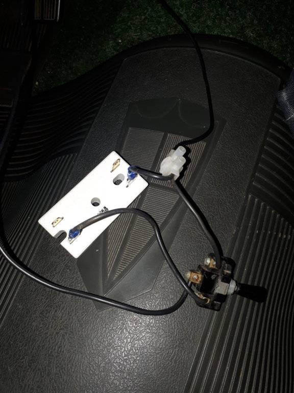

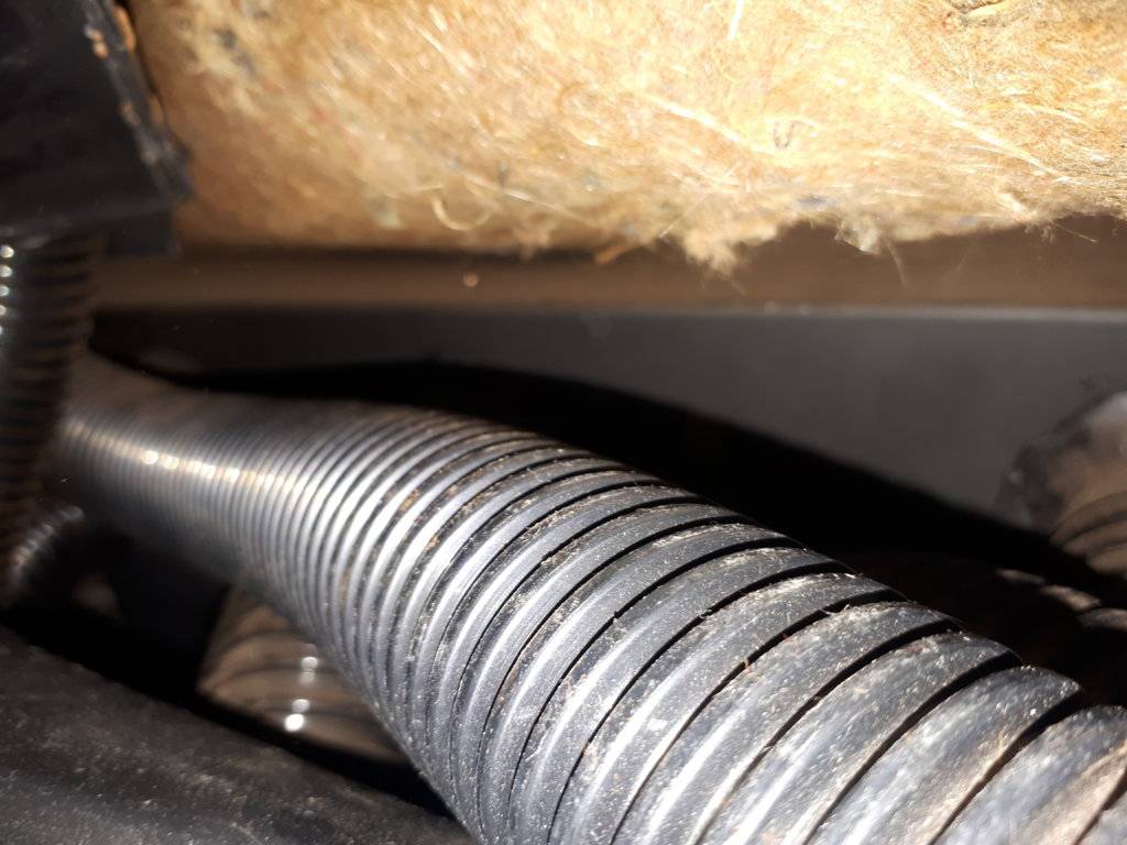

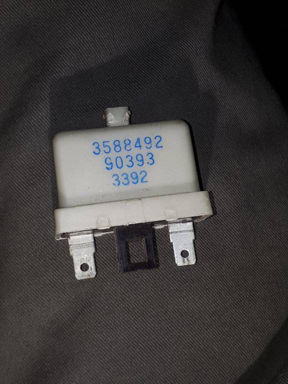

    In the photos you see the one of one Finnish heater system installed to an Imp. :wtf: One of the POs had had this done.
    The ballast resistor reduces the electricity flowing through the other wire thus the heater functions on two speeds and the switch is reversed so when it's up, the current flows trough the lowest wire and the heater works on full speed and vice versa.
    There's a cable under the left corner of the dash, which controls the air that flows towards the driver and passengers and the other unit is for the windshield.
    It works very well, but won't burn the car down, so I'm fine with it, but the 4-prong BR must be replaced with a 2-prong unit.

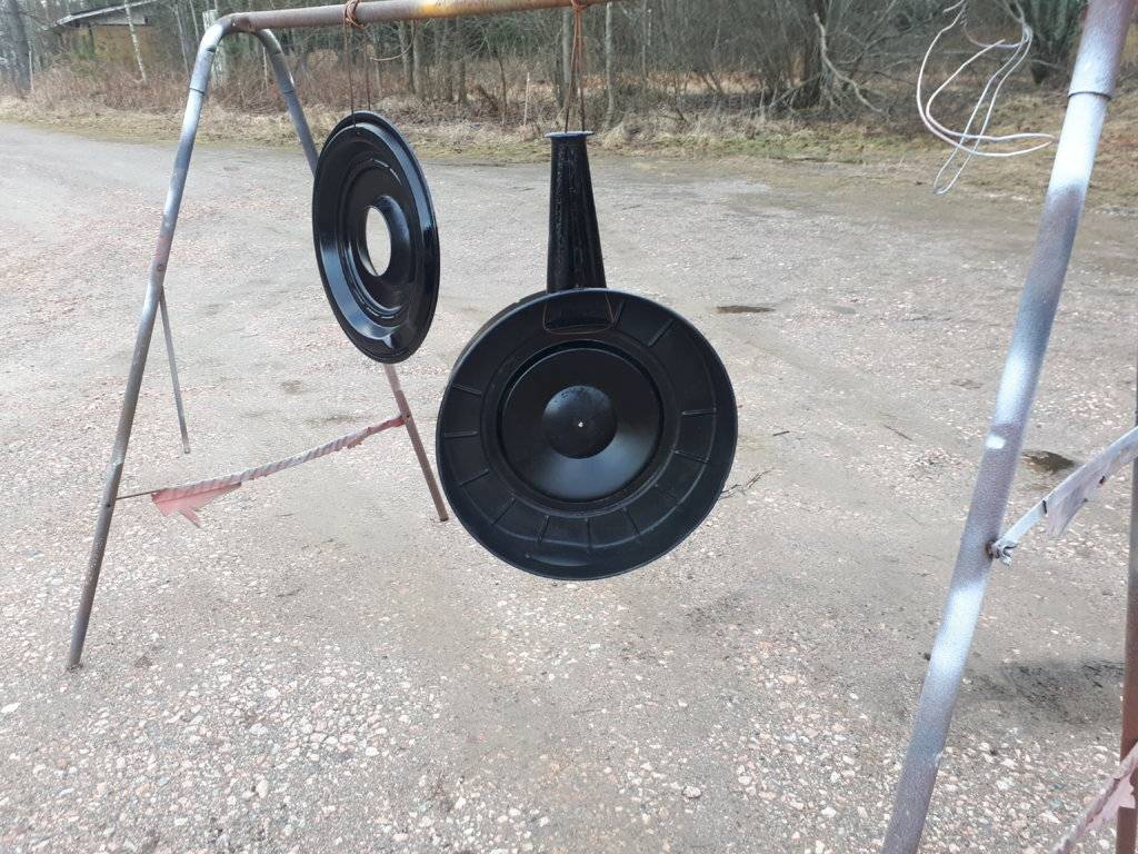

    Slow progress, minor things, and not too many photos.
    There's fresh paint on the air cleaner! :lol:
