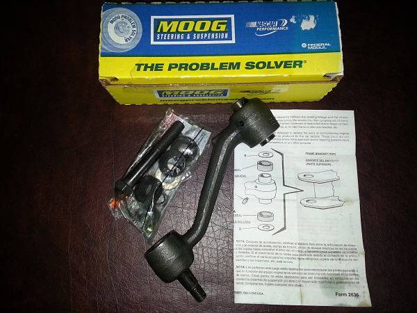

I needed an "Idler Arm" for my 66TC and ordered a MOOG from RockAuto, however it does NOT look nor fit the same as my OEM. For one, the MOOG Box came with nothing other than the Idler Arm itself with no other attachment pieces. It also appears to be a bit "shorter" in length and definitely shorter in height where it mounts between the two brackets.

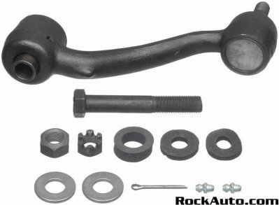

From the pic on RockAuto's site the MOOG is obviously a design change. Although the part should have come with two washers (to somewhat make up the height difference) I still have about 1/4" of space between the brackets.

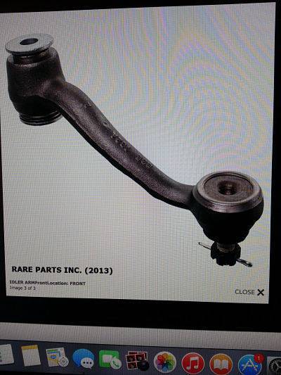

I do see on "RAREPARTS.COM" that their replacement idler looks more similar to the OEM, but without the rubber boot. I called to inquire and they indicated that what is pictured on their site is what they stock. They do no mfg the idler themselves, but get them from McQuay Norris.

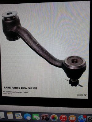

1. What RockAuto is selling - MOOG K-7014

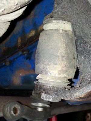

2. My Original - notice the fitment

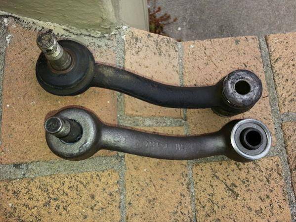

3. Arm length difference

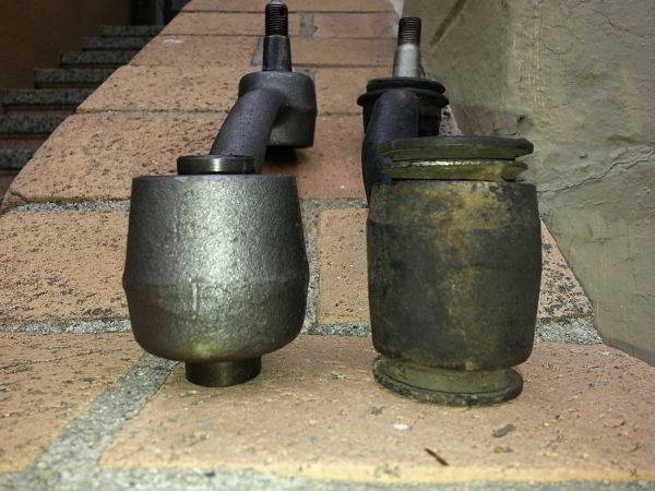

4. Height & Bushing style difference

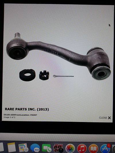

5. McQuay idler from Rareparts.com

1. Photo from RockAuto 2. Original Installed - Notice Bushing Style
3. Slight Difference in Length 4. Difference in Height - Bushing Style Difference
5. McQuay Norris Brand from Rareparts.com
