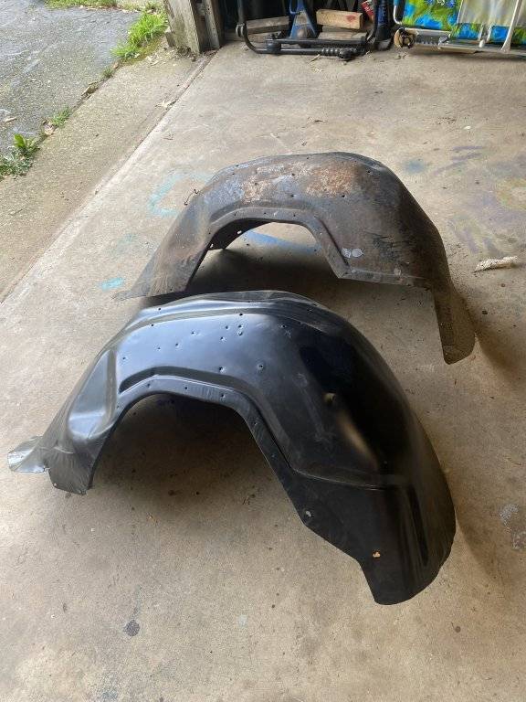

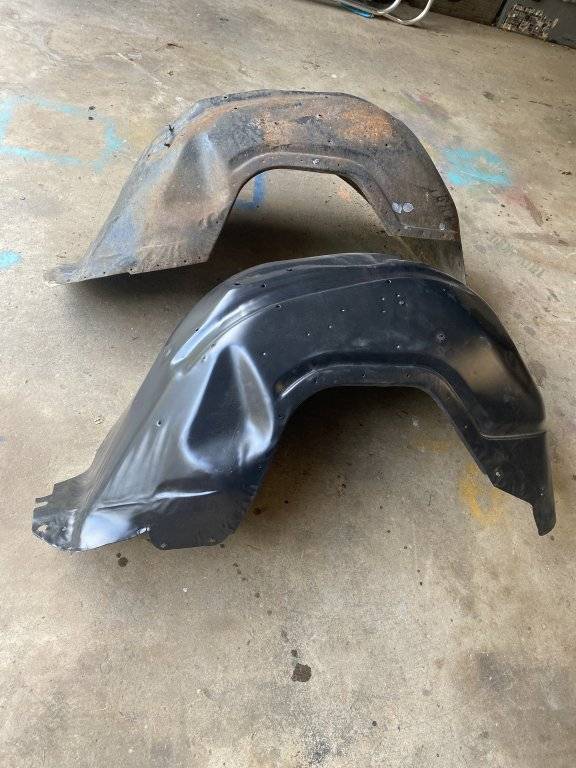

Here is a side by side pic. Top inner is from a ‘73 coupe, bottom is a ‘70 vert. Notice how the lower edge fits differently between the two.
Looks to me like you could easily make a '73 from the earlier, "non-isolated" inner fender, but not the other way around.
There was another issue with the drivers side and the battery tray, I can’t remember what it was. But yes, I think you could easily cut the extra metal away, but why ruin a unique ’vert part when there are plenty of coupe and 4 door pieces available?
View attachment 607257View attachment 607258
I think this shows the difference between a non-isolated subframe inner fender and an isolated subframe inner fender. I still don't think that there's anything unique about a convertible inner fender. I think the non-isolated subframe 1970 convertible inner fender fits all 1969 C – body, all 1970 convertible, and all 1970 Plymouth because Plymouth did not switch to the isolated subframe until 1971.
