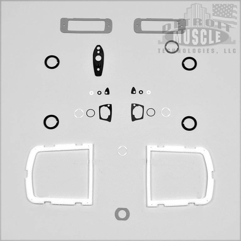

Is there any type of adhesive\caulk\silicone that should used between the quarter panel extension and the actual quarter panel of the car or just simply bolt is on? The extension that I received seem to have some type of caulk residue on it. Thanks for your input.
Since you have residue I am assuming they are recycled parts. In most cases there was a caulk or seam sealer used between the body and the extension. There are gaskets for B bodies available but you will probably have to go the seam sealer route as I am not aware of anyone who makes a gasket for a C body, although someone else here may have a source.
