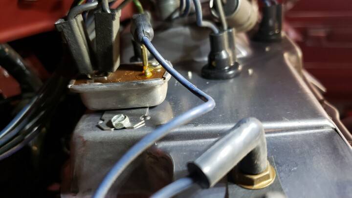

Just to bring this back to life.. I bought a VRC601 to put into the Fury when I got around to it.. Now that I am into the dash again I have found that the Fury ("and VIP" as the manuals group them) actually has what looks like the 71-74 Style VR. Every parts reference I see from the like of Summit, Rockauto etc point me to he VRC601. Does anybody know what the part number is for the correct piece by chance?
What year Fury?
OK, I looked in the parts manual and came up with #2209216 as the correct part number for your car. Looks like this:
and that looks like what is in your car.
The VCR604 is a 6 volt version, used on Fords. All your Chrysler products are going to be 5 volt.
What we need to do is cross the OE # to an aftermarket version.
That would be the unit it appears. Thank you for the snappy mopar reference #
