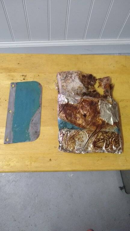

    Make you're own. No one will ever know the difference as it's tucked under the manifold anyway. Depending on your year, you might even have the plate that goes on top of it like I do.
    See the blue overspray? That's all you could see of it when it was installed. So why bother with the repops on something so simple to make.
    Go in your attic, grab some insulation (wear gloves) wrap it in tin foil, stuff the pack under the manifold. Done.

    on my imperial has that same plate so what is that for
  15. James Romano
    James Romano Well-Known Member
    Messages:
    502
    Likes Received:
    267
    Joined:
    Sep 28, 2019
    Location:
    Long Island, NY
    My best guess... Just there to hold down the padding. I saw no other purpose for it.
    So out it came

    For what it's worth... Look at what s left of my original pad. That's definitely not worth what they're asking to make one. If was going to replace it, I was going the hand made route, knowing you cant see it or even the fancy stickers on it anyway.

    on my imperial on that plate is bolted a vacuum tank for the e brake release
