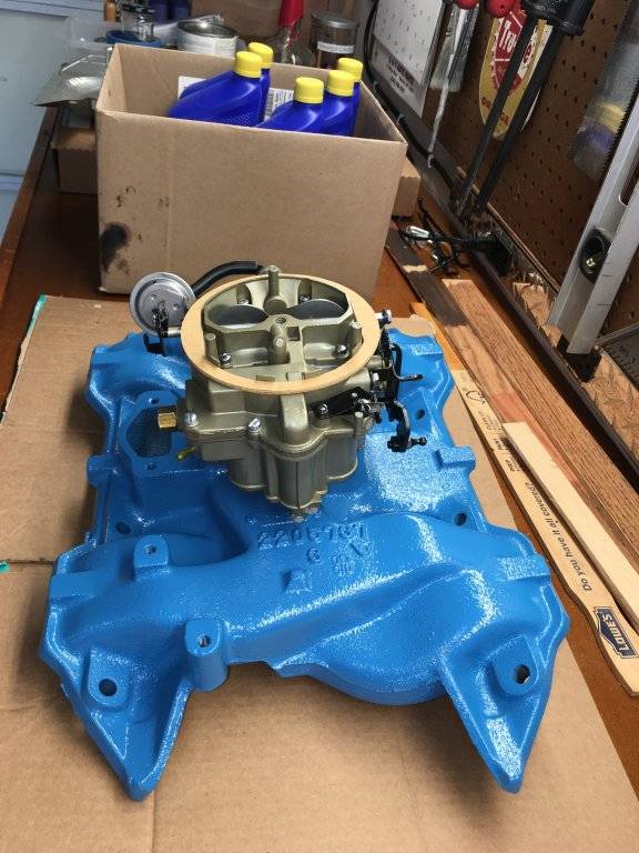

Good Morning Gents, I pulled the intake manifold off to clean and paint before installing my freshly rebuilt carburator. consulting the Chrysler Shop Manual for my ’64 Newport 361, it mentions “non-hardening thread sealant”. Any past experience, one could send my way, would be greatly appreciated. You guys are a font of information and have helped me every time. Thank You and Cheers.

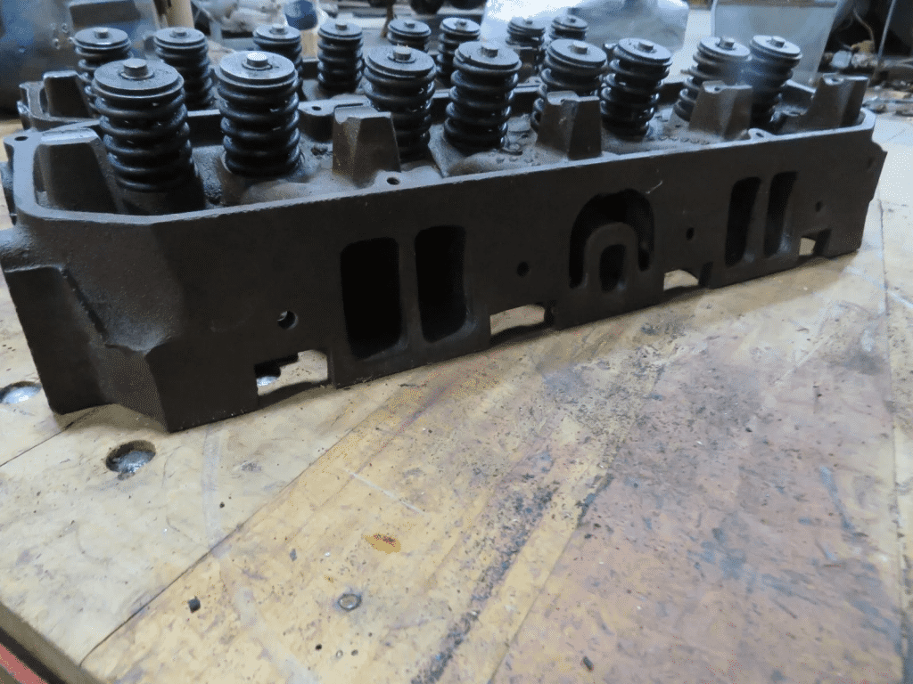

The manifold bolt holes do open into the inside of the engine, so it could seep oil up through the threads. I wouldn't expect it to, but the possibility is there.
You can see the light through the first hole.
