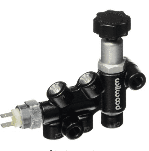

Brakes - Highly recommend converting over to Front Disc Brakes. ’73 setups are the preferred, but 69 -72 spindles would work just fine too. The early spindles are more plentiful than the ’73’s and the good news is that pricing for the early rotors for those spindles are down to $49.95/ea for a 11.75” Bendix 7012R rotor!
Even though Ma Mopar didn’t require/use prop valves in their earlier disc brake cars, I would suggest Installing one anyway. The prop valve is a piece of cake to install. All it requires is to plumb it in-between the master cylinder (front port) and the rear brake line. pmschmitt posted a Wilwood Prop valve that IMO would be an excellent choice. Their bracket is extra, but makes the install modern and clean. Amazon's got the valve for $69.99 w/FREE 1-Day Shipping with Prime!
Amazon product ASIN B003LT619Q
