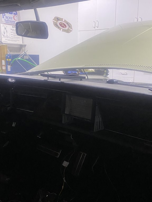

New audio with touch screen in the dash. New speakers back and front (mounted under the dash)

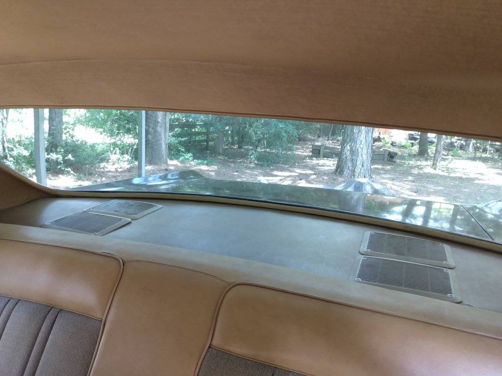

The only place for a speaker in the back is top center back seat. This is a convertible. Behind the seat is the area where the top folds into.

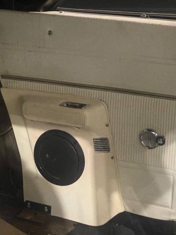

The rear side panels work best, sound is fantastic. Using the speaker in the center seat as a base.
LOL, I knew you would get some **** for cutting those rear interior panels. Well, no turning back now. Enjoy your new sound system. Hopefully your new upholstery is close to oem and doesn’t include tufting and velvet.
Ashame, they look like they were nice panels. There are a lot of options besides the cut-n-run.
Damage is done, I hope the sound is what you were looking for.
Love how they look. Love the sound. Love my car. Love my choice. Would do it this way again. Exactly what I wanted in my car.

There is a way to redeem yourself in the eyes of the purists who get upset over cutting the panels: paint the speaker grills to match. The greatest offense to the eyes is the glaring mismatch.
I took the sections I cut out to a paint shop and had them match the color, mix me up a pint of each, and painted the grills. When it was all said and done, one might be forgiven for cutting up a classic car if you can make it look like it came that way from the factory. The hardest part for me was to thin down the paint enough to spray fine enough to not glob up between the grill slots. This example took 4 thin coats (top AND bottom) to get full coverage to completely cover the black and not show.

The black is by design. The convertible is black the flooring and dash are black. The rings on the window handles are black.
Offset agains the off white seating and panels represents the look I am after.
As far as redeeming in the eyes of the purist. Well. No. They have the choice to not follow or not look no mater how tempted they will be. lol

Not a lot of good places to put speakers in a 69 Newport convertible. And the acoustics are as bad as it gets in a car.
Putting speakers under the front or even under the back seat would work for the base. Seeing as how low base is none directional
But that don't work well for the mids, and certainly not for the highly directional highs, at all.
And even the rear side panels provide marginal results for the mids and less results for the highs.
So, let's go the tried-and-true method of sticking some nice combos in the dash and bounce it off the front windshield for mids and highs, right? Well, no, not without a lot of rigmarole and parts/panels/grills that we don't have handy anymore.
And now ........wait for it......we're back to taking a harder look at those sacred rear side panels. Since we're fresh out of other working options and the rear side panels are the only place left to get some decent tunes from.
Unless we stuff some nice, angled speaker enclosures with premium combos and affix them to the front lower side kick panes by way of going through the vent slots and aim them straight into our ears.

Spot on analysis. I went thru the same thought process. Side panels are where they were put in the old days it was the only logical location.
Did it all done the sound is great but no seats yet. Once the seats are back installed will see how it sounds then.
