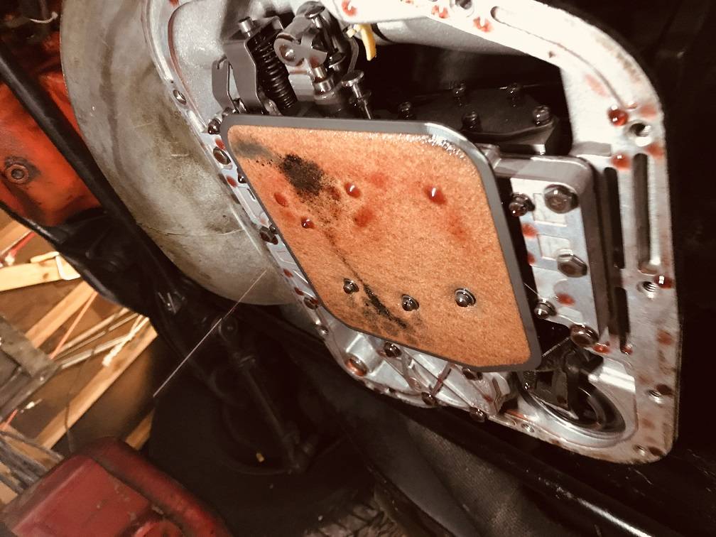

1970 300 - I put about 500 miles per yr on this car. Mostly driving around town so not much highway. Besides the 2nd to 3rd problem I think we fixed in another post, thanks to 413, thethee, cbody67...ok, i can't list everyone but anyhow, transmission never had a smell, odd color or weird sounds. I haven't changed the fluid in 20yrs (10,000 miles ). With just straight Castrol ATF+4, It was leaking for years around the shifter input and rear seal so I put 1/2 pint of AT205 sealer which worked great for such a little amount. No drips after that. I think I added fluid once about 10yrs ago. Looks like I waited too long but at 500-1000 miles per yrear, how long can I wait to change the fluid?

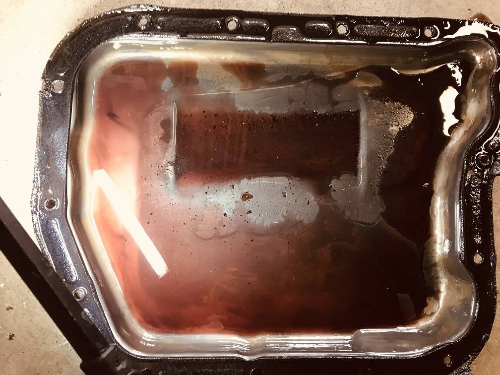

Old fluid that I took out looks and flows almost like new. I thought Great !, until I removed pan and saw this. Are all those black specks from the gasket? I know some crap is normal. Is this some? If its more than normal, anything special I need to do? I'm going to put ATF+4, new filter and gasket. I was thinking of adding 1/2 qt of Lucas transmission medic in it too.
Oh yeah, should I put a magnet inside like new cars have? If so where and what size? Thanks
Yep. normal. Spray it out with brake clean, new filter and fluid. Check the fluid level in neutral, warm. block the wheels.

Just remember, a magnet will only attract metal that wears from steel parts. There's usually black gunk stuck to the magnet. (powdered steel from the gear teeth). The brass thrust washers won't stick and neither will the fiber from the bands and clutch packs.
ToolManmike,
You Are of Course Correct!
But the Steel is the Most Damaging of the Loose Stuff.
A Normal Service will Clean Out the"Gunk"
