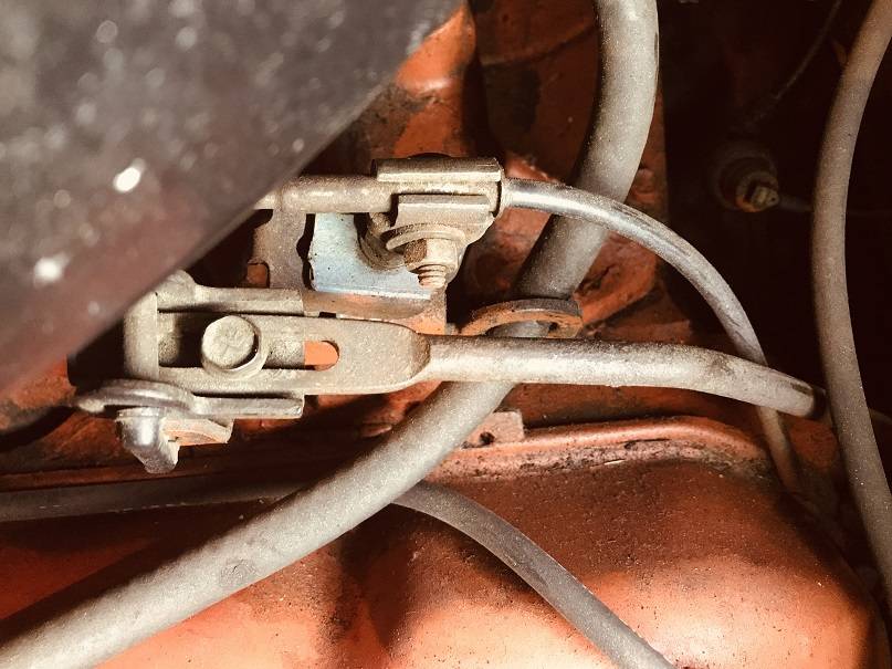

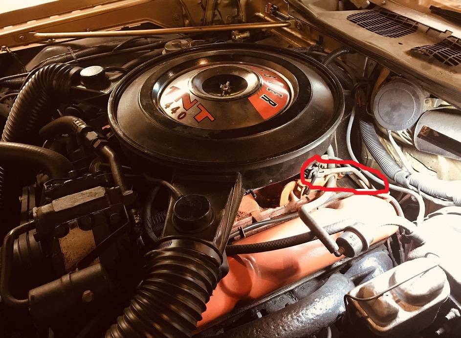

Anyone know what this is circled and what is does? (See pic). I thought it was the kickdown linkage but 413 says no. Thanks for everyones response. It really helps.

I'm pretty sure that IS the kick down linkage. It shifts it into "passing gear" (2nd), but only at WOT. Chrysler didn't have part-throttle kick-down until around '73. But, the older transmissions could be modified to have it. Depending on the adjustment of that lever, it also affects the shift pressure, so you get quicker shifts when the throttle is depressed more. I think most of us want quicker shifts all the time, but the general public wanted smooth imperceptible shifts at light throttle. These cars do stay in second when you're just tooling around town. They don't usually shift into third until you hit about 30 or 35. I'm not sure what the symptoms of out-of-adjustment bands are, but hopefully someone here can describe that.

1970 Chrysler service manual calls it “throttle pressure rod”. Look it up sometime. It tells the trans where your foot is on the gas pedal and it increases internal fluid pressures so it doesn’t toast the friction materials. Bit will still have soft shifts for grandma drivers.
manual valve bodies eliminate this linkage and fluid is max pressure at all times.
We car guys call it kickdown linkage. That’s what is it on a GM car, and thy have a vacuum modulator for throttle pressure sensing, amd the linkage kicks to passing gear. Not exactly how a 1970 TF operates.

Hopefully someone will correct me if I'm wrong but I think that not only is that your kickdown linkage it also looks to be waaaay out of adjustment. Shouldn't the other end of the slot in that linkage rest on the pin?
If its out of adjustment that would explain your symptoms of a missing third gear and not downshifting.

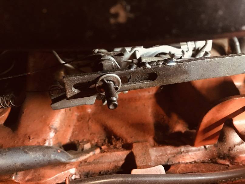

thehee - you made me remember that in 2005 I changed the Holley to a Thermoquad and I love it. Best carb I've ever had. I dialed it in 2005 and never touched it or had a problem with it since. I had to weld on a piece to the throttle pressure rod to lengthen it to work correctly which can't be seen from pic. I think I played around with this for a month before I thought I had it dialed in....but maybe not, maybe I never had it right. I'll look at it again. Thanks for everyone's help!

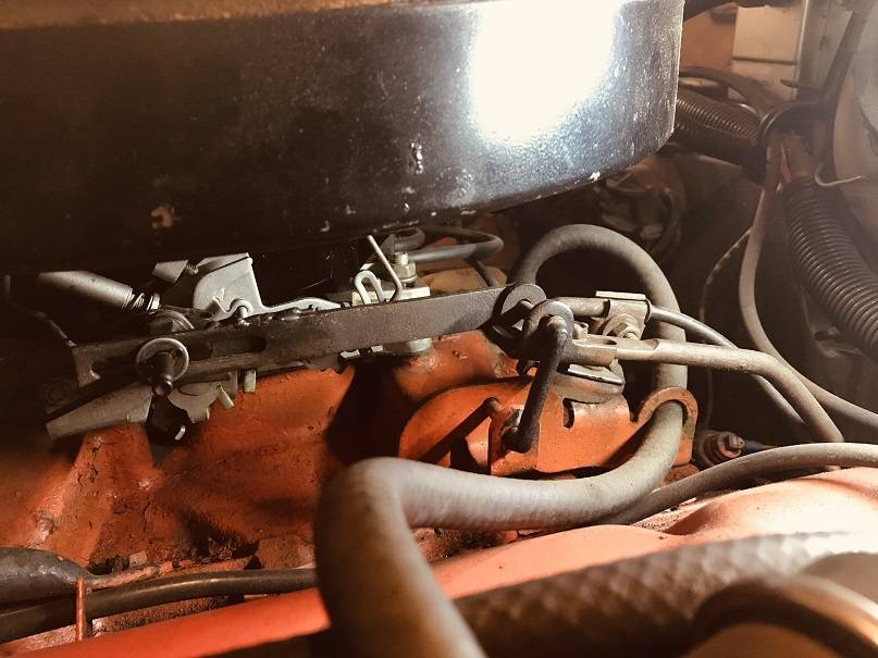

A detailed pic of the linkage with the air cleaner removed might provide some insight?

I measured the distance from the Holley before I took it off and mickey mouse welded the same distance for the Thermoquad. I remember I kept driving around and adjusting the rod bolt to the point where the rod wouldn't go back any further at WOT. So shouldn't I be experiencing early shifts (which never happens)? Only problem are late shifts from 2nd to 3rd and sometimes not downshifting at WOT. I'm guessing the throttle starts pushing back the rod around 1500 rpm. There are no adapter kits from Holley to Thermoquad linkage, are there?

You are getting late shifts because there is no spring pulling that linkage forward To the pin on the carb. Do that and it will shift earlier.

Finding the right spring tension took time but I do notice an improvement. (Too heavy a spring and it was pulling the idle up by itself). I've only driven it once since but 2nd the 3rd seems happy now. WOT doesn't hesitate, but I've only driven it once so maybe it'll give me grief in the future.
