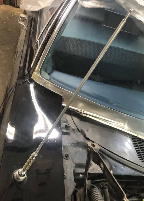

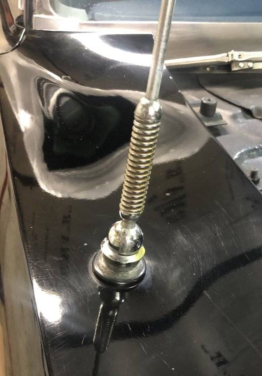

Is this the correct antenna for a 1970 Fury I with AM radio? It seems pretty elaborate and out of place to me. It’s a tad loose in the hole as well but I see no signs of damage to the paint surrounding it that would indicate it being messed with. Thanks in advance!
Nope. The factory had plain antennas.
That’s what I was thinking. And they were tougher than woodpecker lips too. Hard to figure why anyone would go to the trouble of putting this moonraker on here, but being that the radio was the only thing they optioned to buy, maybe reception was important to them.

This one pivots as well. I’m also thinking it would be a pain to change it so it’ll probably stay! Call it “period correct day two modification”. Lol

It’s ugly,but for now I’m going to leave it. Might add a ground plane kit to it later…
That definitely is a period-correct spring-mast aftermarket antenna. People who drove where there were lots of low-hanging branches tended to like those antennas as the normal masts would break off or get bent. That particular style of antenna fixed that.

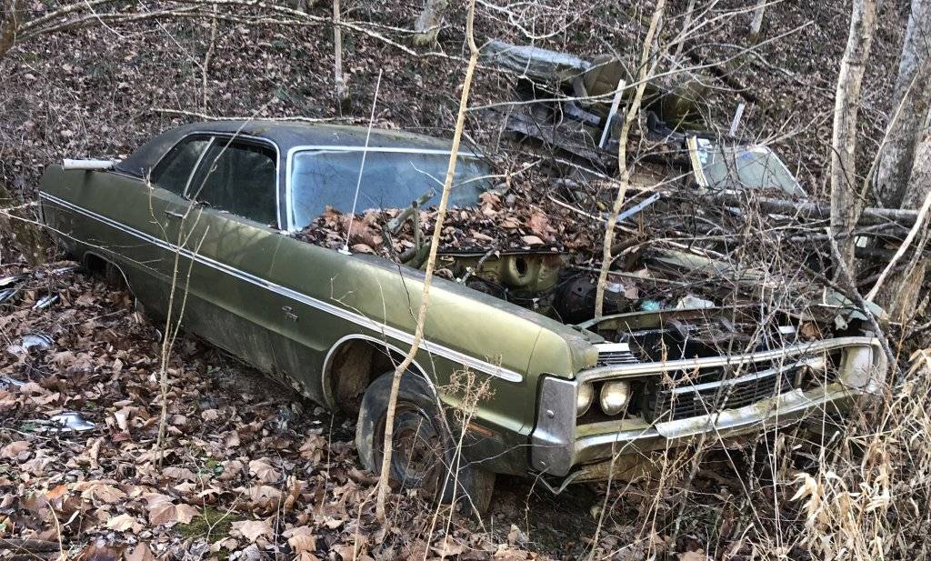

Well, this isn’t right either. Now it’s eating at me. I see Murray Park has one. Does anyone know how big of a job it is to change it? Can it be unplugged from the radio by reaching up from underneath? My car is non AC so that might help.

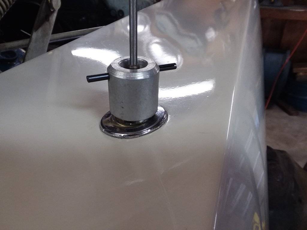

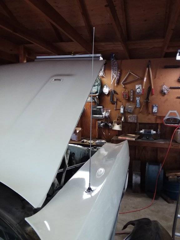

The telescoping antenna would bend or break really easily. The one piece stainless is the way to go. The thing is, you need the correct mounting bezel for the Fury, so the antenna will be vertical. Bezel is shaped to fit the fender contour.
There is an eBay seller with a repro telescoping kit for $95.
