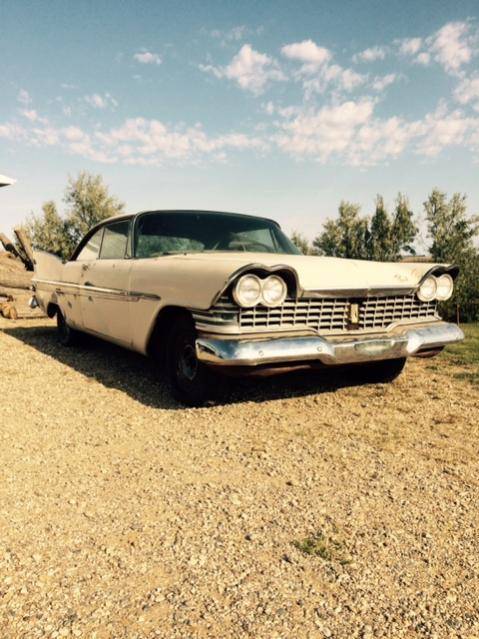

What a week! All company drivers got their walking notice with oil prices in the toilet. So what better thing to do than go car hunting. It was purchased by an older gentleman and was stored for 34 years (real barnfind) in a barn w concrete floor in southern ND. The daughter inherited it, but didn't want the car. Orig California black plate car Its the cleanest example of an unmolested 50's car I've ever found. Orig paint, upholstery, glass. inline flathead 6 w 3 spd manual. The engine now spins by hand, and I found most of the original interior in the trunk. Some minor pitting and small holes in the pass side of the trunk pan (where the mouse was). I couldn't be happier with this car. The 58 has now become a donor. And am wrapping up the 54 mechanics so it can go into storage and the 59 can be tucked away for winter.

Damn, what a great find, congratulations. How did you find it if you don't mind me asking?

Very kool, I'm excited for you!
Awesome! Are you gonna do a full/partial resto, or enjoy it as is? (Once it is running, of course). Very nice car!
I think I hate you....that car is awesome. you might want to pick up the new edition of Classic car Mag.
Nice find and dammit I wish I could get laid off for a while and go car hunting but she, the boss usually just jabs me in the ribs and tells me to go to work.

For now its just getting it mechanically sound, cleaning up the trunk, finding the missing parts, reassemble the interior, and enjoy as is. I've got enough scattered out cars to last awhile. Thanks everyone!

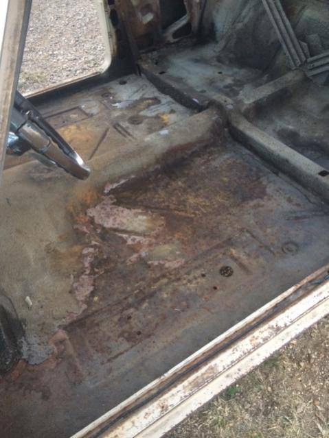

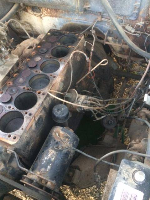

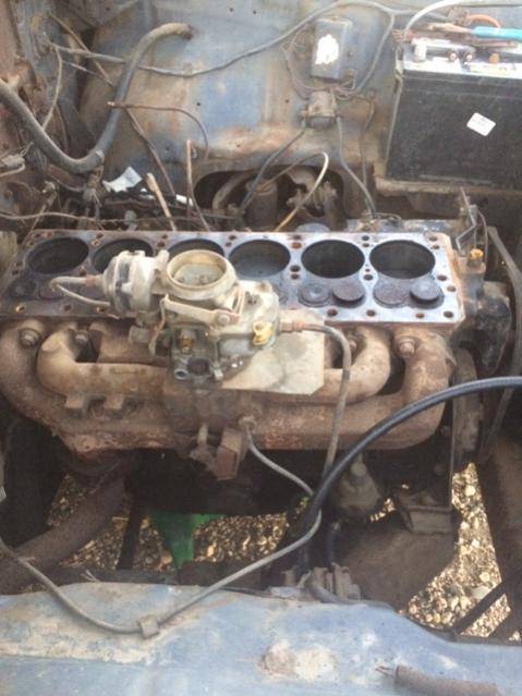

Pulled the front seat and cleaned up the floors, they look good. Got spark and fuel to the flathead, no fire, so I look at the odomenter and it shows 104,000 minimum. Compression at 20lbs, 25 lbs on the first 2 holes, so off comes the head not much ridge at all but the cylinder walls have a polished look. Everything moving as it should, so a bit of studying on what to do next. 1. rebuild the 6. or 2. or upgrade to a poly 318 from the 58. Lots of goodies for both engines these days.
