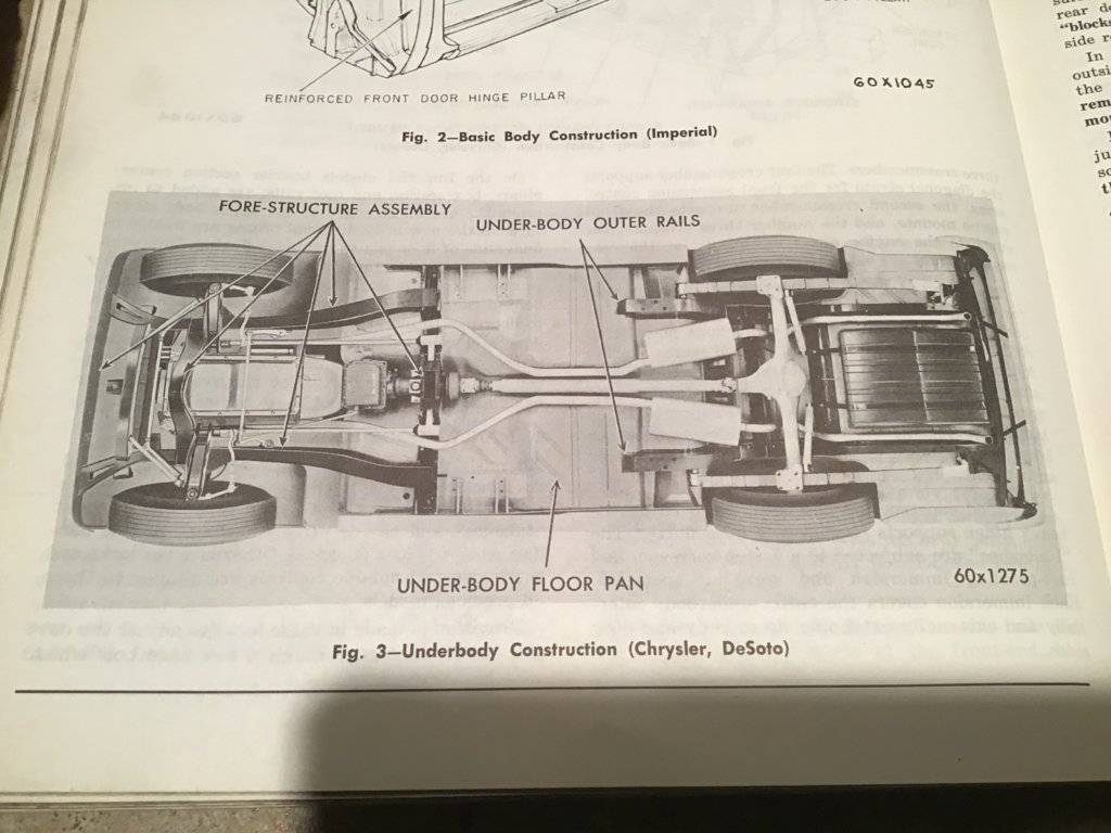

    The 1961 Chrysler has a bolt on front subframe. The body is a unibody. Get a service manual and you can see how they are built. No K frame.
    Last full frame Chrysler was 1959
    If your car doesn’t drive good and you need to “tighten up the ride”, then first step is find and fix the problem causing the looseness. These cars usually drive very well.

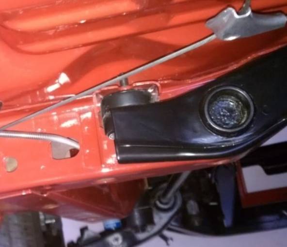

    There is an isolated torsion bar cross member on the 73 and up BBody's and 79-81 RBody's. They are not really called minipucks but they are called "torsion bar crossmember bushings".
  15. Kernel Sanders
    Kernel Sanders Member
    Messages:
    139
    Likes Received:
    31
    Joined:
    Mar 14, 2011
    Location:
    Ottawa, Canada
    Not my car but here is a pic of the crossmember (black) and you can see the back of the torsion bar in the socket and the end shows the rubber bushings to the body of the car

  19. 413
    413 Active Member
    Messages:
    372
    Likes Received:
    155
    Joined:
    Jan 28, 2019
    Location:
    NW USA
    We didn’t, they did. LOL. Whatever works I guess.
    Start with the basics on a 58 year old car, first get the suspension tight. There is a rubber bushing between the column and the steering box, has that been checked? It can make it loose.
    Basics first, then get fancy.
