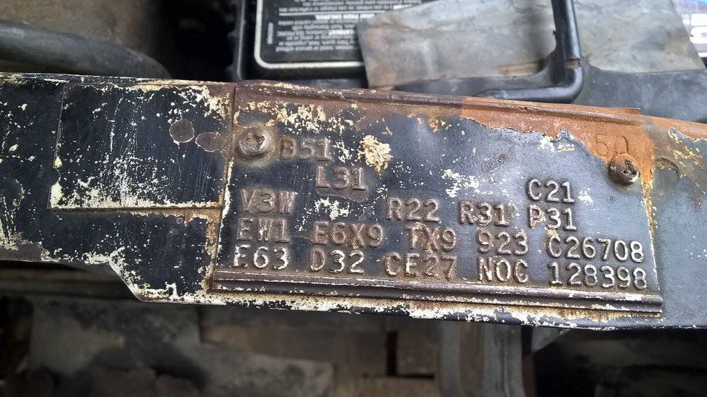

Here you go G!
CE23:
Chrysler
Economy
2 Door Hardtop
N0C: 383 330HP OR 335HP 1-4BBL 8 CYL
1970
Jefferson Avenue, MI, USA
: Sequence number
E63: 383 cid 4 barrel V8 H.P. 335hp
D32: Heavy Duty Automatic Transmission
FW1: White Exterior Color
E6X9: Trim - Unknown, Vinyl Bucket Seats, Black
TX9: Black Int. Door Frames
923: Build Date: September 23
: Order number
V3W: White Convertible Top
R22: AM Radio with 8 Track (10 Watts)
R31: Rear Seat Speaker(s)
L31: Hood/Fender Mounted Turn Signals
C21: Center Front Seat Cushion
P31: Power Windows
B51: Power Brakes
50: Unknown

There you go, and that's what I was wondering about. You pulled an HP 383 from your '70 Newport to put a (everybody has one) 440 in it. The majority of Newports in '70 were "L" cars, 383 2 bbl. There were some that left the factory with a "T" or a "U" - standard 440 and 440 HP, or "TNT" in Chrysler speak. The rarest were the "N" cars, 383 HPs. You have one. I was really hoping it was an L.
