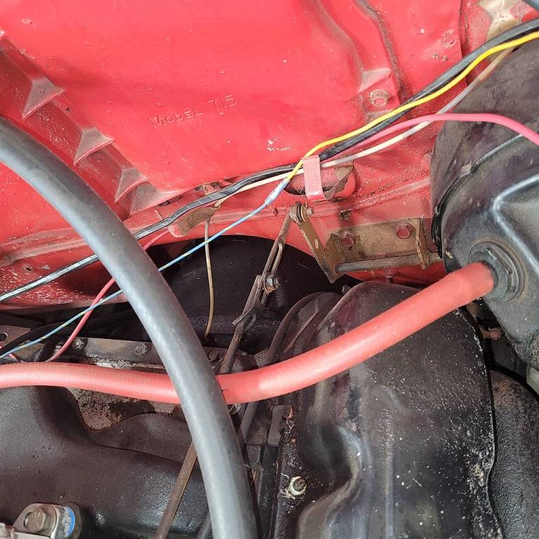

Here are photos, good thing the master cyl is off. Hard to see, but it has a bellcrank on the bellhousing and that hooks to the rod going up to the firewall bellcrank.
Who in the world designed this mess? This is a nice survivor 62 300 so I’d bet it’s original.
Here's a picture of what I have. The linkage going to the trans is gone, Hope you can help me identify and help find one.
Thanks,
Glenn
Glenn we need to see below that. In my picture that tan color thing on the left is the exhaust manifold. The brake booster is above where the photo is taken. You will need to shine a might down in there to see what is there.
we see you throttle linkage which is the stock stuff so that’s good.
