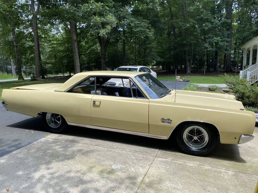

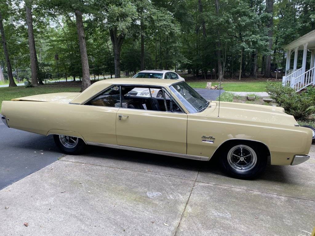

My thoughts are that both of those tire sizes are to short. My recall is that the factory equipment tire was around 27.5” tall and if you look up the diameter of those tires you will see the difference. You need to look up the recommended wheel width for the tires you select as an 8” wide wheel might be an issue. Here’s my ‘68 Sport Fury with 235/70-15’s on 15 x 7” wheels.
View attachment 621501View attachment 621502
Nice car, I like that one.
It's my impression that the bias tires sat taller when loaded vs today's radials, so oversizing for a radial tire is probably needed to maintain the correct speedo reading. Regarding rotations per mile when seeing those specs on tirerack, to me it's unknow if that is a loaded measurement (from the manufacturer) or if that's just straight math from the tiresize.
245/60 15 are too short. They look small in the openings and have a much harsher ride than the 235/70 which are also virtually identical in diameter as original. keeping your speedo accurate. I speak from experience with these two sizes.
That's a great illustration, thank you. My speedo is not correct, I switched to 3.91 gears and knew I was also changing tire radius. I will wait to address that issue once all that is dialed in, and swap out the speedo gear when its all behind me.
