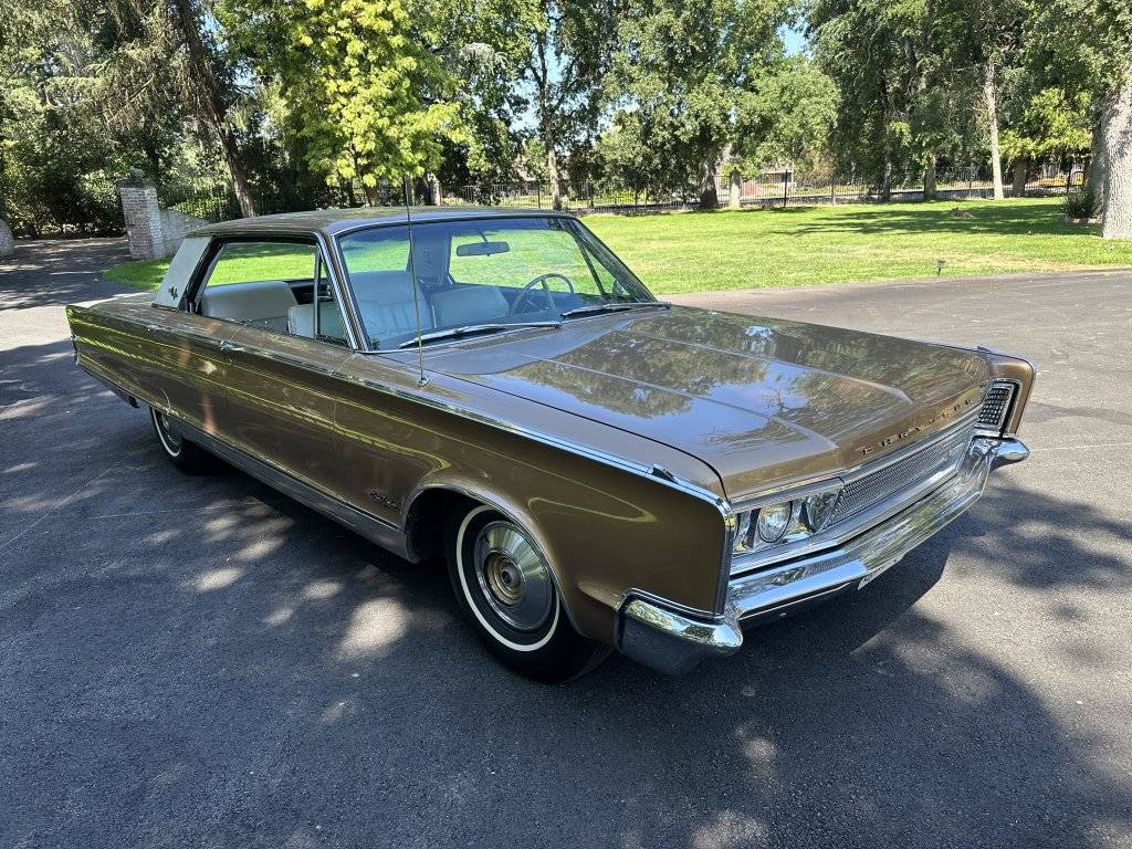

New tires and wheels for my 66 New Yorker

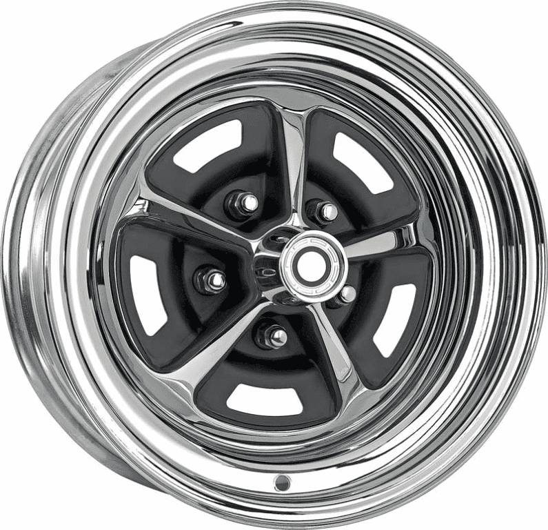

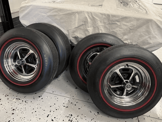

Well, while I like the "modernized" version of the Magnum 500, I must say I prefer the original with Mopar centres...
Like this:
However, it's your car and your taste, and there's absolutely no one who will make a better choice for your car than you.

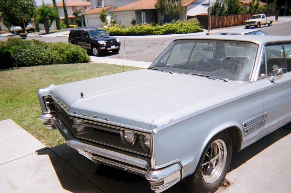

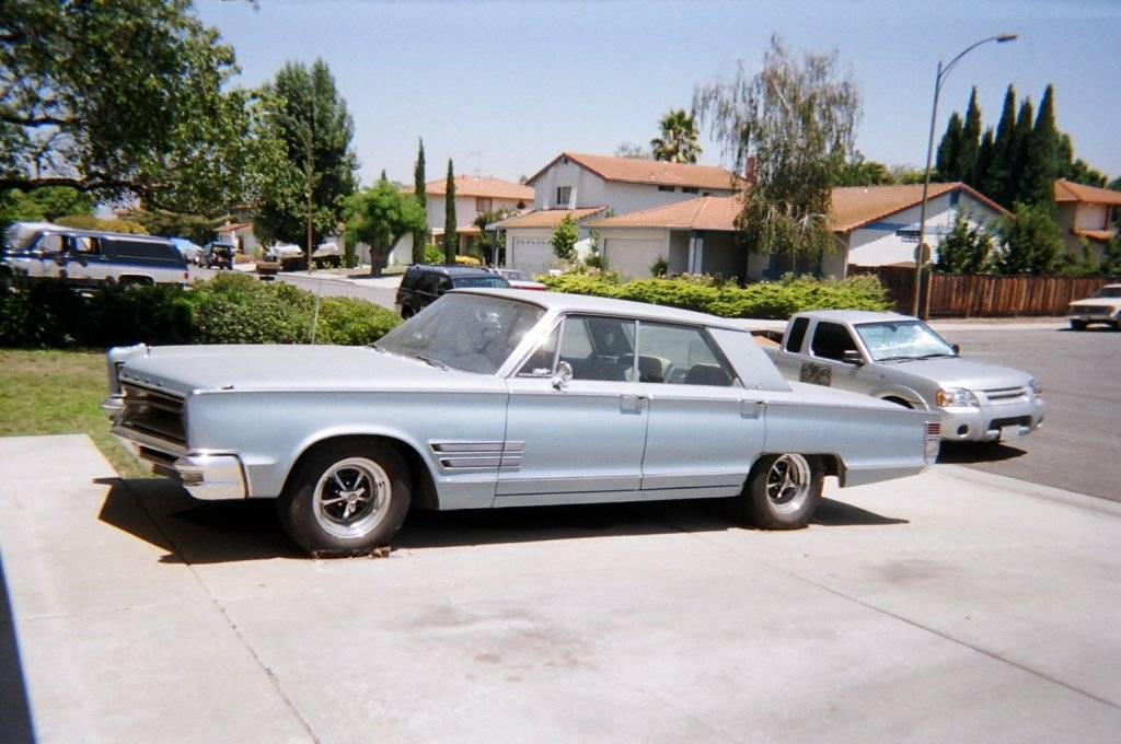

The Magnum rims would look great on your car. The raised white letter tires look good on the newer ( 70 and up models ) but on yours I would do either the red or white stripes.
The 66 440 Newport's I've owned liked 225/70-15 Michelin the best. The 235/75 gave up to much power for the stock rear gear. The 383's liked the 205/70-15 Uniroyal's.
Most of the wheels that were not hub centric had to be balanced on the car, each and every time the tires were rotated.
The 235/75-15 Nexens aren't the best riding tire. Polyester, steel and nylon tread.
Yes, get white wall.

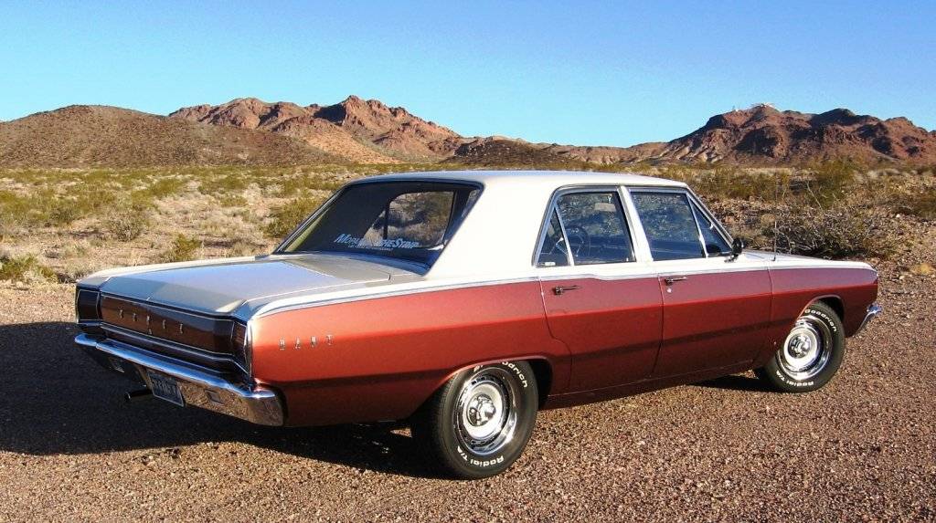

Thats how my 70 Charger came . I always thought they looked better than Rallye wheels.

Thanks everyone for all the help and advice. All of the photos you guys posted on this thread are amazing making my decision even more difficult.
Here is the wheel that I selected. It is the Legendary Magnums 15x7 with 4-1/4" backspace. I'm going to go with 225/75r15's with the white stripe. Do any of you see any issues with this size configuration? If not, I'll be pulling the trigger today.
My experience with the 66 C is that the car will definitely like that size tire.
There is a lot of reading to be done on what make and construction tire will ride the best with the least amount of noise and still stop good in the rain.
Personally I don't think the C likes a 50 psi tire with nylon in it.
And, a 50-psi max tire (Nexen) is rated to handle "less" load "at" 30 psi than a 44 or 35-psi max tire is.
Give me a polyester steel tire on a good C sedan and I'm happy as a clam.
Are those nice wheels hub centric?
Tires are steel belted radials. Vercelli Tires Classic 787 Passenger All Season Tire Passenger Tire Size 225\/75R15 - Performance Plus Tire
I believe the wheels are Lug Centric however they advertise that they are hub centric ring compatible.

The hub centric ring compatible part is very important. I'm having good success with that on C cars using old mags from the 70's. Slots, center lines, that kind of old wheel.
