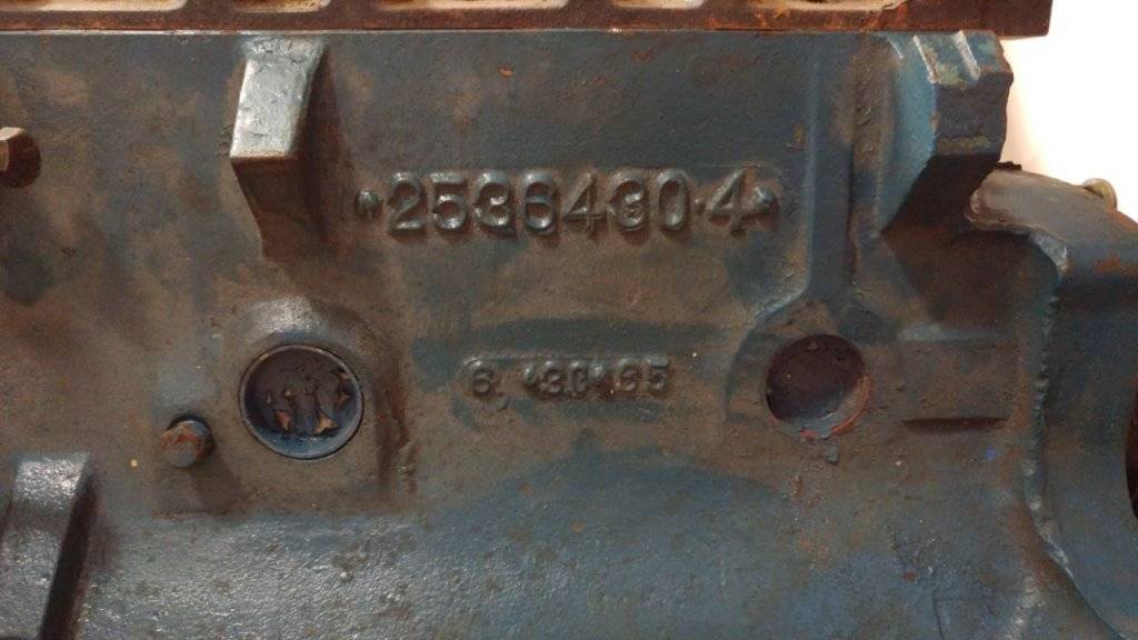

Here's the pics I got from the guy. Has a 65 date on it and the casting looks correct according to the 440source charts.
it will work fine , it a standard 440 block , need to lower the c/r although .that 10? is based on closed chamber heads , with some thick head gaskets and later big cc chambered heads . should drop the c/r enough . great block for a driver .
The first 440s were cast in 65 for the 66 model year. There is an engine ID pad just behind the water pump housing, on the left side of the block with the engine size stamped on it. (you will probably have to sand off the paint.)
There is a letter in front of the "440". Yours should be a "B". B440=1966. C440 is 67, D440 is 68, E 440 is 69, F440 is 70, g440 is 71 and H440 is 72. After that there were a lot of "T440s" and other stuff, but the steel crank 440s went from 66 to 72. Some OTHER facts that haven't been covered here: Although the 66 and 67 motors had higher compression, 66 and MOST 67 440's had smaller exhaust valves which affected performance. It was a 1.60 exhaust. ON a few very rare 67 HP 440s, they put the 1.74 exhaust valves. In 68 with the 906 head, the engine got the 1.74 exhaust valve but a slightly lower compression (somewhere in the 9.5-1 range). The 906 head was also used on many 383s. (possibly on your 68 383) so you MAY want to pull and redo them to put on the 66 440 for the bigger valves and give up the slight compression difference. If you want to spend a lot of money, the 66-67 heads can be machined out for the 1.74 exhaust valve..
