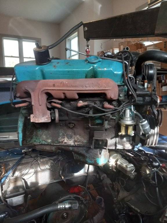

I have a '71 Imperial with an engine leaking oil...
keep the block heaters, great for cold weather 40F starts
remove an accessible freeze plug and see how corroded it looks, evaluate
there are freeze plugs in the heads
replacing the oil pump is a waste of money unless the rotors are chewed up
pull the oil pan, install a windage tray
Use a valley pan with NO crossover, do not listen to the bad advice, the car needs to be tuned for today not yesterday 1970 whatever.
Timing chain and gears
Flowcooler water pump 195 degree thermostat
new engine biscuits try to find nos
valve seals,
pull the heads? no use a bore-scope and look! probably not, a properly tuned engine will not eat the valve seats even on todays fuel. don't look for trouble
change oil sending unit use nos

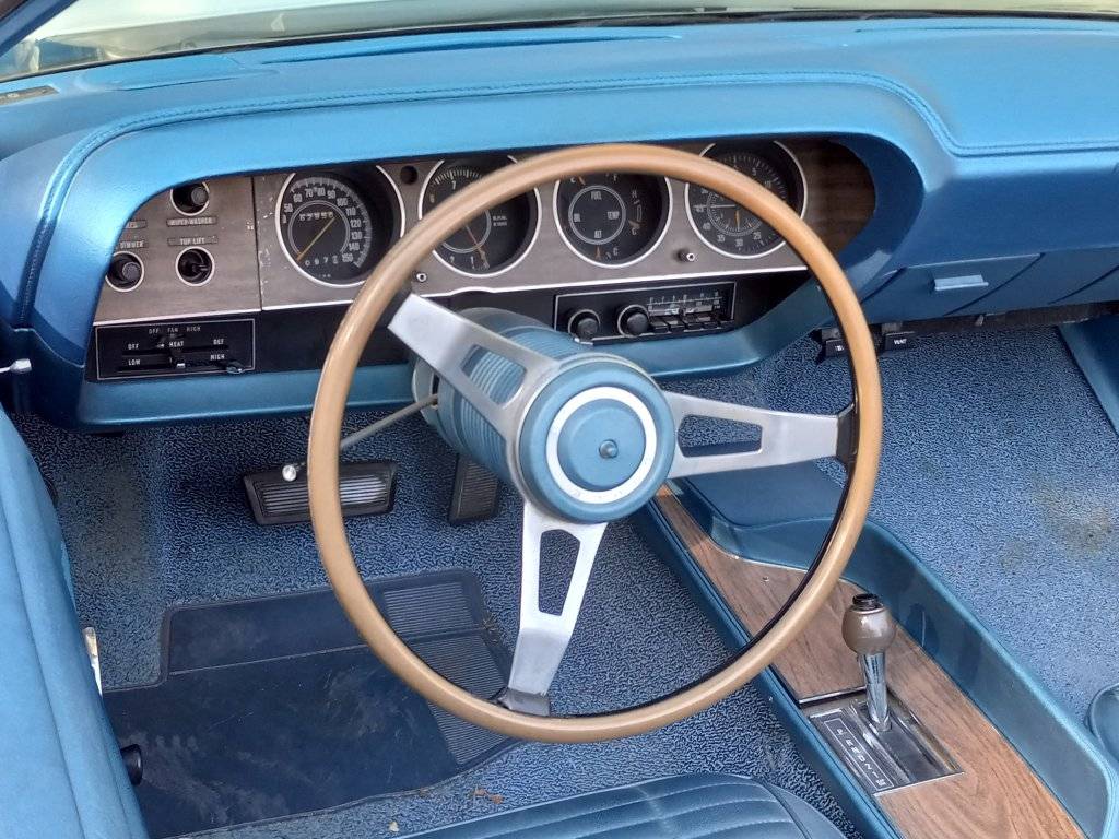

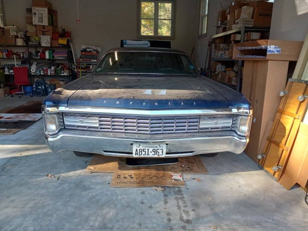

@hootothecore -- would love to see more photos of your car, and hear about its history. The 1971 Imperials are great cars, and we don't see /hear about them often enough.

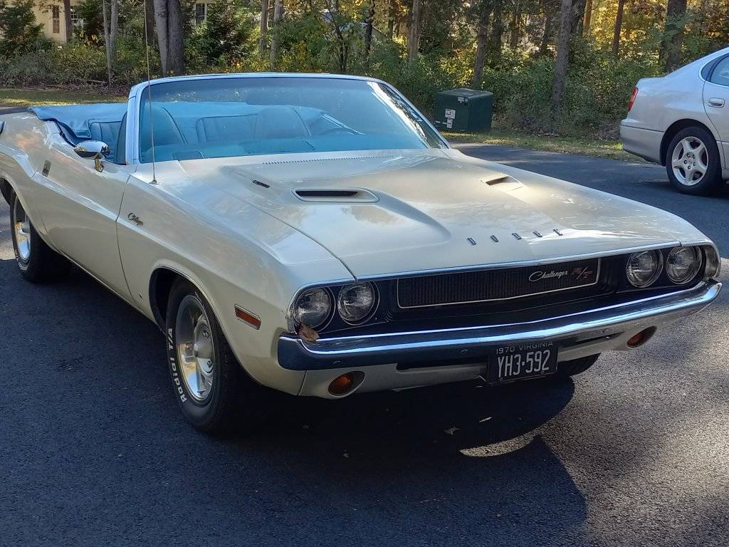

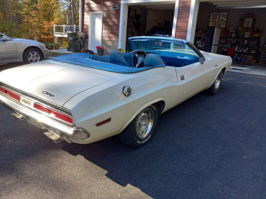

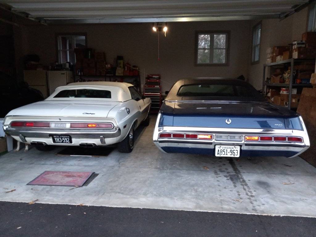

PS: I would not mind seeing pics of your 1970 Challenger 'vert either :)
A couple of pictures...
Thanks for the intake gasket p/n. Regarding freeze plugs. This car had block heater plugs. I'm not sure I want to remove that option even though I've removed (and kept) the plug-in cable.

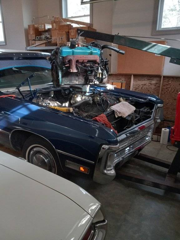

I suspect the oil sender as the main leak, but it has made a mess, so engine out for cleanup.
Also, if I pull the heads, should I have hardened exhaust valve seats installed?
Imperial with a Vanishing Point Challenger. Woo Hoo.
If you pull the fuel pump, make sure the push rod goes back in the same way you removed it. Is the new fuel pump working now, if not it might be pump push rod.
Valve covers are notorious leakers. Now you have me thinking to pull my Engine, I have a pair of heads being rebuild now and was just going to do that along with chain, pan, rear main seal. Etc....
More pics...
How are the freeze plug heaters held in place and do they have a o-ring on them to make the seal?
100% change those freeze plugs !! they cost next to nothing but can ruin your day when they fail. As 413 mentioned, with the engine in the car it´s almost impossible to get to all of them.
Including the freeze plugs in the heads. The ones at the back of the heads are extremely difficult or near impossible to replace with the engine installed.
Ok, follow up to this thread. I've decided to do a full tear down and rebuild of the engine. I have pulled the heads and rotating assembly from the block. I will have a machine shop clean the block, hone the cylinders, new cam bearings, and freeze plugs. The heads will be cleaned and freeze plugs replaced.
I will do new piston rings as I have a set of standard sized rings.
Since this is a low mileage engine, I don't feel the need to machine valve seats, do any cam work or crank work. Now, can I replace bearings without doing any machine work to the crank? Since I've gone this far, I plan to replace all bearings. I just don't know if the crank has to be machined/polished when going with standard sized bearings. I can have the main and rod journals checked for roundness. There is no obvious wear and the bearings looked fine.
Any opinions on reusing the rod and main bearings? My plan is to replace, but just want some opinions.
Wow, that’s a snowball you got rolling there. You could honestly clean and reassemble as long as it all checks out. I would replace all of the bearings since they’re pretty cheap. I would make certain the rods and mains are standard though, and not .001 undersize or something from the factory. Be aware that the middle cam bearing often ends up tight where the cam won’t go back in, have your machine shop verify its size after install since they have the tools to correct it easily. I would 100% replace the timing set, and all freeze plugs. I would check the exhaust seats, they can get pounded out of shape and not seal well. It’s easy to check since you’re this far in. I would also reuse the oil pump if it looks good (I would bet money it’s perfect).

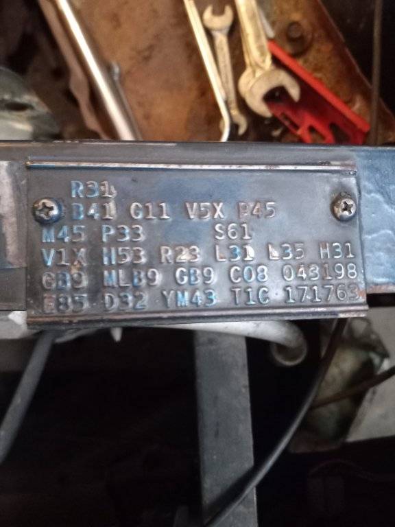

@hootothecore -- would love to see the fender tag of your Imperial.

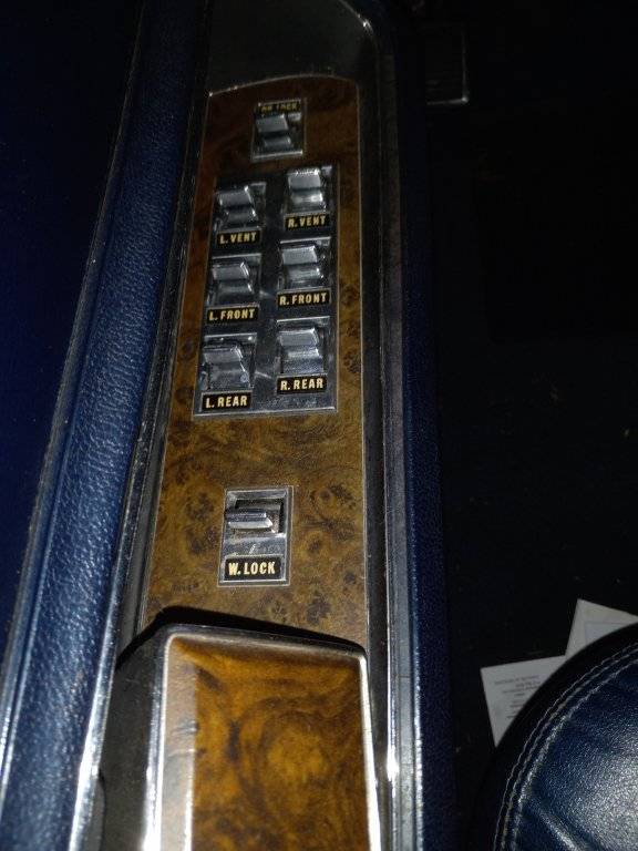

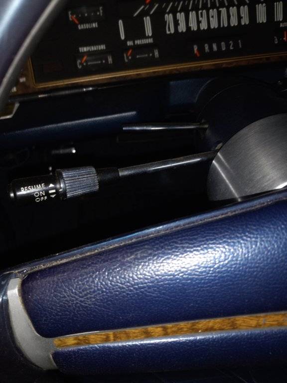

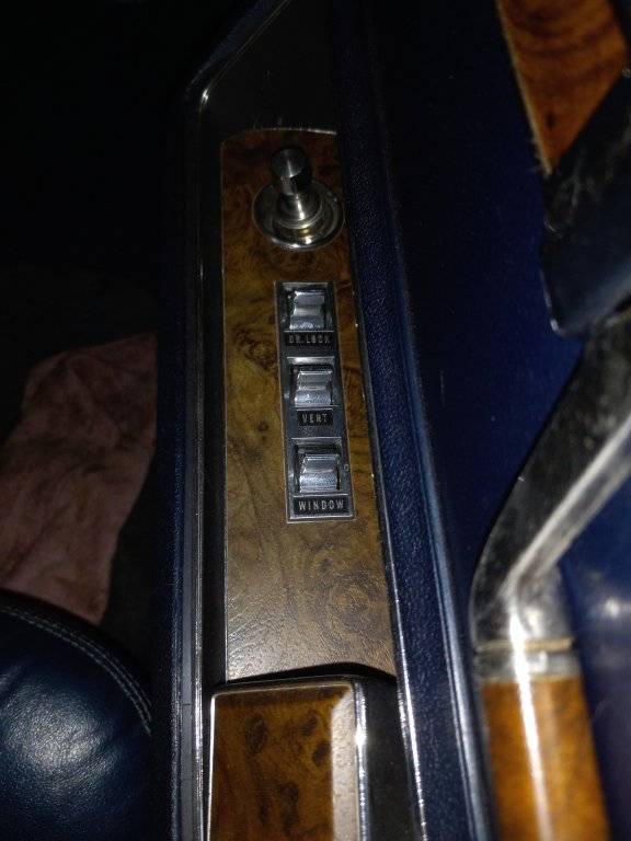

I added cruise control and power door locks. Funny thing about the cruise, when I went to install the brake switch I found a factory cruise harness stuffed up under the dash with firewall grommet and all wires and connectors.

Thank you for posting the tag. YM43T1C171763 is a beauty. Love the GB9 on this car.
