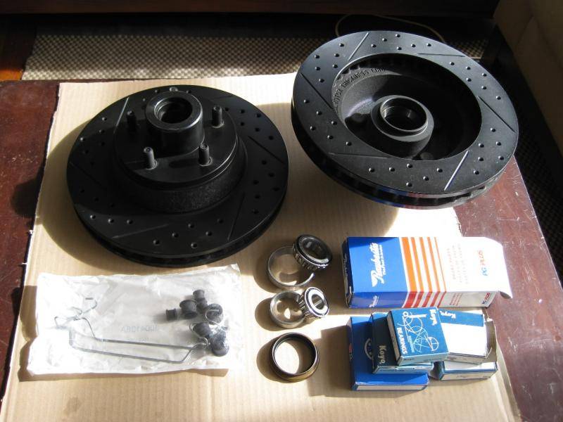

Centric make the standard factory style replacements and can be got through Rock Auto, etc. I bought a set of drilled and slotted rotors for my 70 off eBay. Can't remember the name, but I believe they take the Centric unit, then drill, slot and powder coat then and box them up. Quality items I have had many miles of driving with.

The purpose of the slots and holes is to allow the gasses produced by the brake pad, as it works, to better escape rather than stay there. It's supposed to be "the gas layer" that causes brake fade, so getting rid of the gasses is supposed to help. BUT unless you're trying to hold down the speed of the car (and trailer) down a long descent, OR are into heavy road racing, these things can be more "show" than go, in reality.

That said, nice write up.:thumbsup: The above "drilled and slotted" are pure "visual horsepower"... for the rotors to really get any improvements from that treatment they would have the strengthening ribs in the center cast in a spiral shape so they pump air. That would also make them directional, so the cheap "look at me" versions like above only look like they do something. An easy way to spot these in common practice is to make the non-directional rotors look correct on the left side and backwards on the right.
Form my personal experiences most factory setups were also appearance only, the exceptions being sporting models which have a left/right rotor availability.
The Brembo link has a video... note the straight ribs are not actually straight and the drill pattern is to work with left or right pumping... but you would not ever want to spend the $$ for these rotors even if they were available for a C Body.
