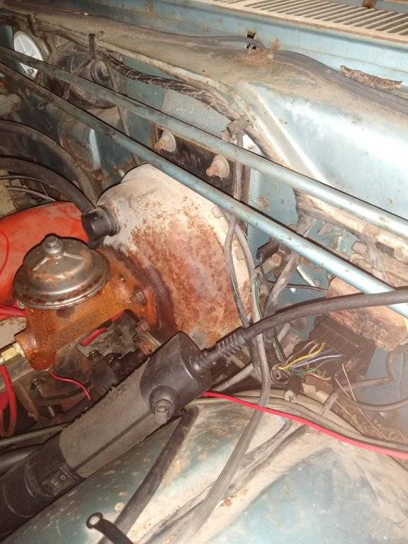

on my 67 300 i seem to be loosing brake fluid in the rear chamber over a few weeks. I keep topping it off but Idont see where I am loosing fluid from. After filling this time i saw some on the master cylinder itself, but I think that was from possible over filling. Where else could I be loosing fluid? Ive traced the lines and see no fluid loss anywhere. It does have a SBS disc brake upgrade on the front.
Yup, if the lines and wheels are dry, probably the seal in the back of the mc itself

If someone has changed the booster/master cylinder, we aren't going to know what's there.
Some of the kits use a generic GM style MC and booster. Some people use the newer Mopar MC. Some even leave the old drum brake stuff in place.

looks like the bendix version...same as mine...took forever to find one..and even then it was reman...CENTRIC 16080025 was the number...it can be rebuilt though.

Pulling the master cylinder only takes a few minutes and you barely get your hands dirty. If it is leaking out the back, it will be pretty obvious.
If it is leaking I'd pull the booster and spritz a can of brake cleaner into it to flush out any brake fluid that might be in it and see how it works after replacing the MC. I had the same problem and the booster was ok after replacing the MC.
