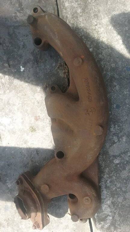

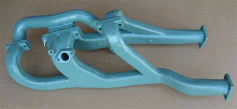

you can see what they had to do with max headers to make them flow not even close looking to the HP manifold.
if i had a choice on stock manifolds i would go with the 1963 300 J exhaust more down under than sticking up. like to see what they flow. is there any testing on those ?

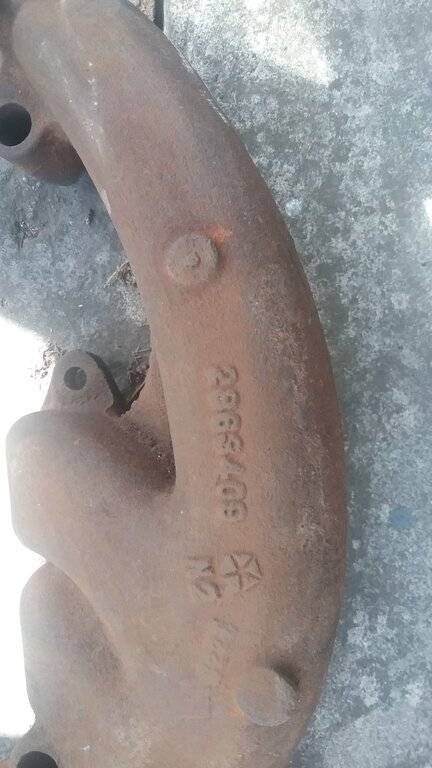

Pretty cool looking. Are 63 and 64 max wedge manifolds the same?
What are the ports for? To heat up max wedge long Ram intake manifolds?
