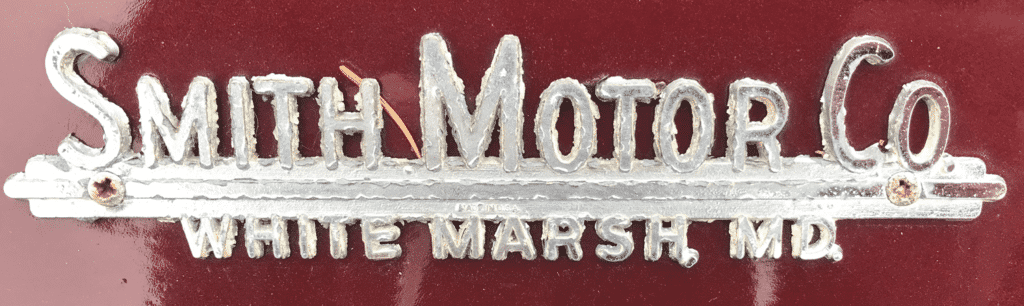

I have three trim pieces that I'd love to see re-popped for Medina, my '71 Monaco.
1: the badge that the dealer screwed into her trunk lid. The pot metal is not in great shape and may well disintegrate by the time when I have the car repainted (likely in Spring 2021) or at the time of the paint job. It's part of the car's history, so I'd like to save it if possible. FWIW, member @hergfest owns a '64 Polara 500 'vert sporting the same badge.

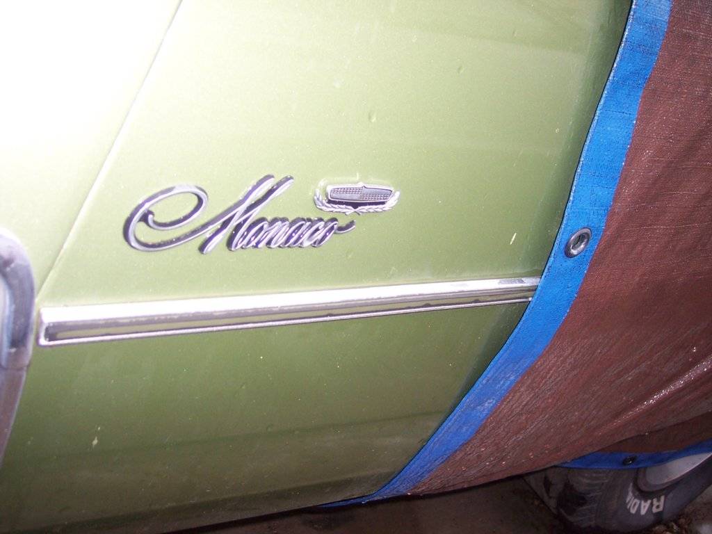

2: the fender crest and wreath that missing on each side of Medina's rear fenders. They are seen below in a photo of a similar '71 Monaco owned by @saforwardlook. Thanks to @Bill Watson, I have learned that the part number for the medallion is 3568596 (neither of us could find anything about the laurel wreath). In my experience, originals are very hard to find. Luckily, over Christmas, I got original spares thanks to @71Polara383 -- but he tells me that they are fragile glued-on pieces (and prone to breaking in the removal/installation process). Accordingly, until I have Medina repainted, I'd like to get repops that Wyatt and I could install and that I would not be afraid of breaking.
@BLUPORT and @Zymurgy -- what say you? I would be fine with 3-D plastic pieces that I could then paint in the right metallic paint finish, or that are "metallized" in some other way as per @Big_John's suggestion.

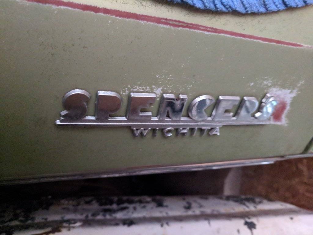

I love my dealer emblem on my Monaco, it's led me to a search to find any info from the dealer, which has turned into a pain in the ***! Closed long ago, no pictures that I've found with any signage, but I got a matchbook cover. It will go back on the car when it gets restored. The emblem is way better than any runner titty on a '73 Imperial. (I'd keep those too)

Lost wax casting using brass.
The downside is the new emblem will be just a little smaller than the original due to metal shrinkage. If the right brass is used, you don't have to copper plate before the nickel and chrome layers.
With that dealer emblem, I would be tempted to try to repair it with epoxy filler (like Milliput) and either cast a new one in plastic or even just bolt the repaired one back on. Some good "chrome" type spray paint won't really look like chrome, but it will look like the crappy plating the original emblem once had. That's just a thought.

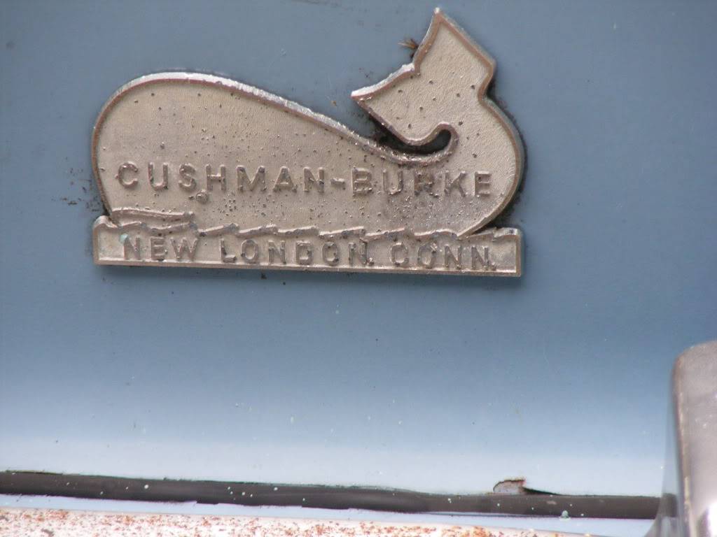

I always thought this dealer emblem that was on the back of my '53 was pretty cool.
