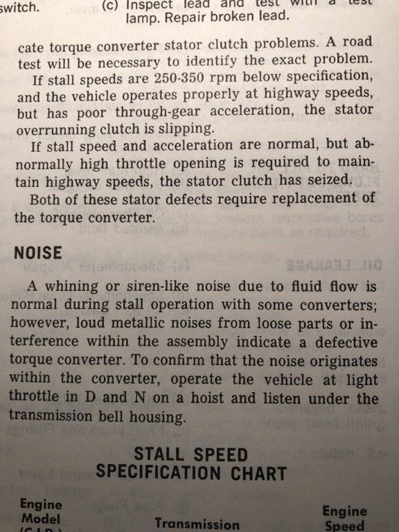

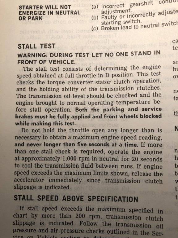

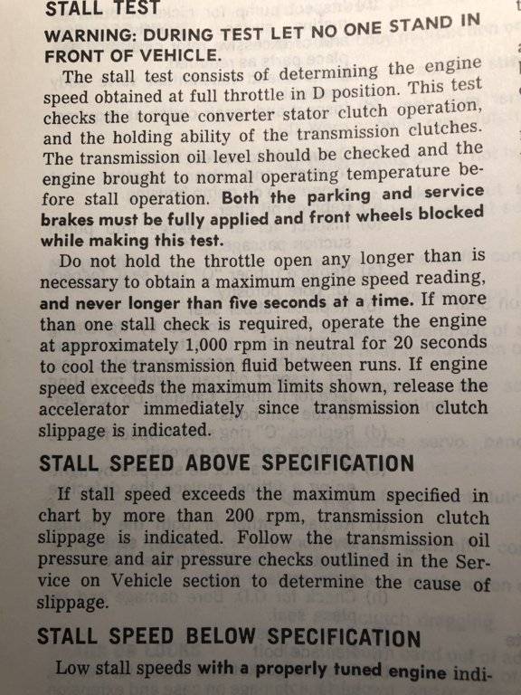

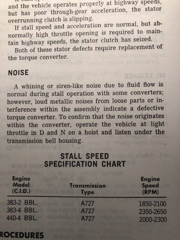

No, that is not what is meant by "stall" when referring to auto transmissions. When your engine is "stalling out" or perhaps just hesitating when you apply throttle, that is (typically) a fuel or ignition issue and has absolutely nothing to do with the transmission.
What is meant by "stall speed" is the RPM that the torque converter limits the engine to when you hold the brakes and rev the engine when it is in gear (Drive or 1st). With a stock 440 in a C-body, this is generally around 2200 revs, give or take 200. With a higher power output (meaning its torque rating) engine like a Hemi, that number might be 2800 RPM. If a 360 or a 383 2 bbl is in front of the torque converter, the stall speed might be only 1900.
In general, the diameter of the converter determines the stall speed with a given engine. [The internal design of the fins is also very important, but for our purposes that applies to highly engineered aftermarket race converters, not OEM units.] The smaller the diameter the higher the stall speed (again, for a given engine). Think of it that the larger diameter converter has more "muscle" to hold back the engine RPM against the torque being generated. Our converters are either 11 3/4 or 10 3/4 inch, depending on your engine, with the 440 performance engines having the 10 3/4 unit for a higher stall speed and thus better "off the line" performance (by allowing more revs for the hotter cam's torque curve, yada yada). Do you want to really feel a kick when you let off the brakes? Install an aftermarket 9 inch converter that will allow a stock engine to rev to 4000+ RPM against the brakes. Release brakes.....away you go with the engine making maximum torque. Nice.
But you still need the correct amount of trans fluid!!! :p
Here's the full story from the FSM. Please note that these stall numbers assume a properly tuned engine (see bottom line of first picture) that is capable of making its full power. If your engine is a stumbling, stalling, pinging piece of crappola, the stall speed against the brakes will be low. If your engine is an aftermarket 540 inch torque monster , it'll probably spin that converter to 3800 before it breaks it.
Also: If you're thinking that commando might be right but you don't want to do the "in Drive" thing, simply carefully fill right-up-to-and-just-including the FULL line. That'll split the diff and you'll be just fine.
Also, also: Please, please never use the word "stahl" when discussing torque converters. You see this all the time on the Interweb either because the writer is illiterate and/or is confusing the whole issue with exhaust headers made by the great drag racer Jere Stahl. For that matter, I can recall opening up Autotrader and other rags in the 70s where guys were using "stahl" when discussing an aftermarket "high stall" converter, so apparently there were dumbasses before the 'web.....
