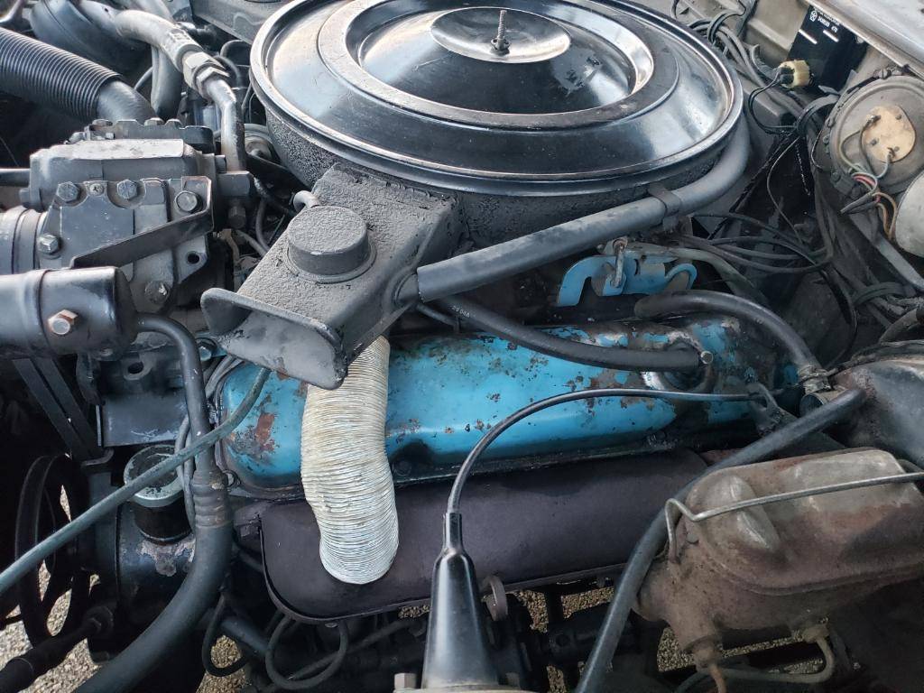

Ran out of photo space in the previous post, so I've attached here a photo of the engine bay with the heat riser back in place after replacing to valve cover gaskets. The bolt holding the riser to the manifold is broken, but the riser is in place and does not shimmy/rattle. Yeah!

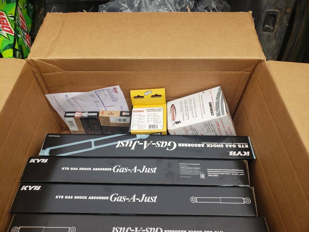

I like to buy locally if possible but O'Reilly, whose Rockford stores have provided great service to Wyatt and me, did not carry what I wanted. I therefore bought from Summit--with which I've had good experience before--the fronts (KG4507, $30.45 each) and the rears (KG5512, $34.98 each). Tax is on top, but shipping is free for orders over $99.

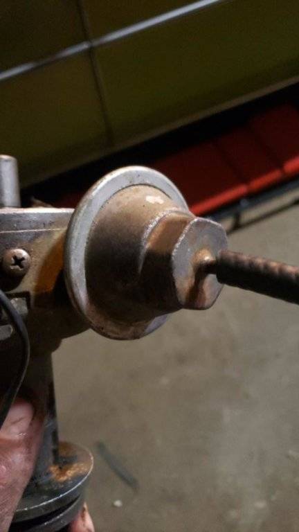

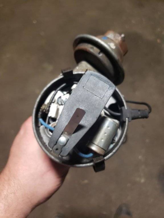

Prior to Volo, @71Polara383 had diagnosed that the one which was on Medina when I had bought her was clearly leaking (specifically, the vacuum advance pot was not holding). We suspected that could help explain some vibrations and poor part-throttle response (full throttle was very good).
Looking at the old dizzy, it was missing the tag with its parts number and manufacturing date. I've included two photos at the bottom of this post for records. They show that it was not the original one, rather it was a Chrysler performance part at some point in its life. The area where the tag would be is behind the screw in the second pic.
