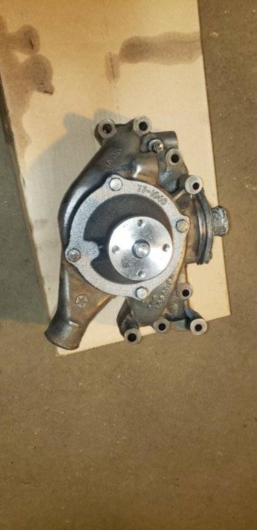

1. For the cooling system:

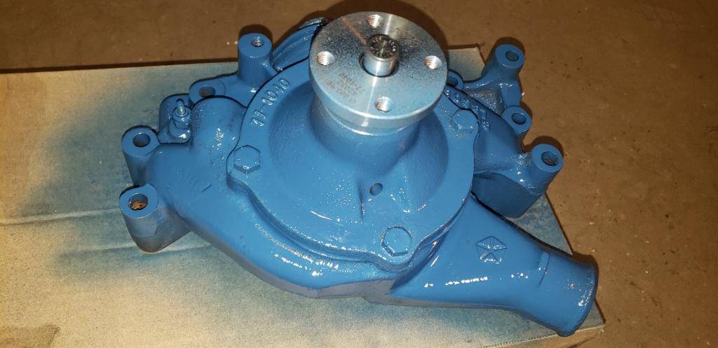

a. we replaced the water pump and radiator hoses. Following @saforwardlook's recommendation, I went for a Gates 42032 pump, 20630 molded upper hose, and 20663 molded lower hose -- all carried by Rock Auto. For good measure, we also replaced the thermostat and its gasket, buying from Summit a Stant 45478 T-stat and a Stant 27140 gasket. Attached are pictures of the water pump housing, after Wyatt cleaned it up and after he repainted it. The paint was billed as "Mopar blue" but I don't see the color as a perfect match -- no worries, it is well hidden.

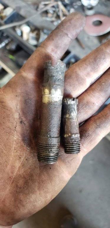

b. Wyatt changed the heater hose nipples as well (I found new ones at Mancini Racing), after I had acquired the proper tool from an eBay vendor that make it much easier to change the nipples connecting the hoses. The tools are not cheap ($50) but well worth the time savings and they can be re-used for work on future cars. Attached is a photo of the old nipples after removal.

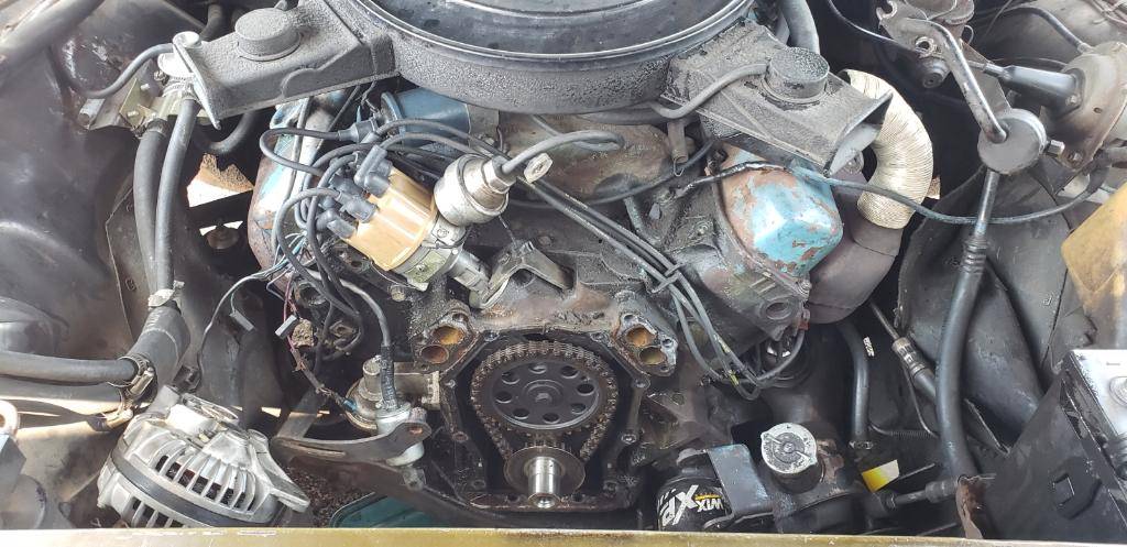

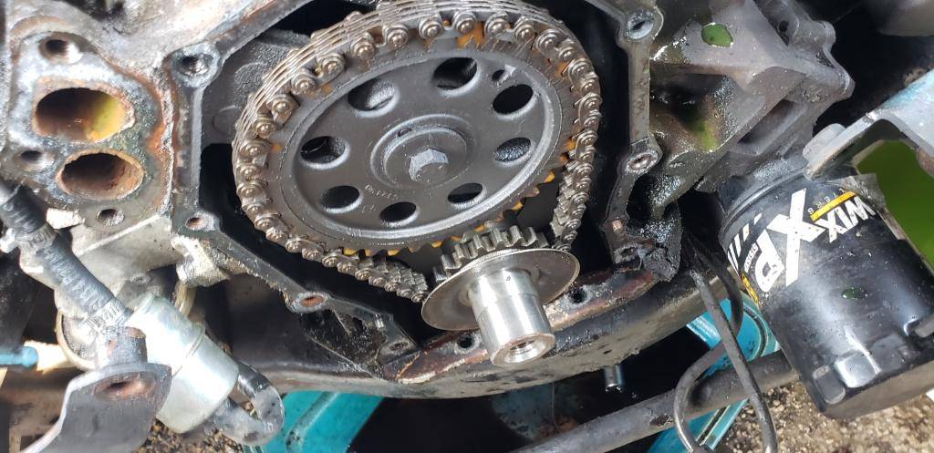

c. while he was at it, Wyatt replaced the timing chain and sprockets. The original sprockets still looked to be in amazingly good condition, but why risk it? The new heavy-duty set should last for longer than I won the car as I got (all from Summit) a Cloyes C-3044 timing chain and gear set (double rollers), Fel-Pro TCS124602 timing gasket kit. Here are two photos after installation.

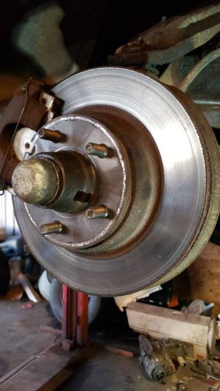

a. the rotors were still fine (photo below), ditto for the drums. Hence, our initial thought was to just replace the hoses, the pads, and the fluid. I bought pads (NAPA Proformer D39-781) / hydraulic hoses (Raybestos BH35017 front from Summit Racing, Raybestos BH36651 rear center from Rock Auto) / fluid (Lucas Oil 10826-1, from Summit). It is amazing to me that different vendors will not carry the full line of Raybestos products, but mix and matches here and there.

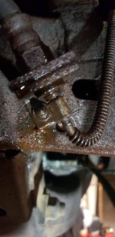

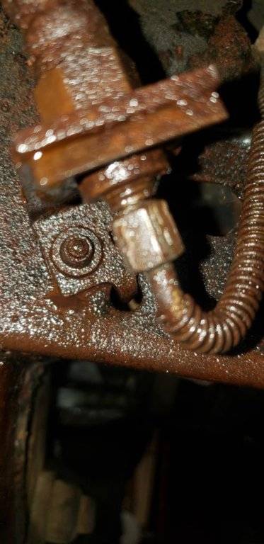

b. as Wyatt started replacing the hoses, despite pre-soaking the fittings for a week in penetrating oil, he got a bad surprise: several of them were corroded, and they broke despite his best efforts (photo of the resulting mess below).
Wyatt could have tried to reflare with a new fitting but decided that all new lines would be the best in the long run. The saga of the search of lines is in another thread. I just want to give a big shout out to @saforwardlook and @sixpkrt, who both went WAY beyond the call of duty to help source/get/fit the right brake lines for '71-'73 C-bodies. As of tonight, Medina will be sporting brand new lines from The Right Stuff.

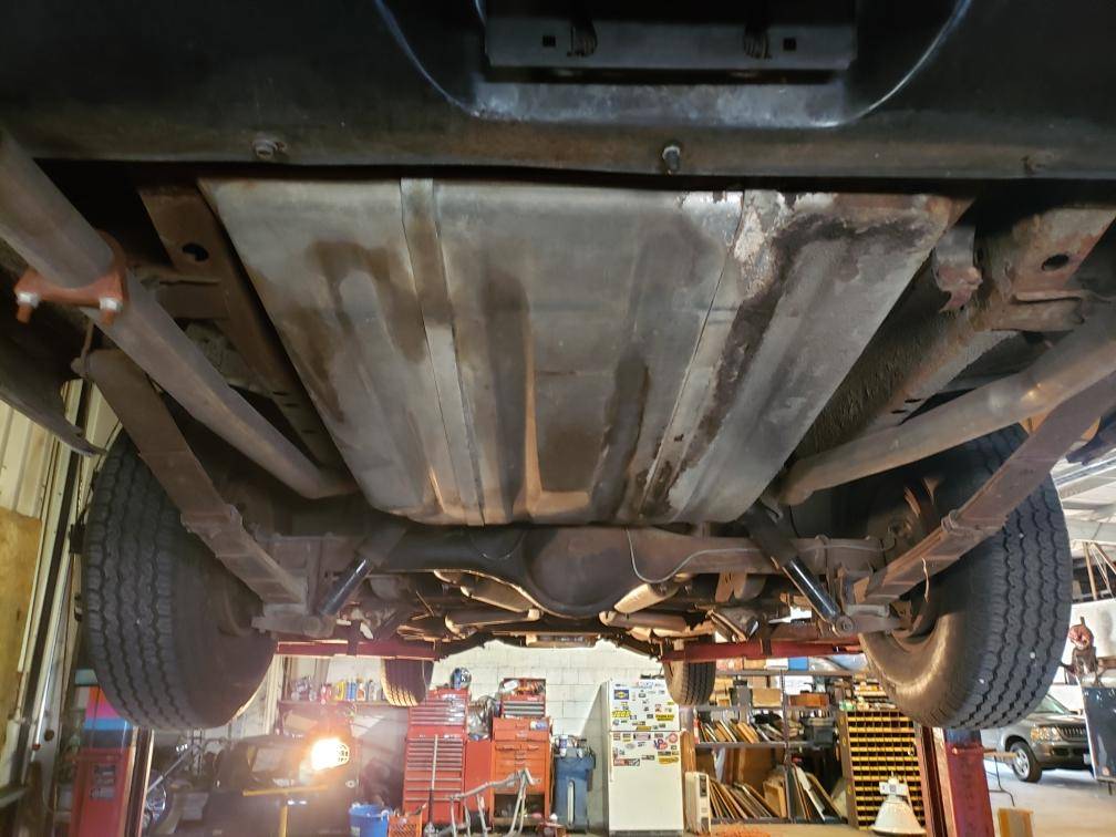

5. Wyatt changed the front brake pads, the master cylinder, and all the brake lines a couple of months back, but we decided at the time to leave the rear drums unchanged. Well, David found that the passenger side drum was cast improperly (not centered), so it'll be going after the winter-- and I'll take this opportunity to change both drums (not just the RHS), the shoes, and also the rear axle bearings while we are at it.

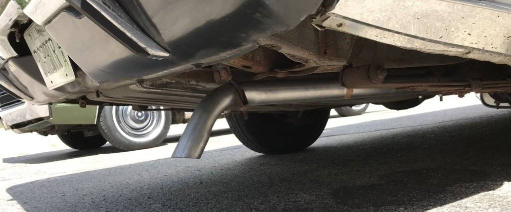

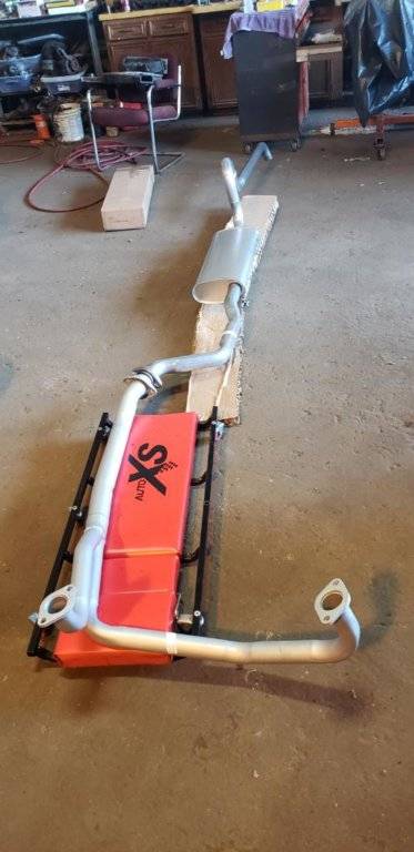

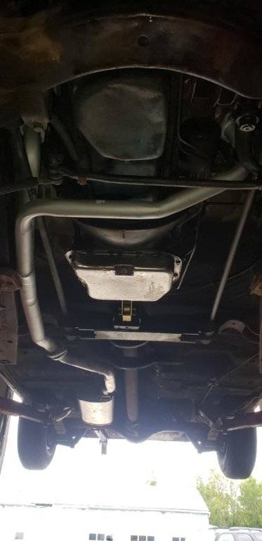

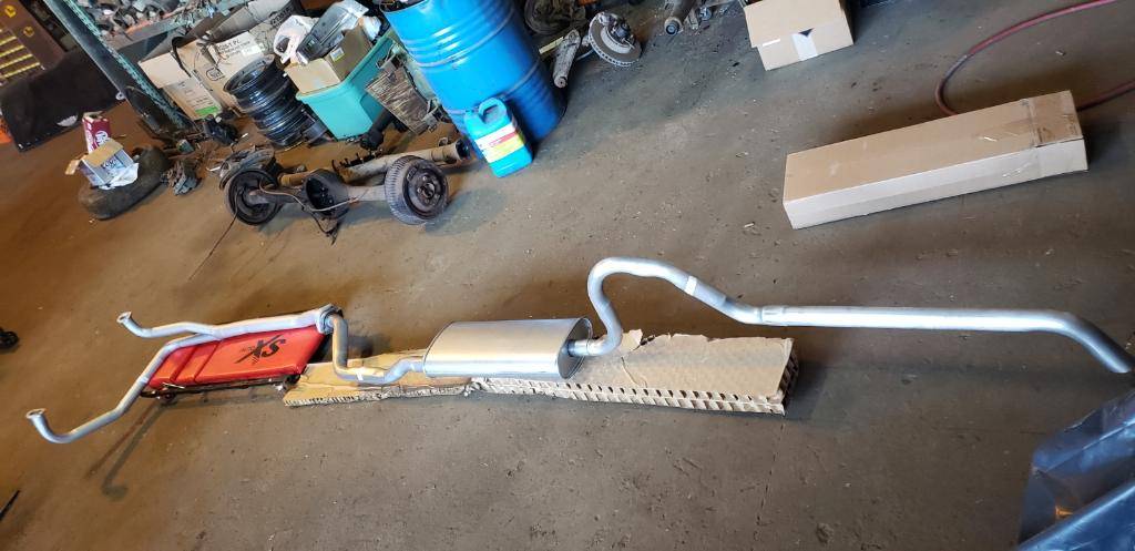

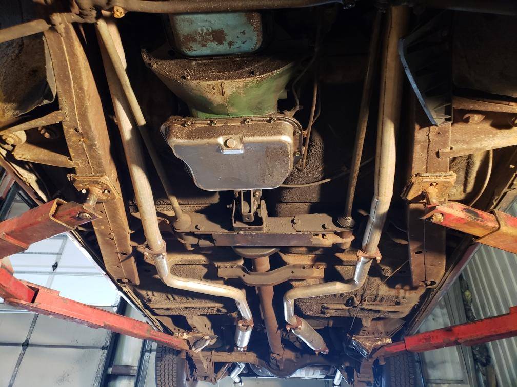

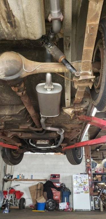

I just realized that I never posted photos of the new Waldron exhaust, which @71Polara383 installed before the CATL. As I may have mentioned before, the previous owner had installed duals to get "a cool sound." While the rumble was great, I wanted something more subdued for Medina as I want to be driving the car for long-distance tours. Not one to let good things go to waste, Wyatt used Medina's dual to replace a crumbling exhaust on the Monacucamonga; the dual fits that car's "rough and tumble" persona to a T.
Here are photos of the dual on Medina prior to replacement, and of the Waldron exhaust before and after installation. As you can see from the last picture (yes, it is @sixpkrt's 300 in the background), the tip is NOT what I was expecting: the angle is too sharp, and the pipe drops too far (i.e., it is too long) after the downward bend. I have notified Waldron, and am waiting to hear back.

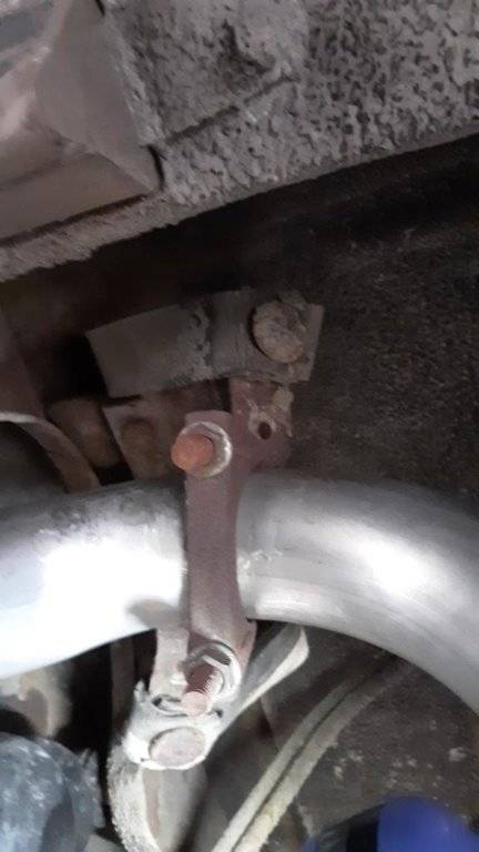

There was another issue, which Wyatt plans to remedy before Medina goes into storage. He noticed that one of the exhaust hangers looked like a messed-up original (I am paraphrasing), and @david hill indeed traced a rattle to that very hanger (I am posting David's photo). I had recently bought a couple of NOS ones from @marty mopar (Arizona Parts; picture attached) in anticipation that the hanger was the culprit. I was right and Wyatt will be replacing the messed up hanger but, for a proper fix, we still need the exhaust hanger bracket (P/N 3466987): @GG-1 posted last fall what it looks like. I have been looking for that bracket (also called a clamp by some) for a few months but have not been lucky, so if anyone has one lying around, I am interested.
Duals before removal:
Waldron exhaust before installation:
New pipe installed:
Exhaust tip not looking right:

Messed-up hanger:

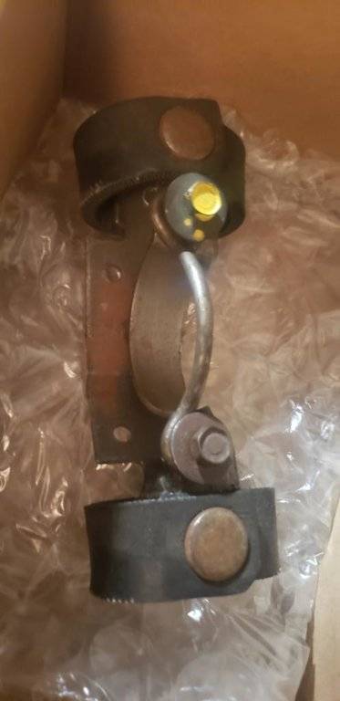

Arizona Parts NOS (two):

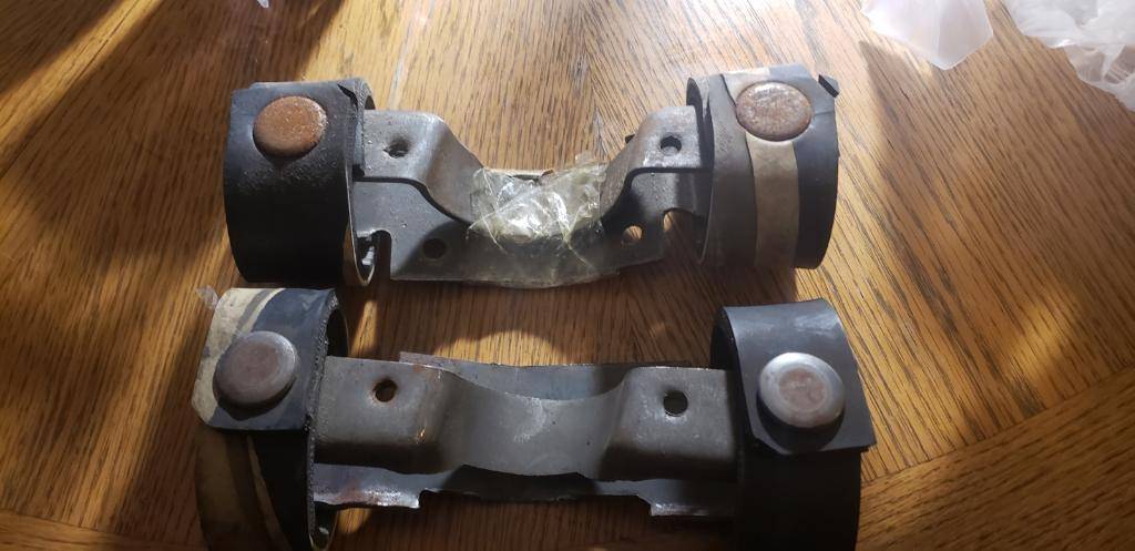

Today, Nov. 16, is Medina’s 49th birthday. Here is what I got her as a present: a NOS exhaust hanger, complete with the bracket and bolts/washers.
This is the front tailpipe hanger [right over the rear axle] for fuselage C-body BB Dodge and Chrysler models with single exhaust. For 1969 to 1971, it is P/N 2823933; for 1971 to 1973, the P/N is 3466646 -- I am not sure of any difference between the two. @71Polara383, who has seen both parts, cannot see any obvious difference either.
The two 3466646 hangers I bought a few weeks ago are correct and in very good NOS condition (one is available, if anyone is interested; I am keeping a spare) but they lacked the bracket or clamp (P/N 3466987), the two bolts, and the two lock washers meant to fasten the tailpipe to the hanger. After searching far and wide for the bracket, I gave up and paid the price for the complete setup. The yellow paint is from the factory.

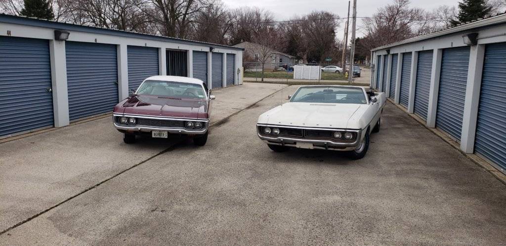

Here is Medina today, saying hello for the first time to her 1970 cousin Snow White. The photo is courtesy @71Polara383
