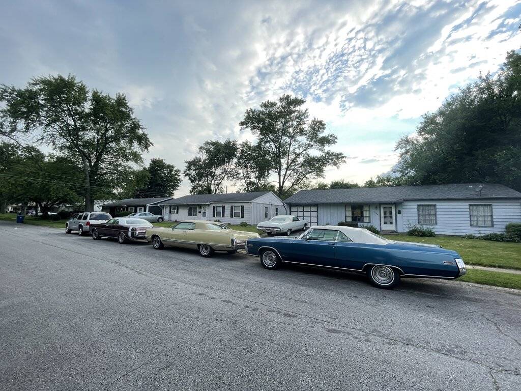

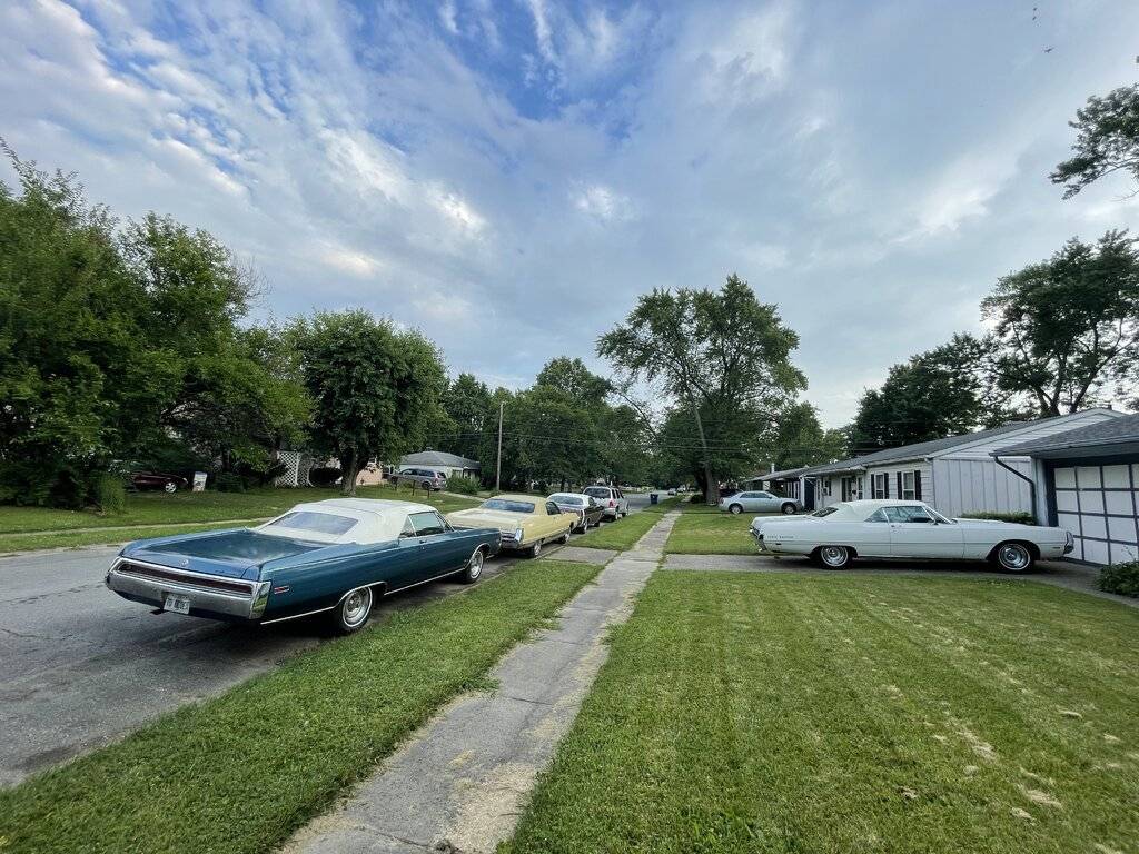

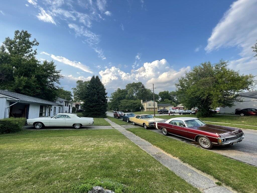

1969, 1970, 1971, 1972. Which one is the odd one out -- and why? There may be more than one answer to this question. Thanks to @david hill for making these photos possible.

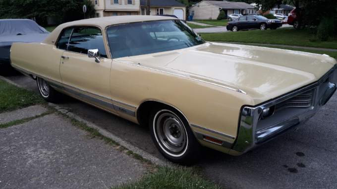

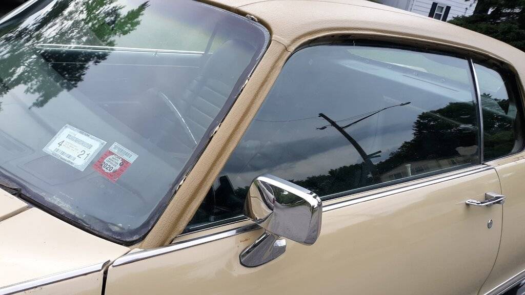

I found this beautiful GY4 Honeydew NYB with a gold top and black buckets on CL in Westtown, NY in mid-June and I managed to buy her before any sandbaggers got to it. Thanks to several members, in particular @coco , @Marv , @AussieFellaWithaCbody , @71Polara383 , and @saforwardlook for their help in this process!
This car was a 60th birthday gift to the seller by his son. The father, who just turned 90, stopped driving the car last year. He and/or his son used to drive the car every week, on "cruises" in NY/NJ/PA. That explains the 109k miles on the odometer, which is fine by me. There are some dings in the body panels because of what happened to the owner's ability to drive her in close spaces as he aged -- I guess that explains the bent front valence. Nothing major though.

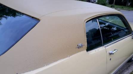

The car was stored in a carport after the son helped the father sell his place last year, and you can see the result on the roof -- the son told me that the tears in the vinyl were not there before, and that's when they decided to sell the car so that it would not deteriorate further. Mechanically, the seller's son said that there is an exhaust leak. The incorrect exhaust and road wheel caps were there when he bought the car for his dads in 1991, so I have no plans to change them in the short term.
Later this afternoon, Buttercup will be on her way from New York to Illinois for some work by (mostly) Wyatt and myself. Here is the plan for restoration, based on what I have seen (pictures in the ad and the ones the seller sent to me, video inspection):

1. Top -- surface rust repair (bottom of the rear window, by Wyatt) & new V1G vinyl installation (with a shop recommended by @david hill );

Attached below are photos that the son's wife took this morning -- ain't she beautiful?
The odd one out is the 1969 white convertible - you don't own it. Its also parked in the driveway. It also can't be driven without going over the lawn..............
The 72 NYB is the only one without a white top.
The Monaco is the only one without road wheels (but I actually like those wheel covers just about as much).
Obviously, the Durango is an odd one out, but that wasn't part of the selection list........................

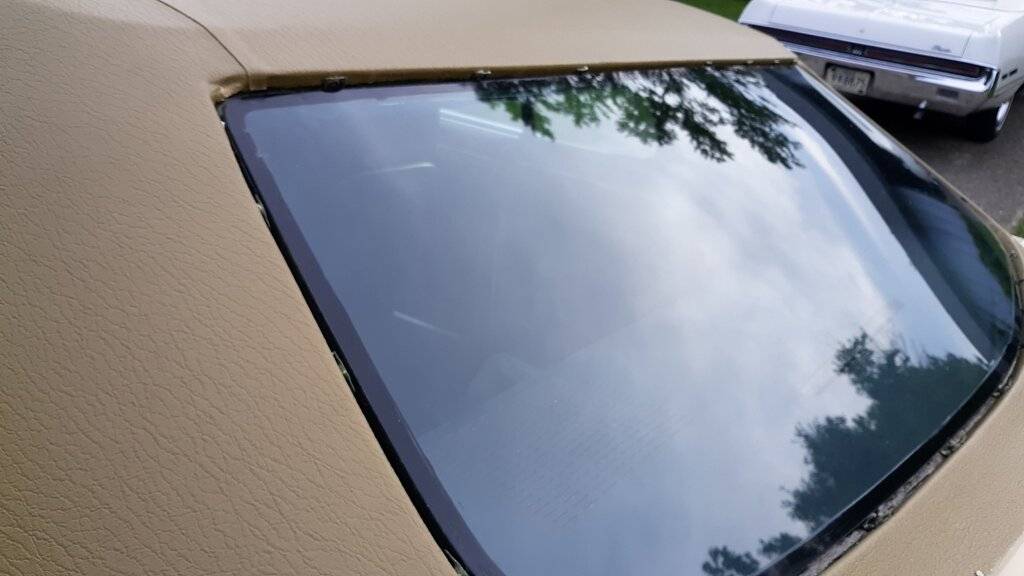

I like that the top is finally installed but the seam on the A pillar should be lower to cover the A pillar to roof panel joint should the guy on the assembly line do a bad bondo job in covering that joint.
Did SMS make that version as well? They ought to know better by now! The upside is that no one but a fanatical purist would note it possibly.
Love the color combo on that car. A black roof would have killed it even though it has a black interior.

.....snip.....the seam on the A pillar should be lower to cover the A pillar to roof panel joint should the guy on the assembly line do a bad....job.....snip.....
The A-pillar seam flub is one of the reasons I returned the first top I received from SMS. That top also had said seams at different heights.
Send me to the asylum....

With this top I noticed that SMS didn't provide very much extra material...I'm sure the a pillar seam could have been positioned better if they gave the installers a little more to work with.
Very few would notice that minor detail, however it is something to keep in mind for future vinyl top replacements.

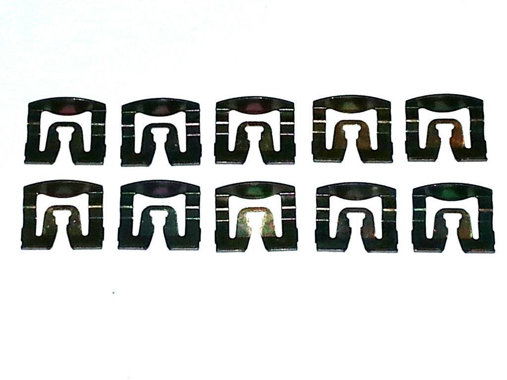

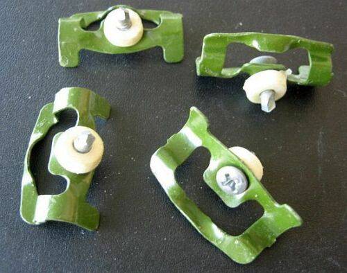

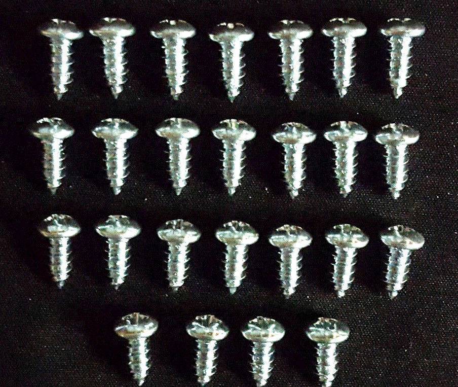

It looks terrific. Were you able to get replacement clips for the window trim?
Yep! @Analog Kid gets a special thanks for helping with sellers. Here are the originals that Wyatt pulled out:
The big clips I ordered on eBay last November: I paid $23 at the time, but the price from the same vendor has fallen by half!
The small clips I also bought on eBay last fall; here the price is unchanged.
Finally, I got the screws on eBay too (price unchanged as well).
