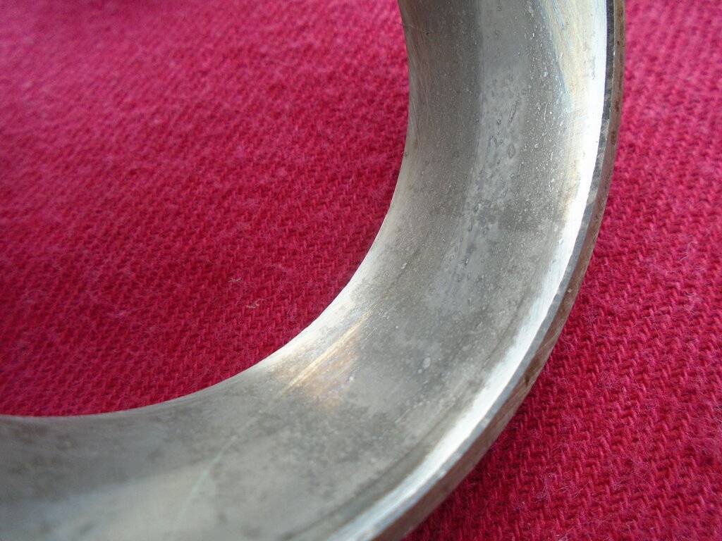

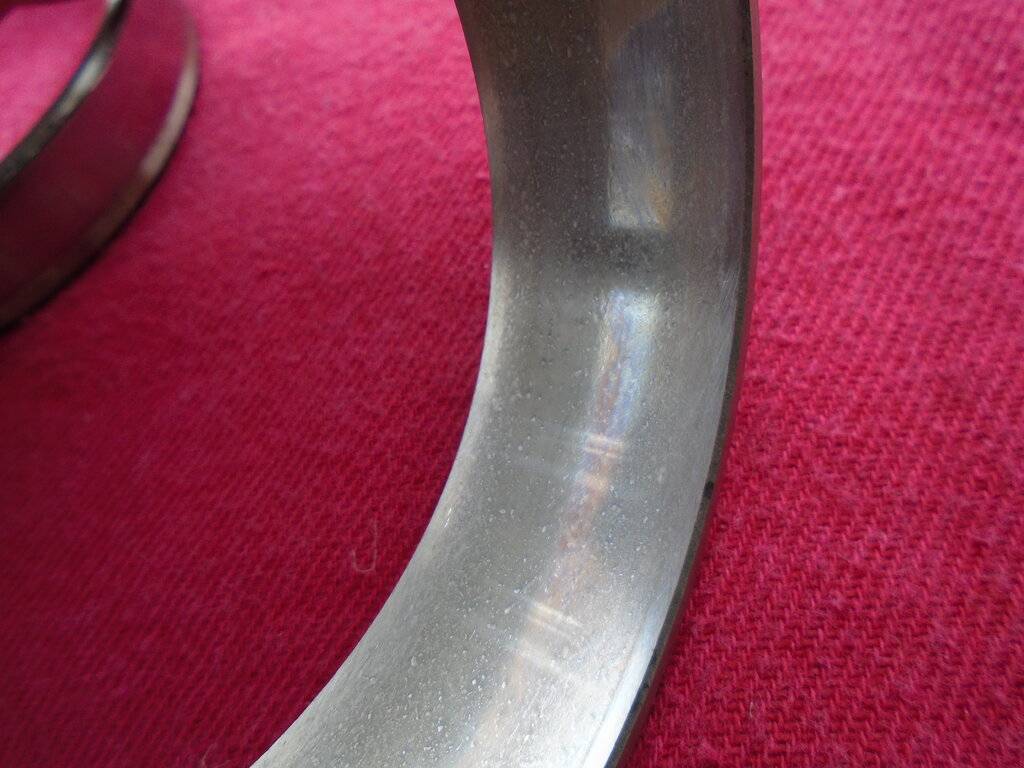

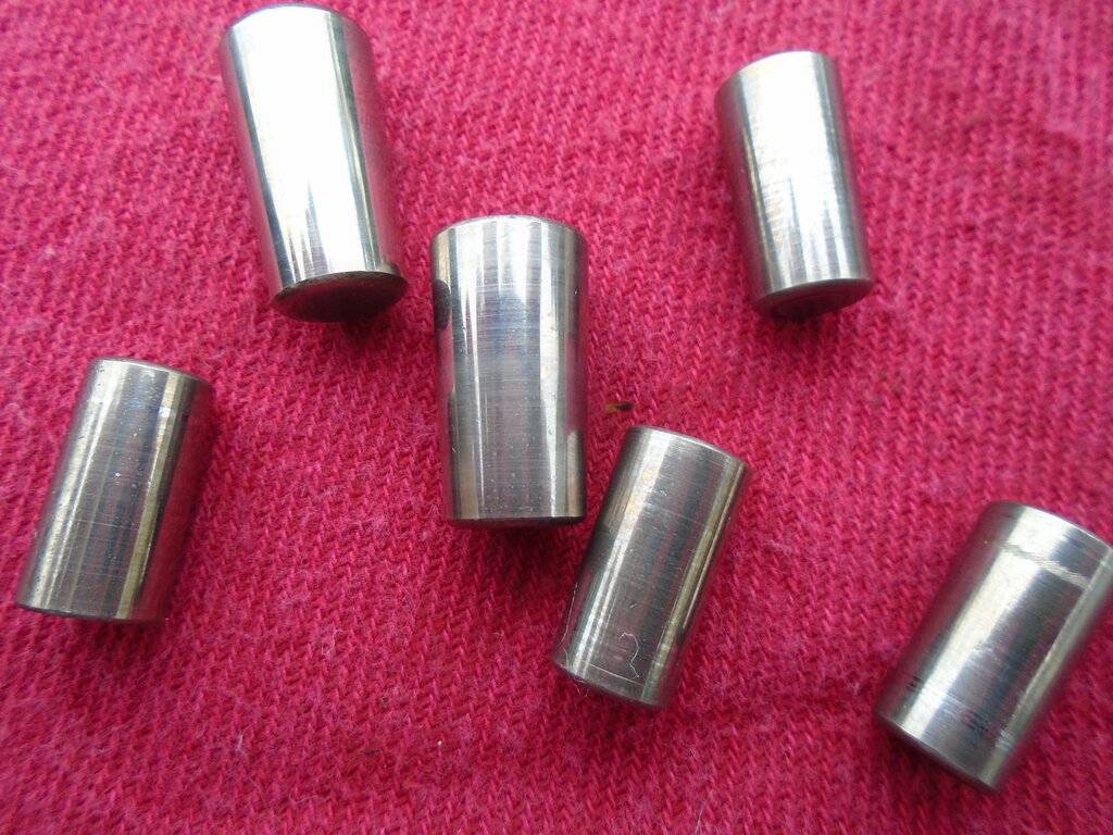

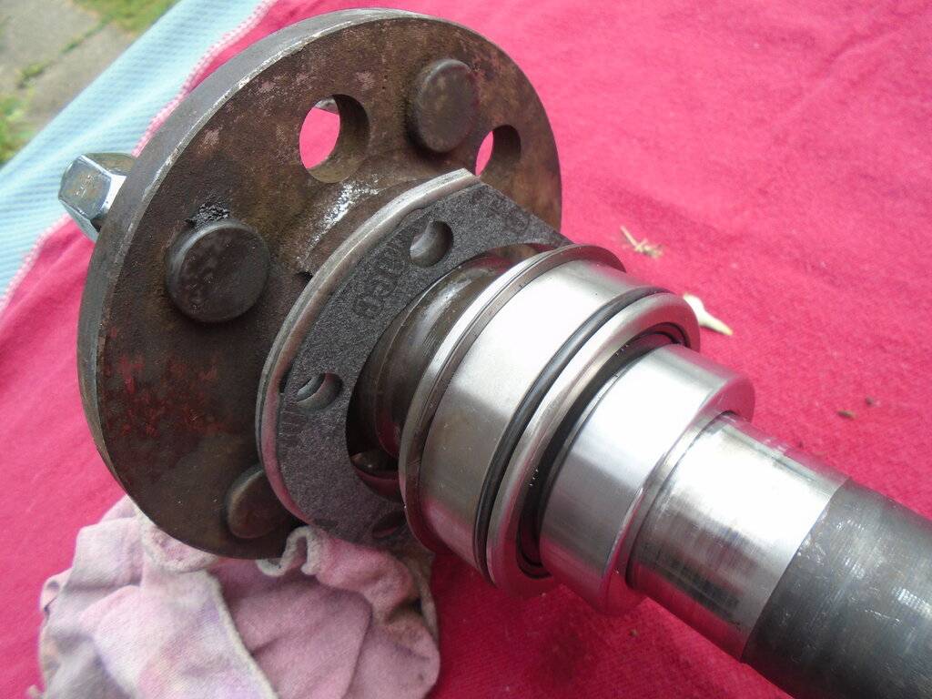

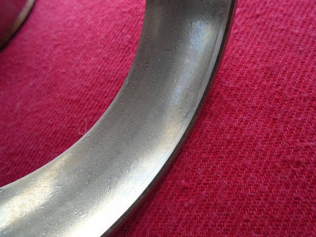

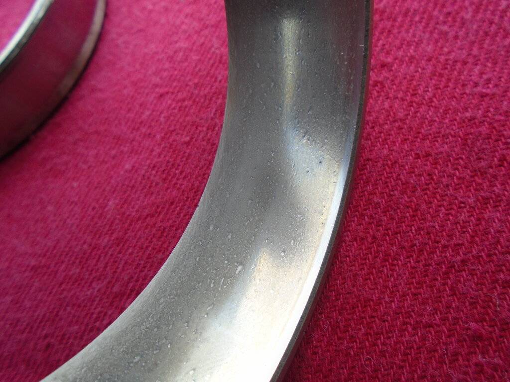

    As stated previously Buttercup was dropped off to be taken and have a vinyl top installed. While driving to the destination it was generating undetermined differential noise. After the top was install it was determined that the pinion and carrier bearings were the source of the noise. As seen in the photos below the amount debris run through was excessive.

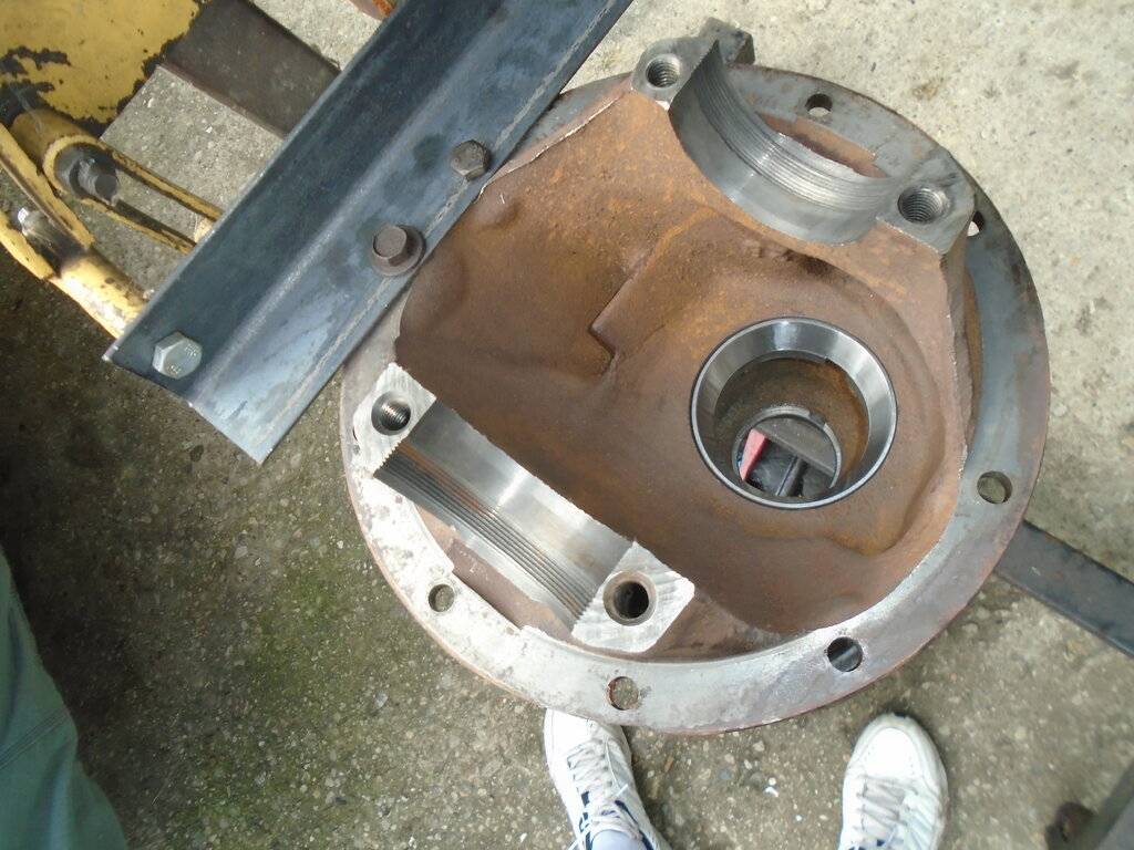

    If you look at the diff carrier housing you can see where there is is a small impact at the carrier cap area. This caused the outter race miss-alignment and eventual bearing failure. The rear gear ratio is 2.76 as seen on the pinion gear. I was pleasantly surprised the was no abnormal ring gear or pinion wear.

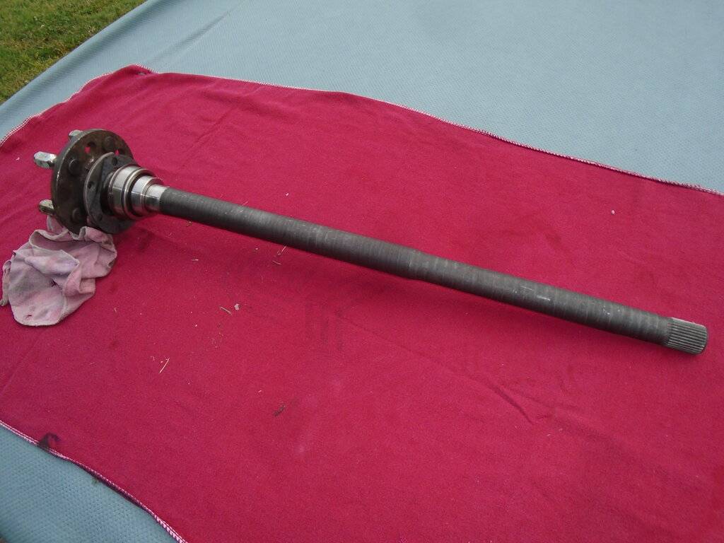

    The rear axles were treated to new axle bearings and inner seals. Although some purists may disagree Dr. Diff Green bearings were installed. Have had no failures and have proven reliable. Filled w/ Valvoline 80/90 gear lube. Test drive reveals all is quiet again. A carb adjustment to the Edelbrock carb and choke made cold starts much better.

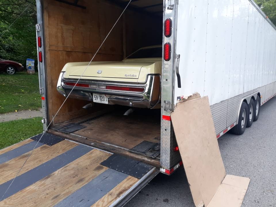

    I am happy to report that Buttercup is back in Illinois. Here she is getting on the enclosed transport in Indy (to protect the new top before moldings got back on), thanks to @david hill's help:
    After getting her back following the "spa" time in Indiana, @71Polara383 took the front seats to a local upholsterer recommended by @sixpkrt who redid Medina's front seats, and he'll pick them up tomorrow. I got the vinyl directly from SMS, and Bruce did a "a total rebuild and reinforcement on the cushions and back rest in the face (...) using brand new, top-of-the-line foam" -- I will post photos after Wyatt gets them back on Monday.
    • Like Like x 5

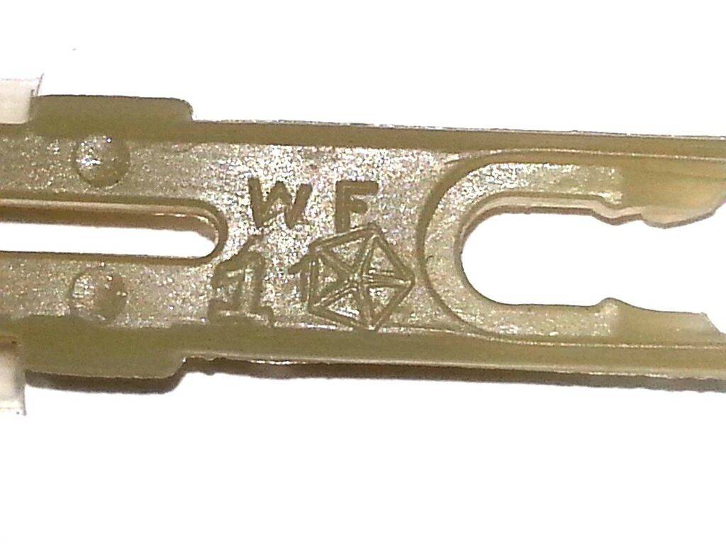

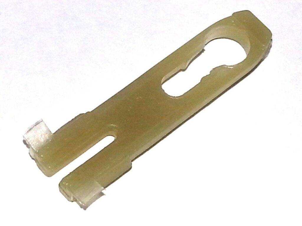

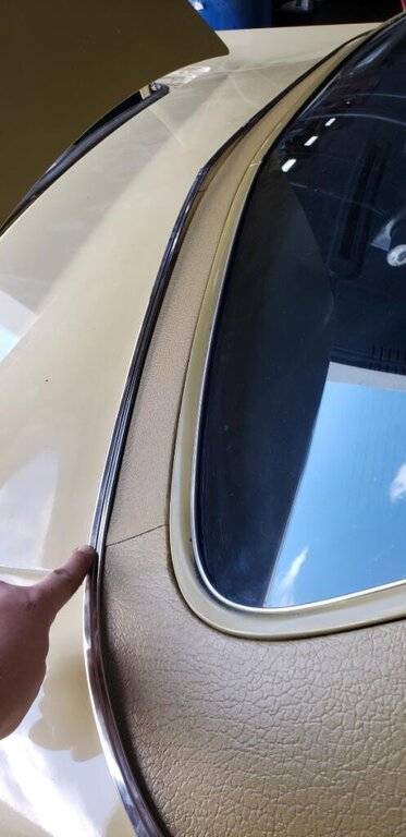

    As the vinyl top trim goes back on, it seems that the clips for the trim moulding next to the Dutchman panel need replaced, too.

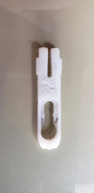

    I need two sets of items. One is plastic clips, which are not an issue -- @71Polara383 found replacements on eBay:
    1. original:
    1b. replacement (note the similar "WF" marking and the Chrysler logo:
    • Like Like x 1

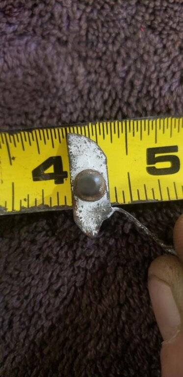

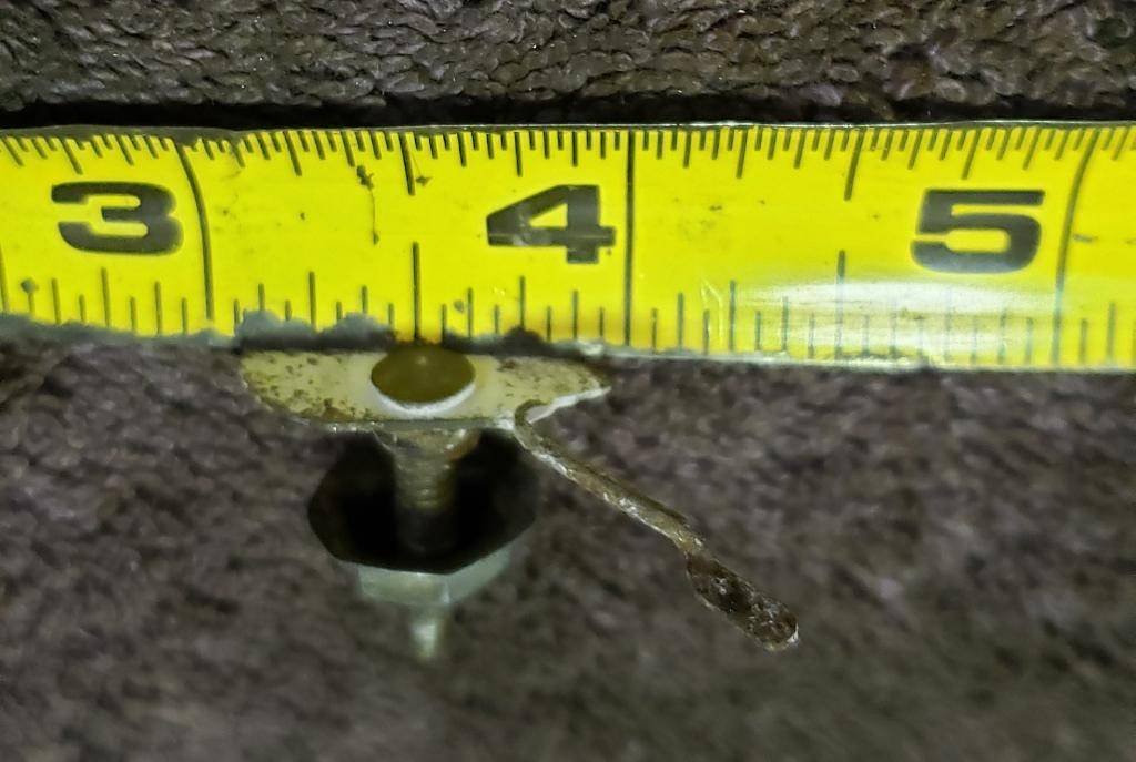

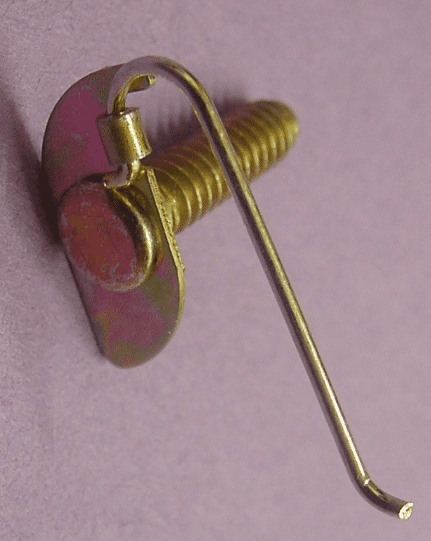

    The problem is with the second set of clips:
    2a. original (5/16 width):
    2b. replacements: there are some "universal" replacements on eBay -- kinda close but no cigar. An example is here, they look "inverted":
    --> any and all suggestions would be highly welcome.
    PS: @Big_John I know that you have recommended Clips and Fasteners, and they seem to have similar items -- but I have not been able to find the exact replacement for the spring clip.
    Moulding Clip -Chrysler
    Moulding Fasteners #10-24 X 3/4 Bolt 5/16 Width

    Were all the little clip mounting studs intact?

    The old ones came off intact and we thought we'd be able to reuse them - but a few aren't grabbing.
