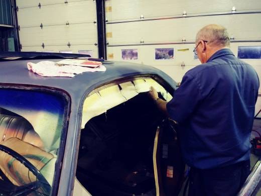

    Once the bows were clipped in Bill started tugging on the material for a tight fit..

    Here's a tip Bill showed me...
    All screws inside were put back in their respective locations before the headliner was installed.
    Using a razor blade he cut the material at the screws instead of "guessing" where the holes were.
    this includes the sun visors and the shoulder belts.

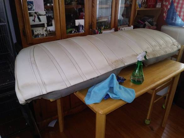

    Maggie had the day off from her work and cleaned all the parts that were out for the headliner install..
    including the rear seats.

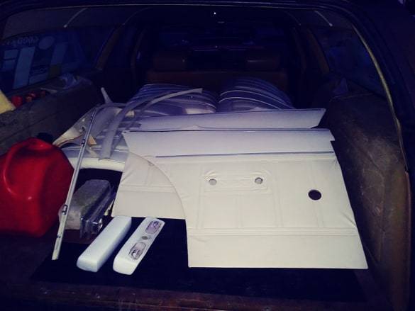

    All loaded up in Waygun to go back to the shop..

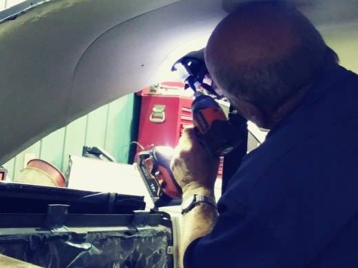

    2-1/2 hours and the interior is back in one piece.
