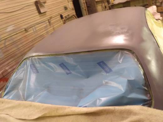

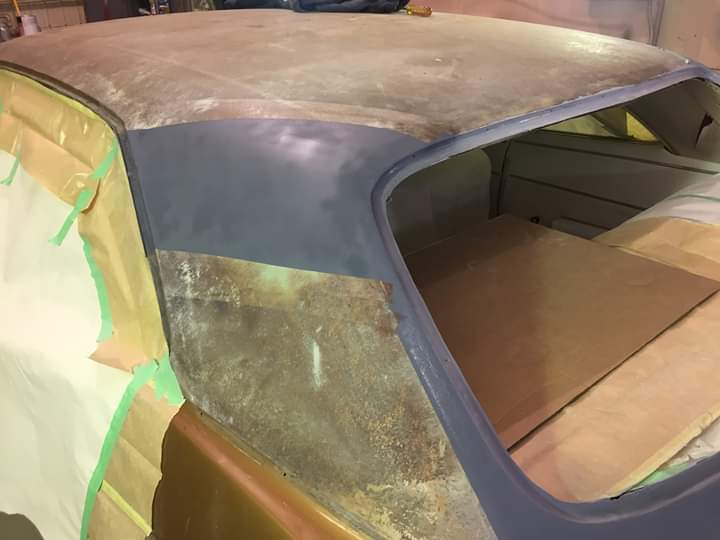

    Applied a couple coats of primer over the repairs. Sanding the roof is next..

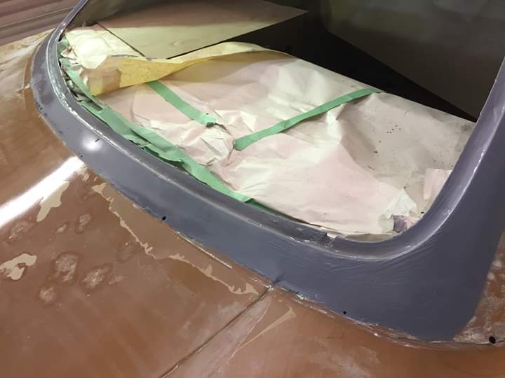

    Looks great! May have missed it earlier in the thread but did you need to replace much metal in the back window channel area?

    The holes were small enough to use Metalux. No cuttin no welding needed. Very lucky in that regard. If it was ignored the repairs would have been drastic.

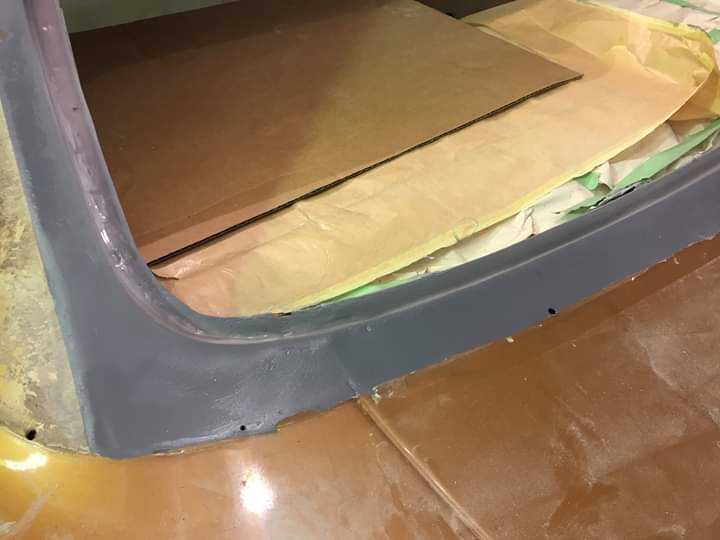

    The window channel once cleaned out is in excellent condition. No fabrication needed!
    Just some grey rust killer paint which is canuck Dom16 or Por15 equivalent

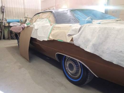

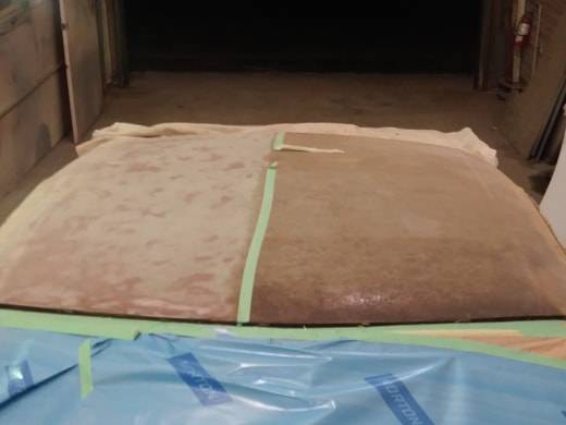

    This week Maggie and I sanded the old glue from the roof in preparation of the new top.

    The old glue is the darker side...

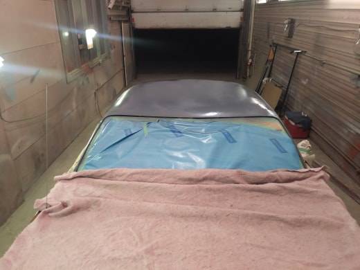

    After Maggie was finished sanding I put a coat of primer on the roof.
    It did not have to be show quality perfect but at least the roof is well protected for another 50 years..I hope.
    We made sure the car was well covered with what was around the shop.
