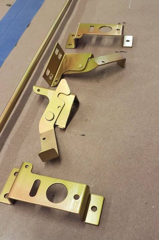

Metal gold cad look.
Sounds like everything worked out great.

I ran into the issue with the Rustoleum primer. I decided to use it once based on convenience and price, instead of the NAPA product. Now I always make sure I have a can of what I prefer on the shelf. It has an excellent shelf life, a nice fine mist; sandable, and won't clog, so I always get every drop out of it.

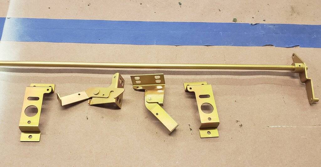

I am happier with these results more defined then previously. No clear applied.
Looks good
Are you going to bake the parts at all?
My concern with rattle can paint is that it remains relatively soft.
I have had good experiences with baking parts in an old toaster oven.
I hadn't planned to but I have a stove I use in my lens making process. What temperature and for how long?
