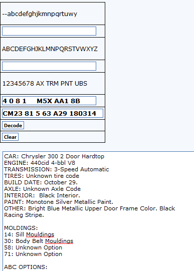

I will start my 300 project here. The first thing I would like to do is decode my fender tag.
12345678 AX TRM PNT U8S
4 0 8 1 M5X AA1 8B
CM23 81 5 63 A29 180314

mymopar.com is a good place to start but remember that it's not always correct. Your interpretation of the fender tag may be off because spacing is everything on fender tags prior to 1969. Here's what I got from mymopar.com by guessing the spacing on what you entered. A pic of your fender tag would be very helpful.

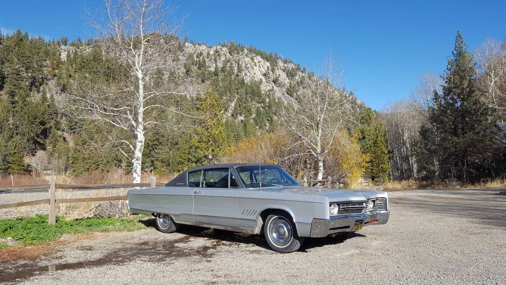

Thank you, I will take a picture today. I was hoping the correct paint was silver. The repaint is a shade off of original but vary close. I don't think it had a black stripe do you?
Yep, they were pin stripes just below the belt line.
As DetMatt said, the pinstripe is almost certainly correct. Higher end cars of this era almost always had a pinstripe. The 300 owners will certainly be able to help you more, I'm sure.
As I said, mymopar.com is a great place to start but the decoding tools are not perfect. I would question the OTHER: line in the decoding above. Neither sounds right to me. I don't believe any 300 other then the Hurst/300 had any special graphics.
A common issue with 69-73? decoding on this site is that it decodes the D32 trans as a 727HD when the D32 was the standard duty, D34 was the HD, just as an example. Properly decoding a car is difficult because there is so much misinformation out there. If you can find a build sheet, that will help you a lot.
