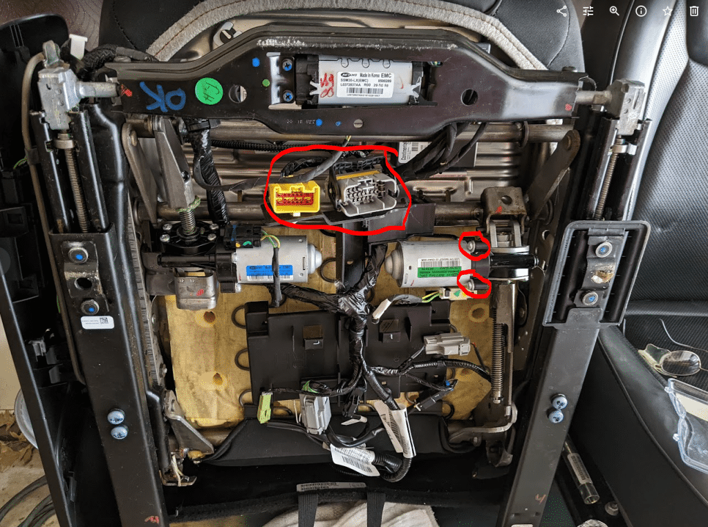

The 2 circled connectors below show what I was dealing with. I was not able to find any schematics, but fortunately there were red and black wires on the pigtail that were larger gauge than all others, and hooking to them operates all the seat motion functions. These seats have fans built into them, I may try to figure them out (but the fans have 3 wires, who knows which ones to use?).
You can also see 2 of the 4 screws on the motors (circled). I loosened them and realize they hold the motor can onto the drive mechanism, and would cause the armature to come out. To remove the motor requires disassembling it from the metal drive mechanisms, which seems a nightmare. Which is why I tried the 2-wire harness on one of the motors, and luckily it worked.

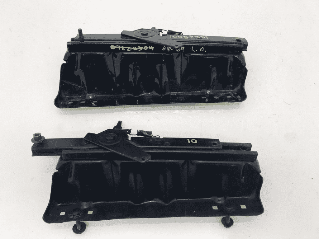

Here's two things you can do with the existing seat.
First is pull the seat and look at the bottom. It should look like this picture. Knock or cut the existing bolts out and move them to the forward most holes. If needed, you can replace the bolts with carriage bolts from any hardware store. Yes, that's only an inch, but it's surprising how much that extra inch helps. I did this in a '68 Chrysler many years ago.
Next thing you could do is buy (or make) a set of these: https://www.yearone.com/Product/challenger-cuda/sb246 That will give you 1 1/2" to 2" more.
