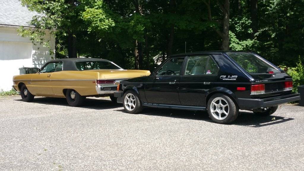

Interesting as my Omni is the complete super 60 setup I built in the 90's. I don't use the S 60 computer and run a custom flashed Smec.
Here is mine to bring back memories for ya.
