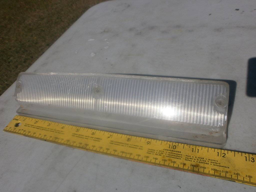

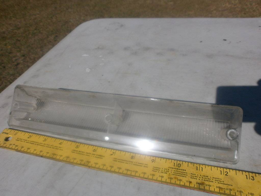

I've not measured it but I'm pretty sure they'd be longer than that. I have two sets, the ones on my car which has a poorly repaired crack on the passenger side and a cigarette burn on the driver side ("class act"). The other set I picked up, missing the inner trim ring, has light stress checking like they all do .. not sure how that would effect a mold .. not sure it would.
I'll throw a ruler at them tonight and see if it'd even be possible for you. If it is and you'd be interested, I'd gladly sacrifice my "better" set for reproduction. I know theres a lot of guys out there that'd need em.

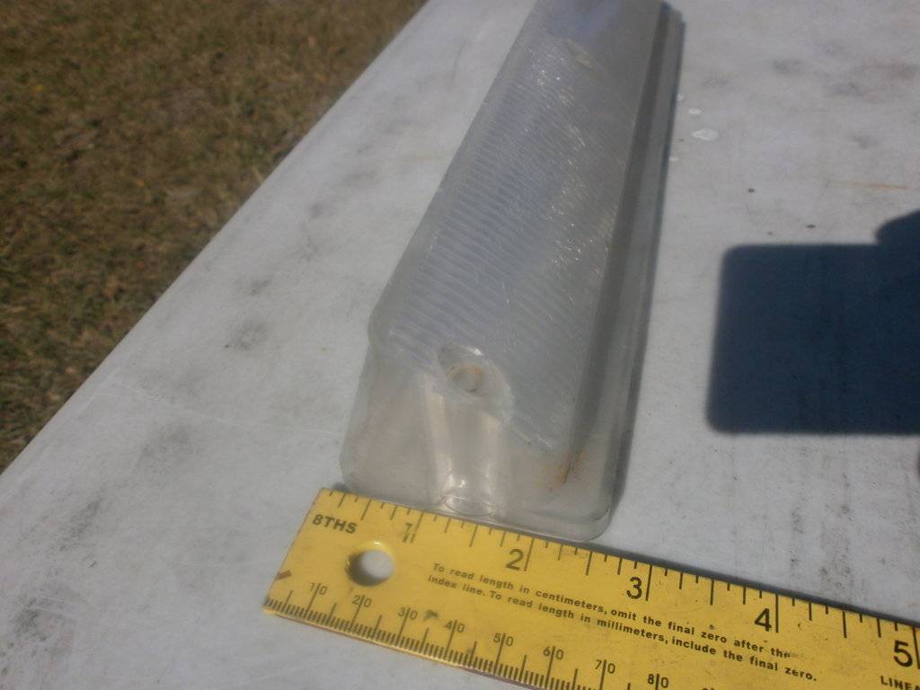

Yes I believe that lens is bigger then what would fit in my pressure pot. I could show you what a lens looks like when it's not cured in the pressure pot. The little bubbles are gone so the lens is clear. but there will be some bigger bubbles, but they would be on the back side. Not really noticeable except when they are lit up.
Welp, I gotta clean this set up anyway. I snagged both assemblies for 25 bucks (again, missing the inner trim piece). They are however unbroken. The question is whether or not they will remain so after disassembly. If it stays intact, then the question is whether or not the fracturing would be more or less attractive than bubbles.

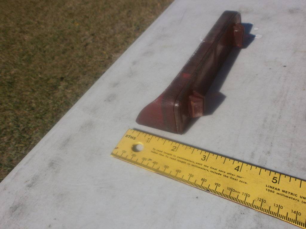

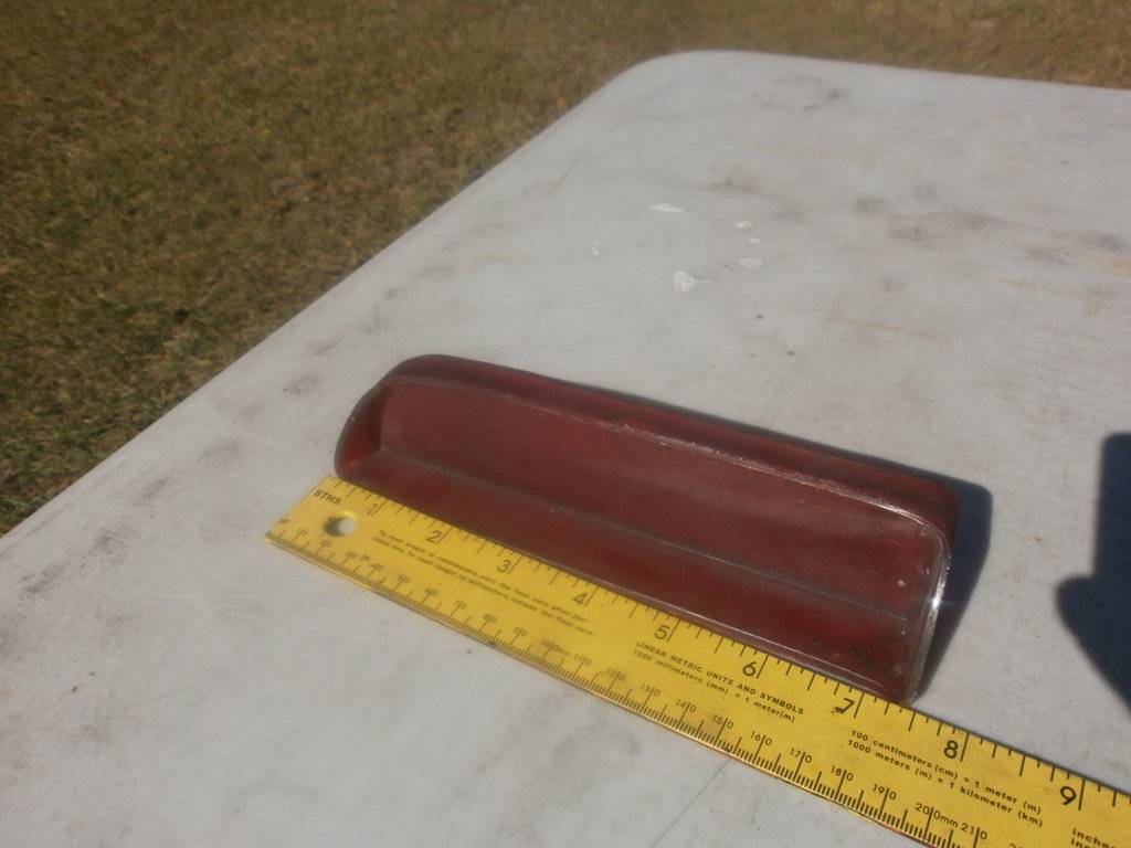

My buddy has a perfect lens to work on first, to see how they turn out with some cracks, but intact. I hope to make a mold of it in the next couple of weeks.
It is a nice small lens so I can experiment with it. It is clear but I can make a red lens and make one that isn't cured in the pressure pot.
