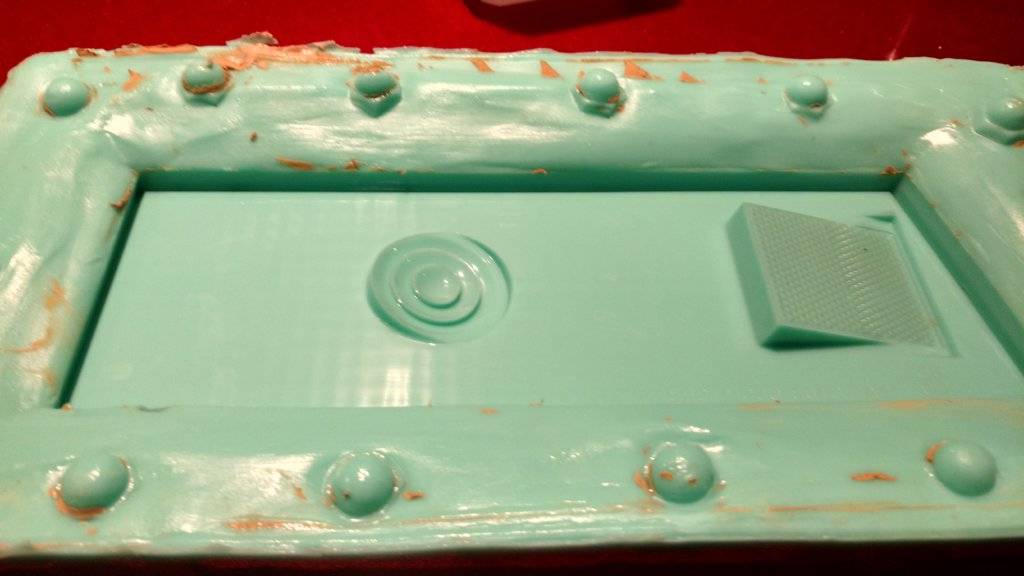

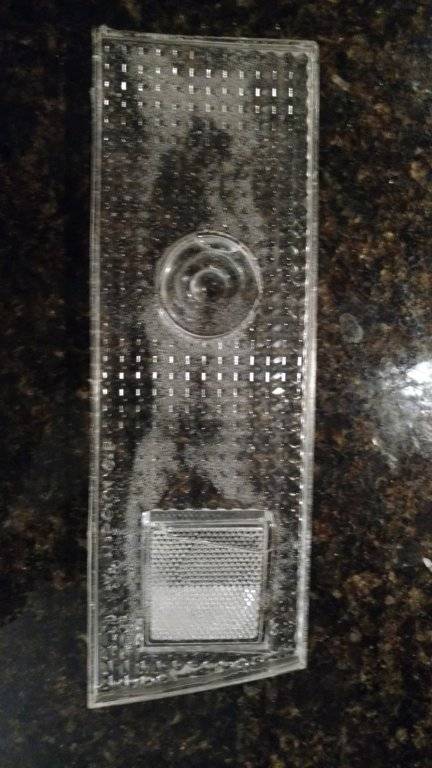

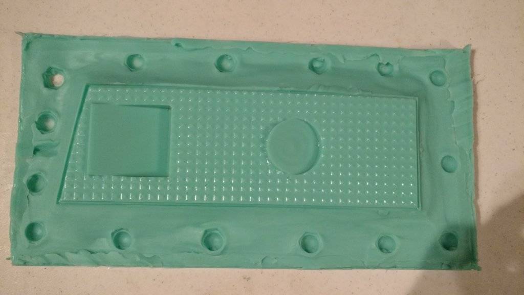

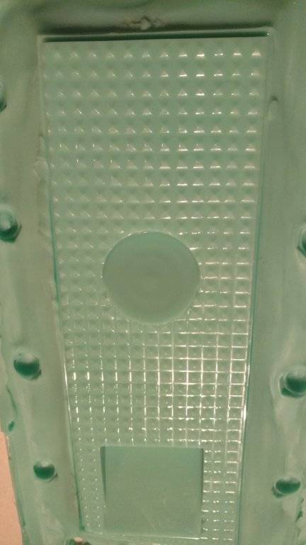

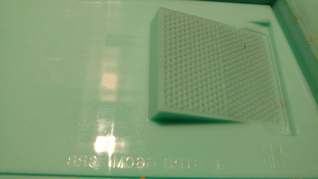

    Do you ever have one of those days when nothing goes right? I had one of those yesterday. The good part I feel good that I can correct my problems.
    First I was pouring my second half of my mold I should have place the first mold on an oversized board. A rather large portion of the mold ended up pouring past the plexi wall.
    Second when I was mixing my resin I realized my vacuum chamber isn't producing enough vacuum. I ended up with lots of little bubbles so I already knew this was going to be bad cast. I believe I can get the vacuum numbers I need by simply using a better seal around my pressure pot.
    Lastly on pouring the mold I had areas that projected out, that should have been my bottom mold instead of my top. I had an air bubble and it never finished the mold in 2 areas.
    The good from this. I really like the feel of the lens, today's plastics have such a low resin and feel very brittle and sharp. I can just tell its a high quality. Secondly I did get two good halves for my mold. I will probably end up adding more to my second pour, so it can be now the bottom mold. Lastly the lens is the correct dimensions and thickness, and hopefully this will be the ugliest lens I make. :)
