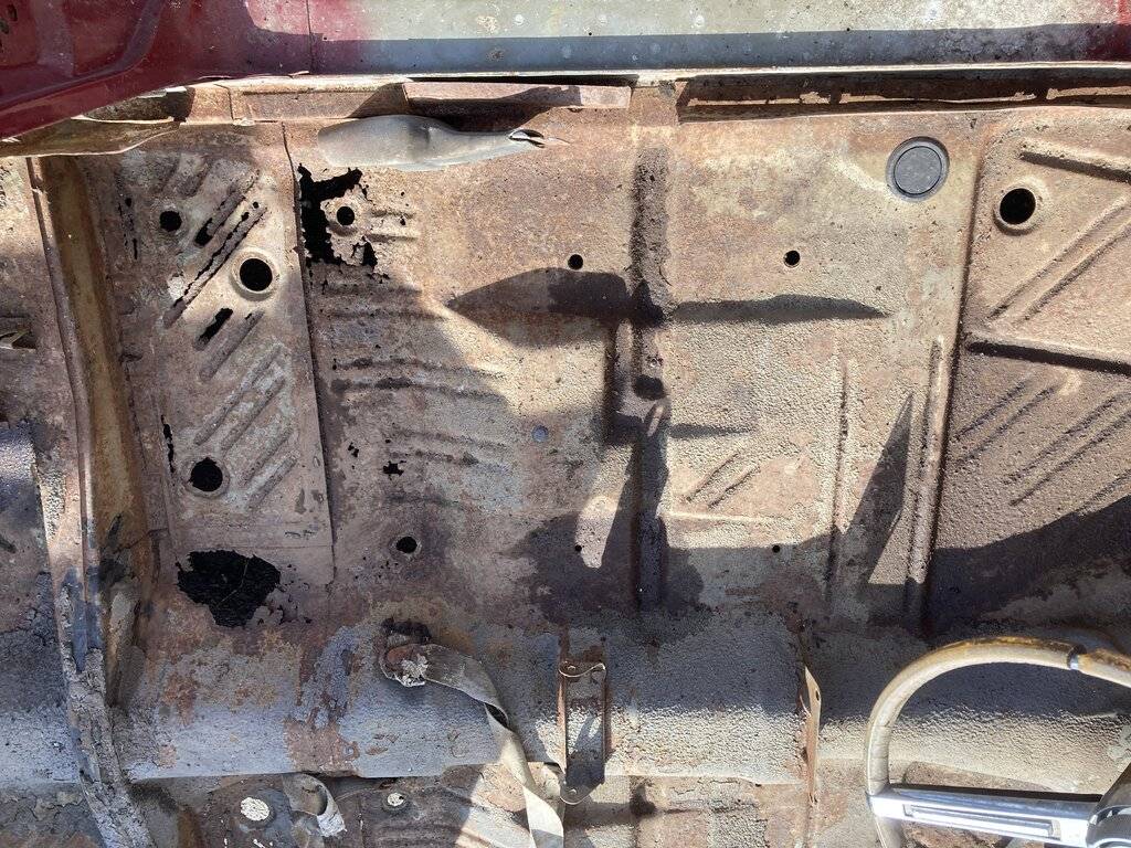

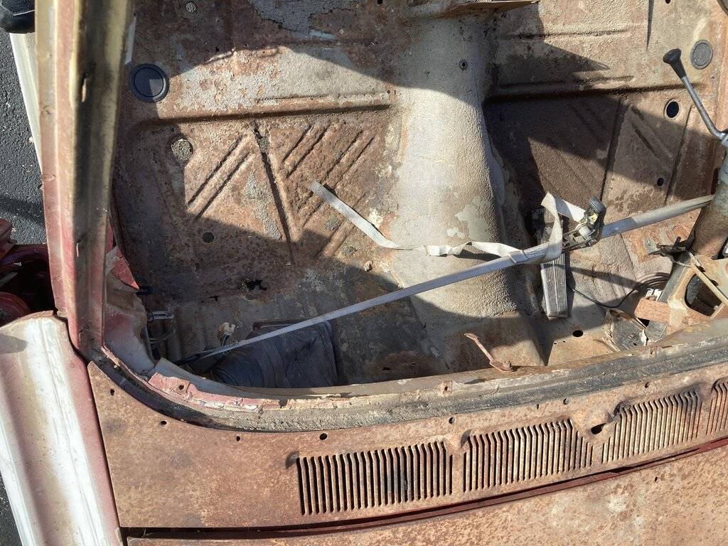

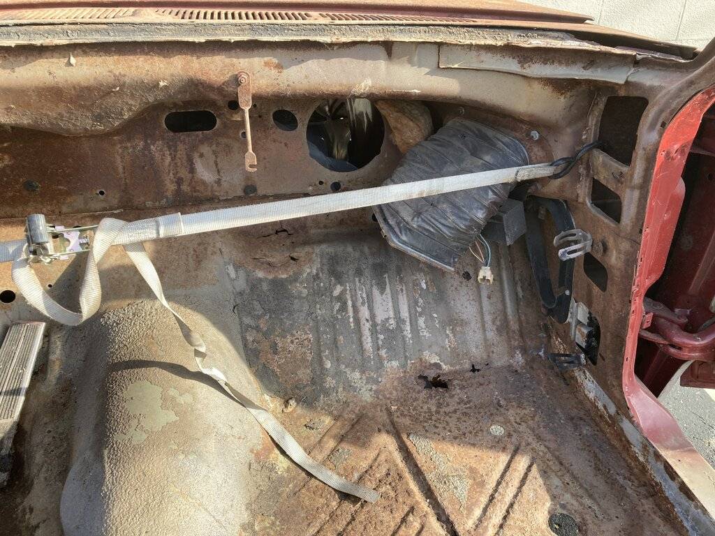

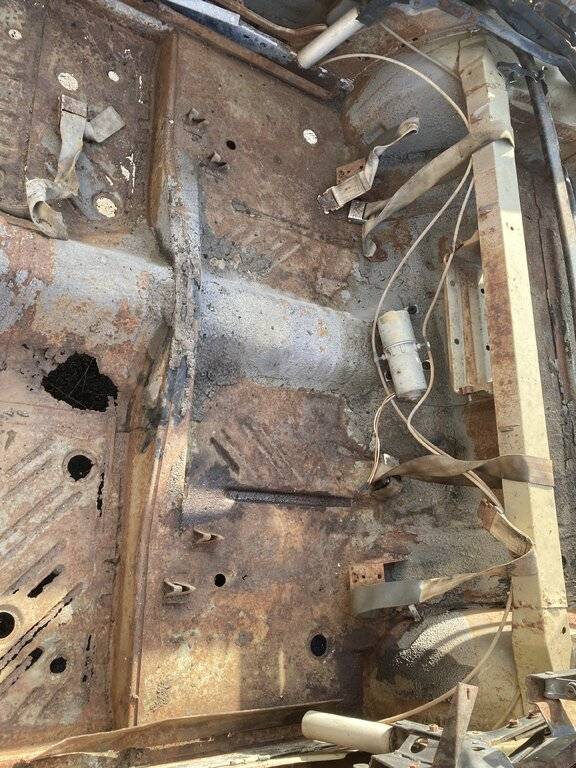

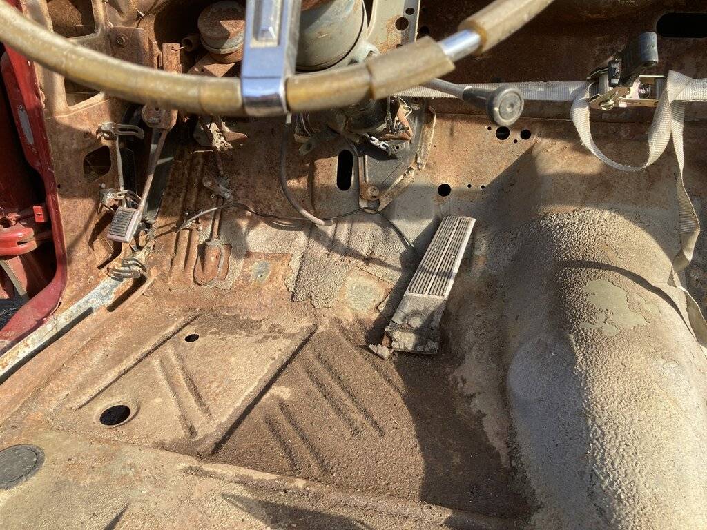

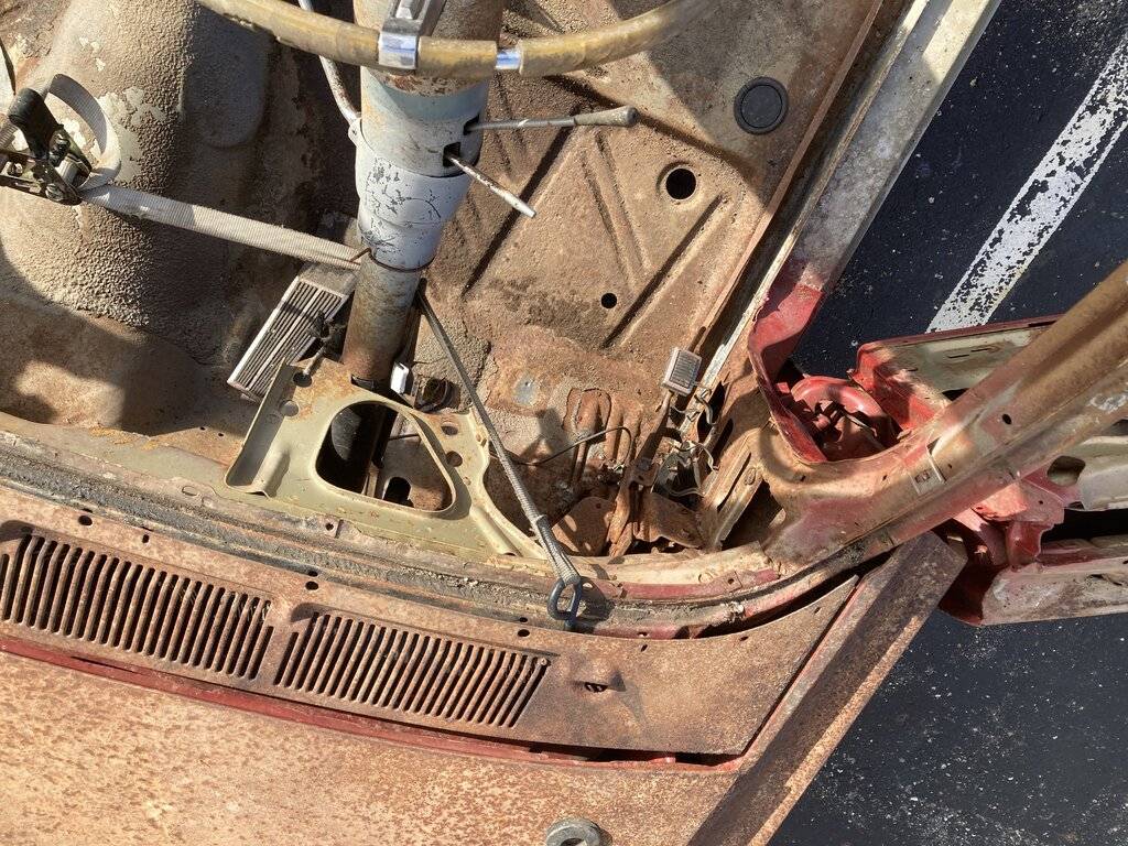

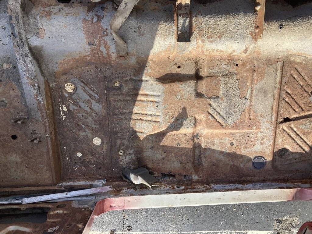

I’ve got 10 winters worth of projects without this one:lol:.
The worst rust is on the interior pans and they’re really not that bad. No rot around the windshield frame either.

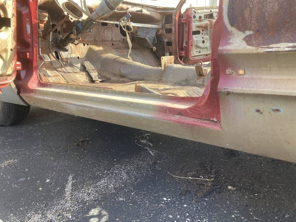

Does this convertible body has any extra reinforcements on body compared to 2D HT?
Can´t see any on these pics, but maybe under floor pan?:wideyed:

Good question, I haven’t looked but I will have a look to compare.
Since it is a unibody I presume it is like my 66 300 convertible. There is a solid piece of steel that runs in the rocker panel of the car, internally. This would be rather hard to duplicate in a non convertible car.

I don´t think that as too hard to duplicate. :thumbsup:
Needs just cutting the rocker panels of and adding enough heavy gauge steel tubing inside there.
I´m probably adding also connectors between stub frame and front mountings of rear leaf springs to ad strength to body.
