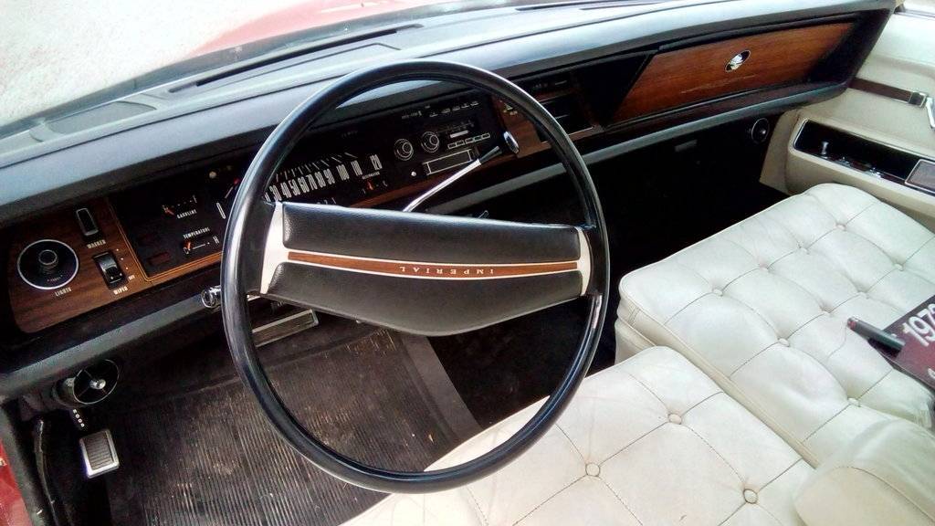

In Texas... be surprised if the wheel wasn't already cracked in several places.... Doc, just so you know... we are all looking for these wheels if our car came with one... almost all of them have at least one good crack unless parked inside their whole life.
If the price is right and the wheel isn't too bad... you may find a leather wrap is all you can do. Well you pay up for a recast... but a grand and a half is asking a lot of my wallet.
I would take a worn cracked original one over that ugly one I have now.
Actually, that very nice wheel it just doesn't belong in that car. This is where they belong...

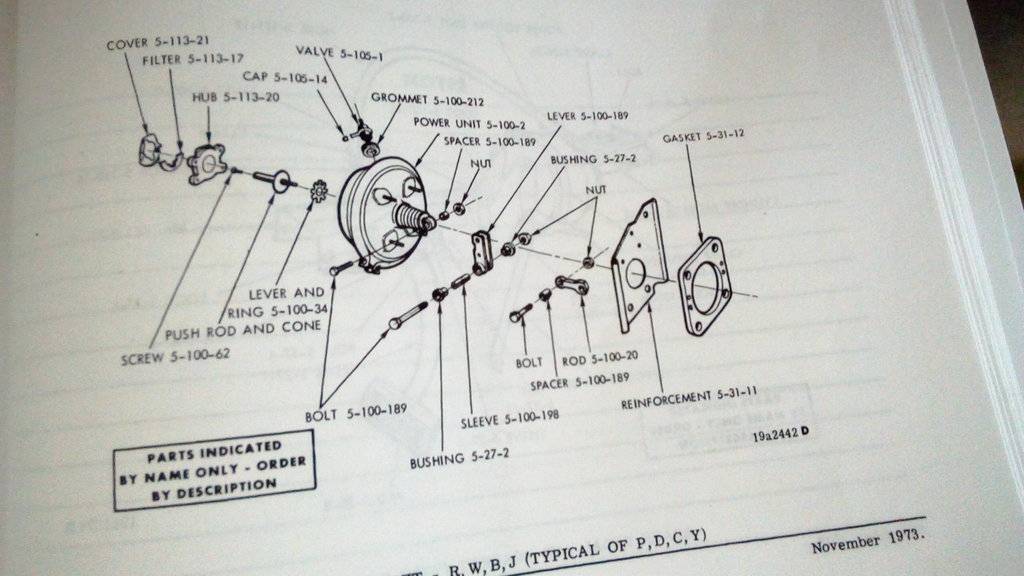

Here's a pic from the parts manual for your power brakes. I would check pull the hoses and run a vacuum "hold" test on the booster to check the grommet integrity and the gaskets. Could be the hose from the manifold to the booster or the hose from the inlet valve to the cruise control. That test would eliminate those. With all those silver coverings it's hard to see what condition the actual vacuum lines are in. Unless those are true stainless hoses. Hard to see from the pics.

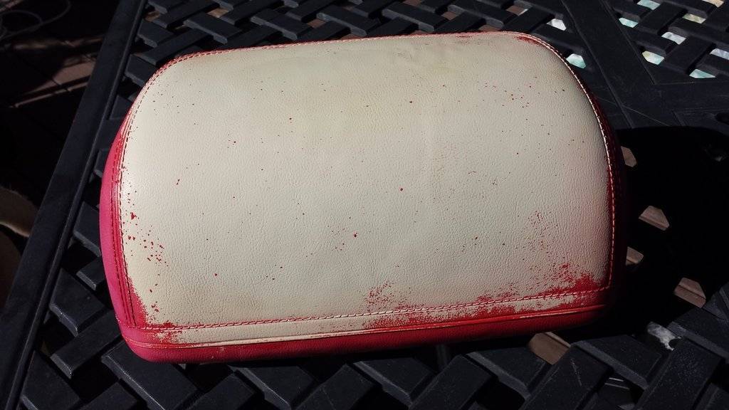

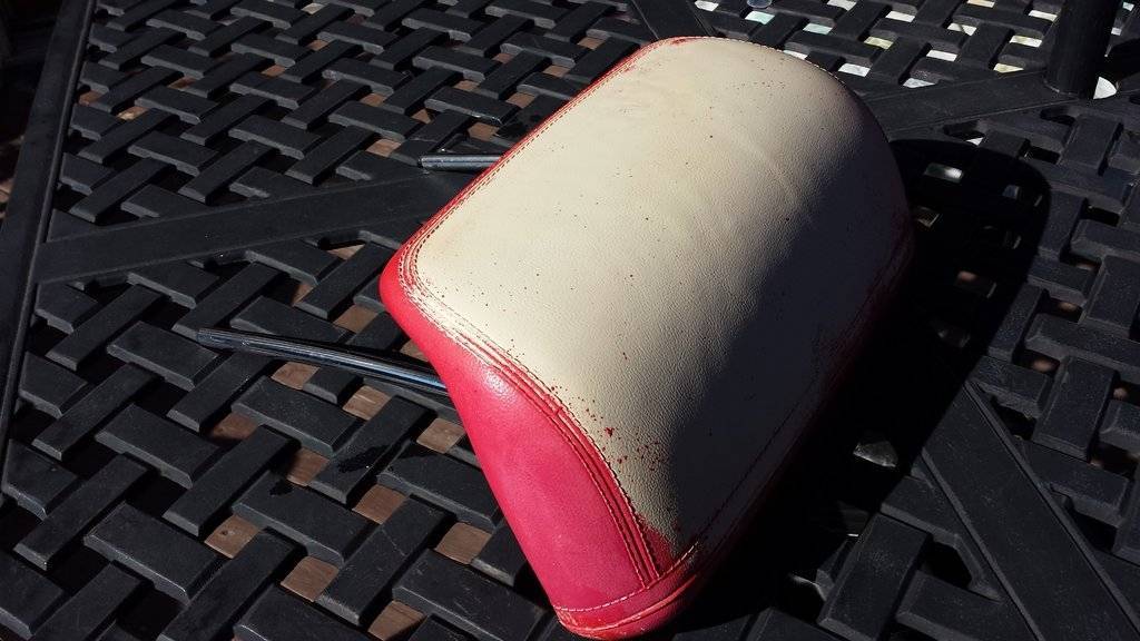

Getting there...slowly....Goof off product.
View attachment 135786 View attachment 135787
Actually, from the looks of it, you're biggest PITA with this will be the stitches. Once you get the majority of it off, you may be able to wipe it with a suitable leather polish .. they come in colors and will fill the seam and cover that red ... hmm.. looking promising as hell tho! Good work!
TARRAGO Shoe Cream Jar (94 colors available)
This stuff, actually. I have a pair of grey boots that I use the steel grey on .. covers up black scuffs so I'd imagine a closely matched white would be dense enough to cover any small amounts of red left in the seam ... justa thought!
