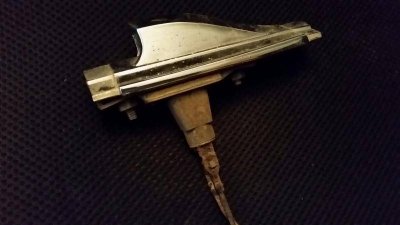

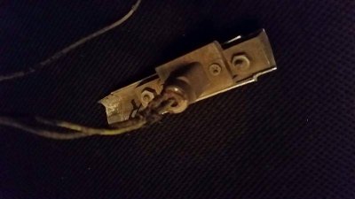

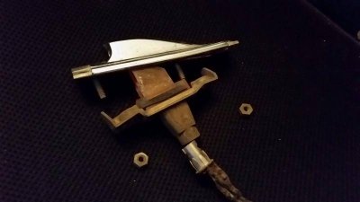

p.s. my hood turn signal assembly is different that pictured above, unless my fingertips are lying to me.
Yours should be like this. This is one of my spares. The socket just slides in and is held in by small fingers on the socket.
