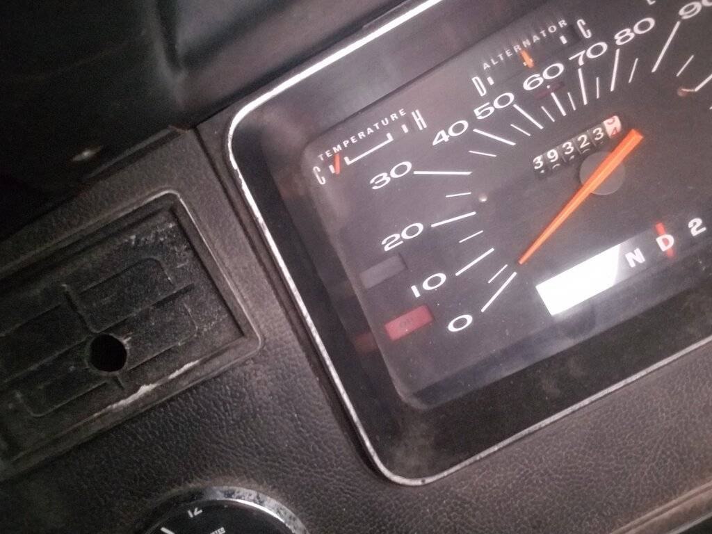

How's it going all. I really need some help with a cooling issue I have and I would really appreciate any and all help. A few weeks ago I was driving home from work and noticed my temp gauge alittle higher than normal. This is a 1973 plymouth fury with a 360 btw. So I noticed my gauge alittle bit high and kept an eye on it, the scary part was after a few minutes I had a very sharp and sudden temp spike. My gauge went through the roof and slowly dropped back down. So I thought the worst (blown headgasket even though I wasnt driving it hard) and pulled over. Checked my coolant level, it was alittle bit low and alot of air escaped when I released pressure from my cooling system. Topped it off and checked my oil. I didn't have coolant or oil mixing. So I babied the car home (keep in mind I daily drive my fury 180 miles every day) I noticed my temps would drop when going down hill and would randomly spike and then go back to normal. So anyways long story short I replaced the thermostat and the car was fine for a few weeks. Tonight on my drive home the car did the same thing again. I live in northern nevada its winter right now, we have snow, we are lucky to get above 40 degrees Fahrenheit right now. I've been driving this car daily for over a year now and never had an issue with it even in the hot nevada summer. So why am I having cooling issues now when its colder than hell. I havent changed much recently besides the belts and an alternator and changed the oil. Idk what my issue is, another thermostat? Should I run no thermostat? The first time I had this issue I put in a 160 degree fail safe thermostat and it did fine until tonight. :( I'm so bummed right now

Did the engine really get hot or did the gauge just malfunction?
Generally, they don't spike like that. A bit of bad insulation could be shorting the gauge wire to ground, the voltage limiter failing, or even the gauge or sender is failing.
Some sort of other failure, like a head gasket, might drive the temp up fast, but not really "spike" the gauge. If something drove it up high fast, I wouldn't expect it to just come down on its own either.

I agree with Big John: intermittent short to ground in temperature sending unit TSU wire.
You could bypass the wire in the engine compartment harness, by butt connecting in a new wire from your bulkhead connector to your TSU connector. If the problem goes away, you've found your problem.
With no steam, smoke, boil over, I doubt you're really overheating.

I thought the same the first time I had this issue and I replaced the temp sensor and checked my wiring for any damage. Didn't find any but I know something is still wrong because my gauge has always read extremely low since i got the car. I drive 90 miles to work every morning this is my temp after about 60 miles of my commute, it's not actually low. Something is wrong with the gauge or wiring, but it does respond to temp change. I changed my radiator cap last night just because I had one and topped off my coolant. Didn't have any spikes this morning.
