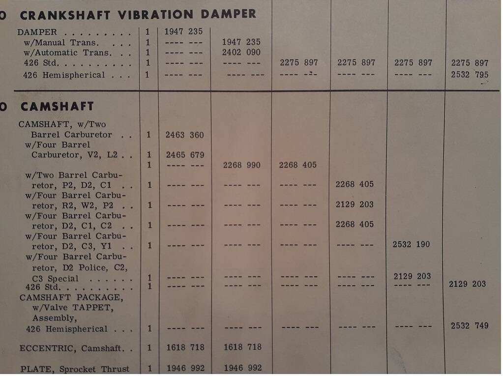

That how I remember it from "back then", but in looking in both the '65 Chrysler parts book and service manual, there seems to be some information that does not match what the 1965 Petersen Publications Engine Annual had in it (specs generated for all produciton engines that year, as reported to the SAE).
The one thing which seems to "match" is that the 413/360 and 426Wedge have the same cam. Service manual specs are 268/268/.430" lift.
383 2bbl and 4bbl are the same cam, 252/252/.389" lift
413/340 shows something I hadn't seen before 256/260/.430" lift (which is almost identical to the '66 440/350 and later "Standard Cam" 4bbl designation. Might need to do some more digging . . .

The 360 hp camshaft was a .444 intake lift/.450 exhaust lift. The 340 hp engine was a .430 intake lift/.430 exhaust lift.
Dave

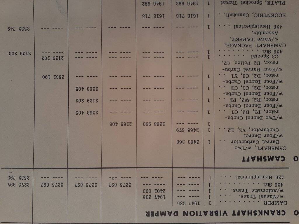

So on that camshaft chart what do the letter and numbers mean. Are they stamped on the cam or part of the engine number or?
They are vehicle model designatins. Remove the first letter and use the remaining letter and number. C1=Chrysler Newport, C2=300, C3=New Yorkwe, Y1=Imperial. "300K" would be the 300 Letter Car model with the 413/360 motor (as noted by the asterisk decode at the bottom of the page). The "P" and "D" versions would be for Plymouths and Dodges, respectively, with the number progression being from lowest-line model to the highest/fanciest model. The "R" and "W" would be what we now term "B-body" vehicles.
It can be a little confusing, compared to the newer books and more direct model designations. The "426" listed is the 426Wedge motor, not the 426 Street Hemi.

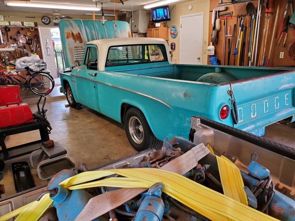

That's crazy to think they used that many different camshafts in the same engines. I'm thinking that Imperial was a pretty mild stick. I do want to wake it up a bit, mild stick, dual plane and a pair of tubes. Its going in this.
