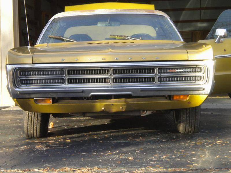

First line of work to do

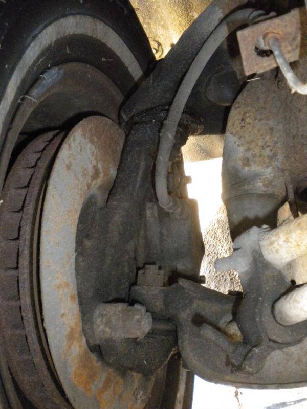

I did check out the car again this weekend and took a few pictures of the wheel that tilts inward, can any of you judge from the picture, what it is that is bad. Upper, lower, ball joint??????
I am far from an expert on these things any help would be great. After I get a new battery for the car I will be temporarily moving it for an underside inspection here in a few weeks.
I was thinking about getting a "Original performance standard front end kit from P-S-T" but I want to get as close to OEM as possible, I might as well do all four wheels if I have to do one of them.

Hi John, you will need to take the wheel off to take more pics. it does appear as if the upper ball joint has popped out the top? It doesn't look right at all, plus if you could take pics of the bolts holding the upper control arm to the chassis as well as a photo of the top of the arm, that will give us a good idea of whats going on, the lower ball joint is intact but we cant see whether it is worn on not. Cheers,

As for the front tire issue, I see nothing bent in your pic...an inspection of wear items (bushings/ joints etc.) and an alignment should sort that out.

Think ya nailed it with the upper ball joints. Almost EVERY mopar I've ever owned had this issue at one time or another....A,B,C or E.

I think wollfen is right ball joint poped out of control arm, they thead in and a little bit of rust and or a gas station gorilla they are fairly easy to crossthread. If you can coax it back down into the controll arm with wieght off the wheels and get it seated again tack weld it in several spots to the control arm at least it will get you mobile.

I messed around with the Fury several months ago and noticied the reason the car was not starting or turning over was because I had the trans in the Park position. As this makes no sense to me, I tried starting the car in neutral and she started right up. A friend of mine mentioned the transmission is out of line. I have only drove the car down the street once after this incident, the transmission shifted fine. The car has currently been in storage since last winter, when I started this thread, in my parents garage in OH. Next week the fury will be trailered down to my place in Northern KY. My next door neighbor parts out cars and restores the late 70's malabu's. He stated he would help me with the ball joint problem on the passenger side. This neigbor is fully equiped with all the tools nessesary to overhall a car if needed and he stated I could borrow as needed. I have recently moved to a house and now have a garage to keep this ship in and to work on the car this winter.
