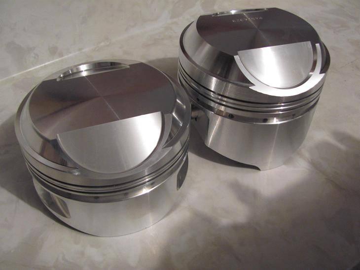

The taller 528 pistons are shelf Wisecos with Valve reliefs for 2.25" valves, and the 572's are custom made Ross pistons for the large valve heads.

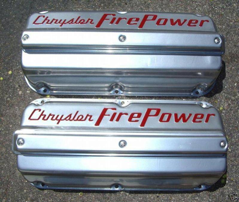

The nice one is just an example of the color that I want to paint mine whenever I get it done.... My car was only the crappy deteriorated white one that has been retired since 1962. I did look at the odometer and it is 57,863, but time has been hard on it... Enough so, that I don't feel bad not going back original, other than it will remain a "Hemi car"... Another thing I think would be cool, is to laser engrave "Chrysler Fire Power" on the polished aluminum valve covers, like the Chrysler Hemi of its day.... So many ideas, so not enough money, and so in need of my own shop... there's the money thing again...

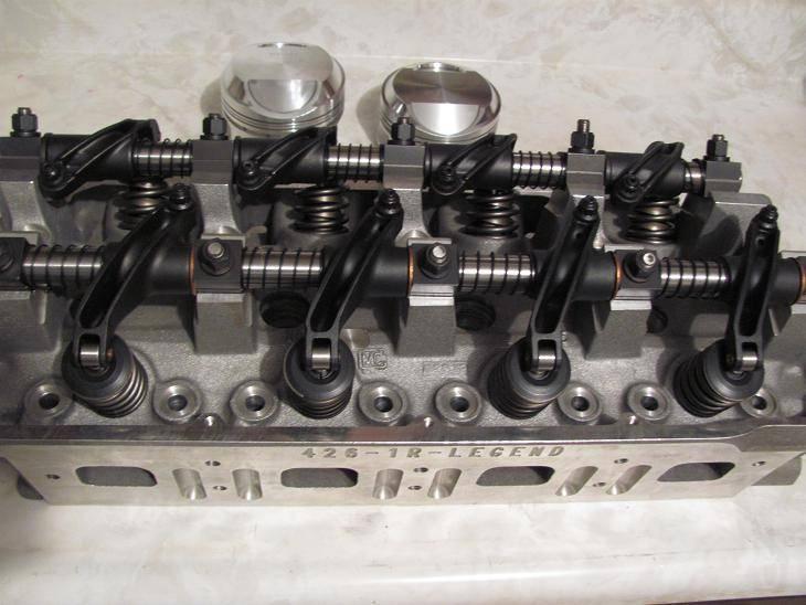

What kind of rocker arms do you have? I mean which manufacturer?

The rockers are Indy, with 1.55 and 1.6 ratios. The Indy heads have integral rocker stands, which are nice for pulling off your rockers without having to retorque the head, but removing and replacing the rocker assemblies themselves is more troublesome.

THIS (!!!) is art! Why my wife prefers jewelry over this is beyond my comprehension.
attachment.php
Especially since the pistons are shiny....my ex would drag me shopping with her all the time.......she always went after the shiny stuff.
