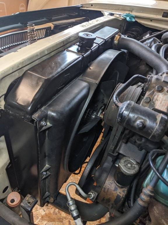

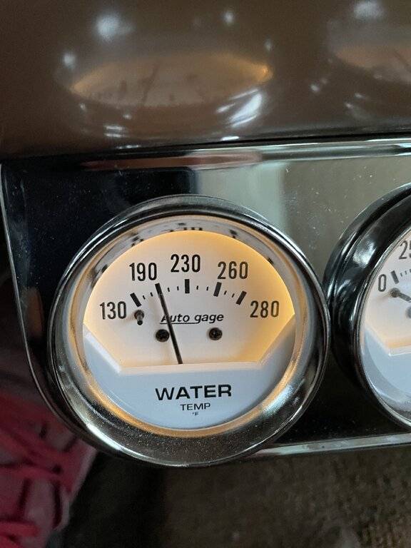

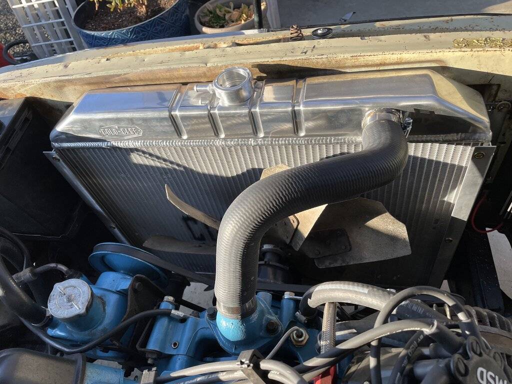

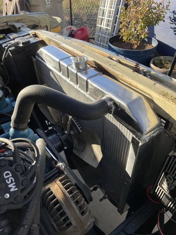

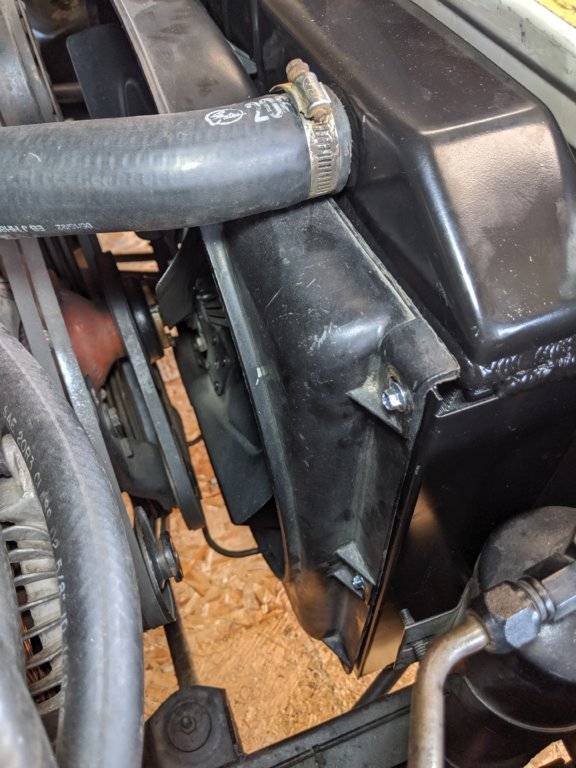

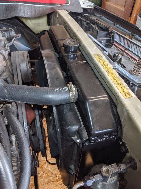

Last night I installed a new direct fit Cold Case aluminum radiator in my Newport. I was having some trouble with it getting warmer than I'd like during these warm months in Oregon. I will be putting the fan shroud back on tonight. I did not have the necessary hardware to do it last night. Its already 5 or so degrees cooler than it was with the original, never touched, factory radiator. And it looks good too!

Thanks ,,so no surprises with the installation?

Haven't seen a lot of them, but that Cold Case looks better than the replacement radiators I have seen. Nice work, and I'm sure you're relieved that it's running cooler. Haven't priced a radiator re-core lately, but I bet that $379 is worth the trouble, not to mention the free shipping.

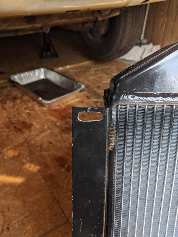

No, one mounting hole was slightly off so I just used a drill bit to widen it out a little but. Also the trans cooler line fittings were a slightly different thread size so I had to get new fittings to screw into the bottom to connect the trans cooler lines. Last thing was the fan shroud mounting spots needed new hardware. It required screws instead of having threaded posts to put washers and nuts on. Both upper and lower radiator hose locations were spot on and it fit directly where it should have. Overall I am pleased with it and happy with the outcome.
The quality and fit and finish seems very nice. I'm happy with the purchase and it looks like its going to keep the car 5-10 degrees cooler which is what I was after.
