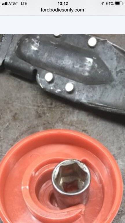

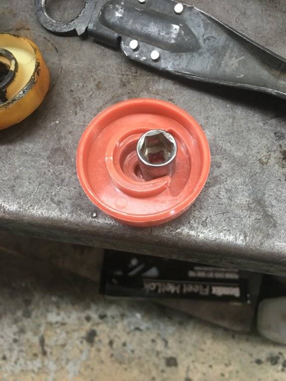

Yep. Definitely modified already.
When you say “modified” are you speaking of the rivets?
If so what was modified? I ask only because I have my wiper arms out as well to replace all the Teflon bushings that have dry rotted.. should I look for anything in particular? Thx
I've got one in my tool box... I couldn't see how it could work and wanted to put it up someone's sphincter.:lol:
After seeing this, maybe I'll take another look, thanks Javier:thumbsup:
I was just about to post this, then took another look at the pics...
I think this cars wiper transmission has been modified before. I don't recall the end being riveted on its all one piece see below...
Notice the four rivets above the orange thing. One of them is even offset for some reason.
If it was modified its a good thing. Then those parts will always be available.
When the weather gets nicer I'll investigate some more.
Nice observation! I completely missed that.
Judging from the amount of tweaking I had to do with the driver’s side wiper arm, somebody was definitely in their trying to “fix” it before I got there.
Remember that PO was an airplane mechanic and we may have all just stumbled upon someone else’s take in the problem. This may just be a minor legacy of the PO’s love and stewardship of this old girl.
The slight torquing I felt putting in the motor might be explained by the, now obvious, modification to the power arm.
If that is the case, this may actually be another way of solving the the problem outside of what’s been discussed to date. Namely, the modification of the power arm to accept a later R Body transmission/coupling.

We'll see how long it lasts. No one previously has had sucess with that cam. It doesn't look like the offset is the same as both of my 78's. Maybe it's a piece from an R body.
As far as the transmission bushing. You can still go to Dodge and ask for a bushing for a 1996 or newer Dodge Ram Van. They are still available and are a lot better constructed than the Help variety pack bushings and will last a lot longer.
Agreed.
This seems to me to be a much better designed and executed part than the typical Dorman knockoffs I’ve ever seen.
The proof will be in the pudding as they say.
I’ll be sure to let you all know if and when it fails.
Javier.
