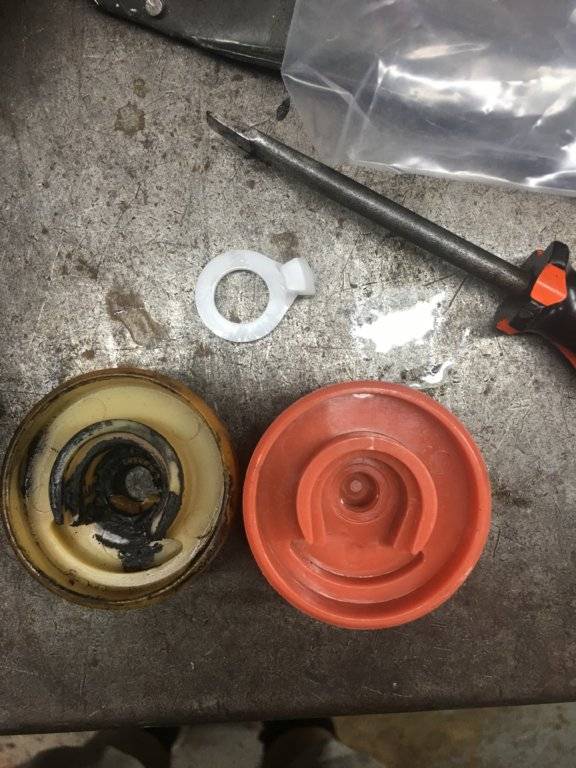

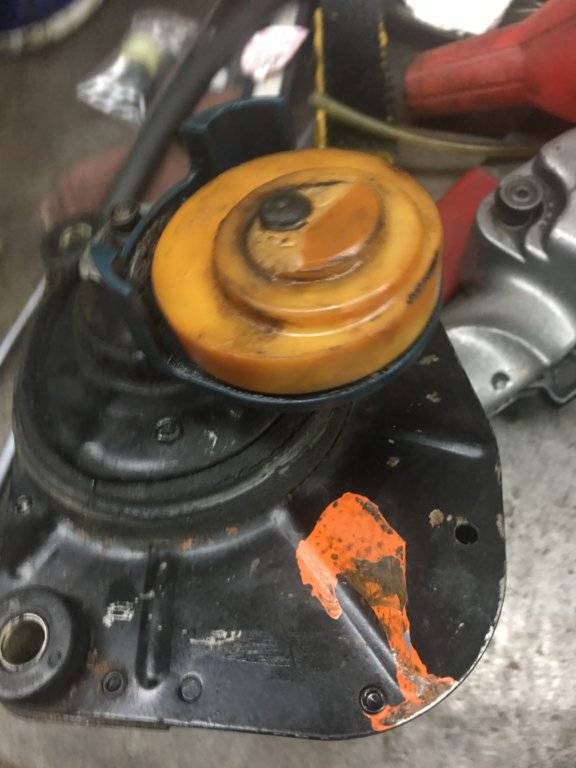

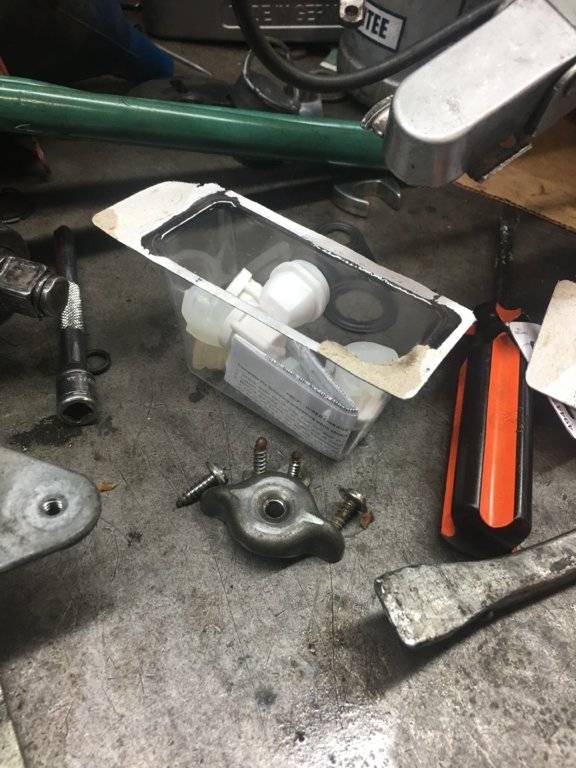

Looky what I got today.... bought the kit on eBay. Pricey at $75 but if it works....

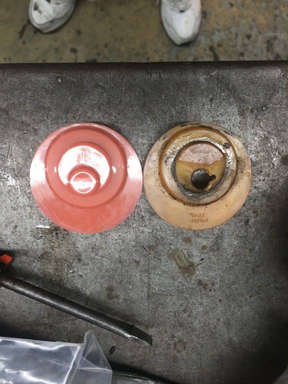

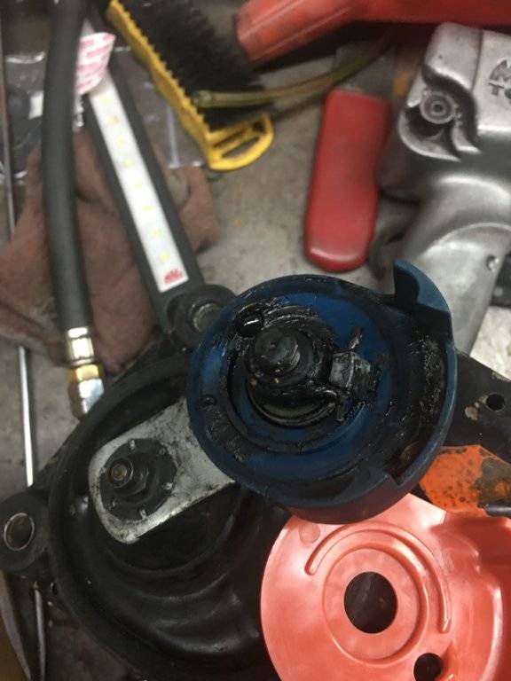

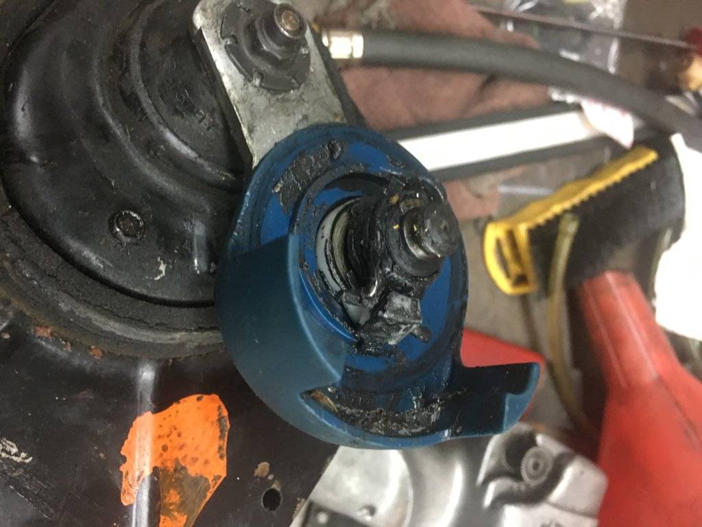

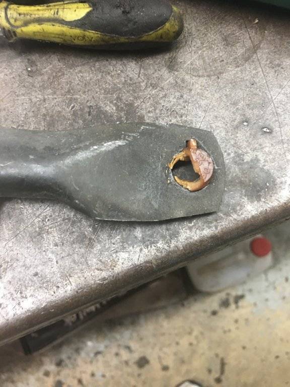

Here’s where the failure occurred. I think I definitely got the last wipe out of it.
A view from further out.

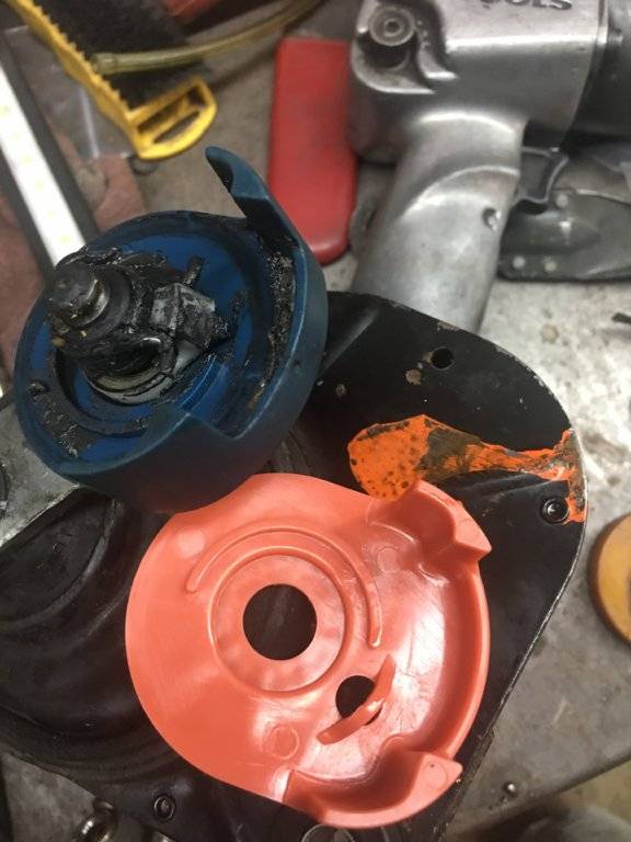

Needless to say, the other press in retainers were the consistency of refrigerator dried out velveeta.
New compared to old part. New part has a slightly larger retaining lip for the power arm but it is also beveled to make install possible. This is a well engineered part.
Funny that the lower part is a different color on the original. Also, the ball bearing retainer is in a different place on the replacement. 180 degrees out as is the raised inner lip. Thought for a moment to use the original but it wasn’t parking correctly. So I went all New with the kit. Inner spring and cam were fine. Just needed cleaning.

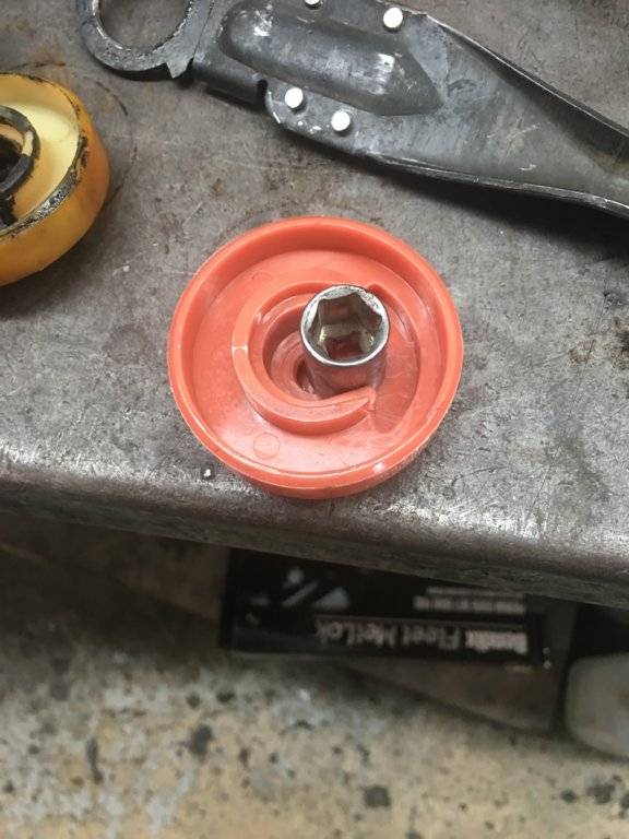

The tops were identical. The hardest part of the install was not the disassembly. Pressing the power arm into the cap was a mission. I really didn’t want to screw the pooch by breaking the new part. Ended up using a 1/2” socket inside and a 24mm wrench outside the opening to hold and press on the power arm. Once I got it all lined up I squeezed the whole contraption on my bench vise until it went in. Material is fairly flexible with excellent memory. The first two tries failed but didn’t scar the plastic. It’s a surprisingly good material.

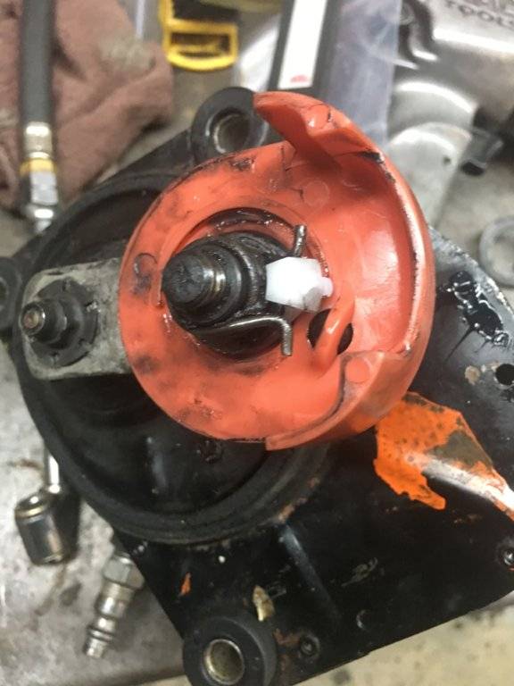

Here’s the new bottom end with the old spring and new cam. I did reuse the ball bearing and e clip. Of course, I lubed it all up prior to assembly. Moly axle grease. Everything in the kit fit very tight but not impossibly so. Somebody did a terrific job creating this part so it can work with the material used. Slightly under sized to have the material compress to fit.

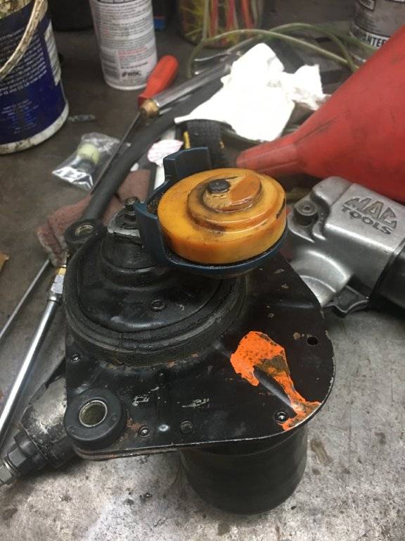

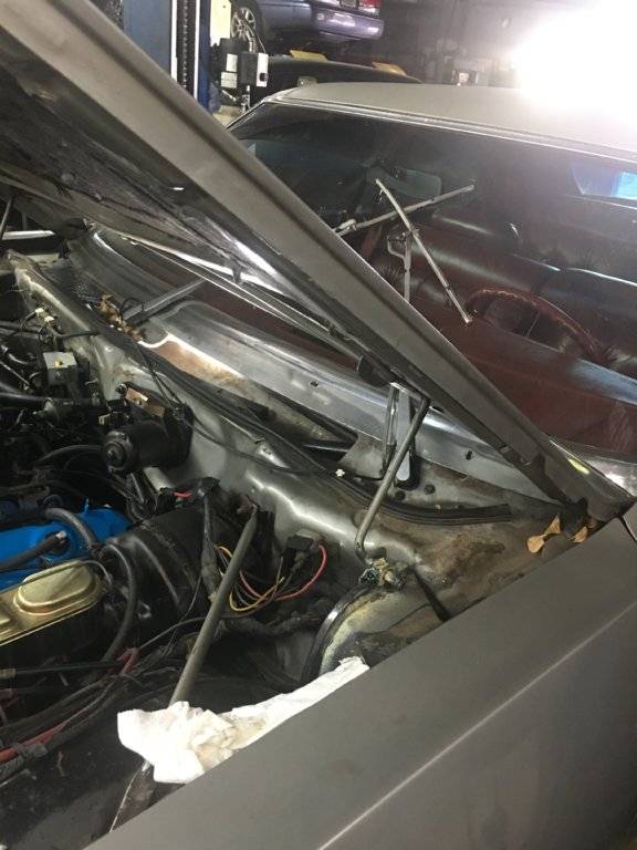

Decided to pull the whole thing out to clean it up and lube it.

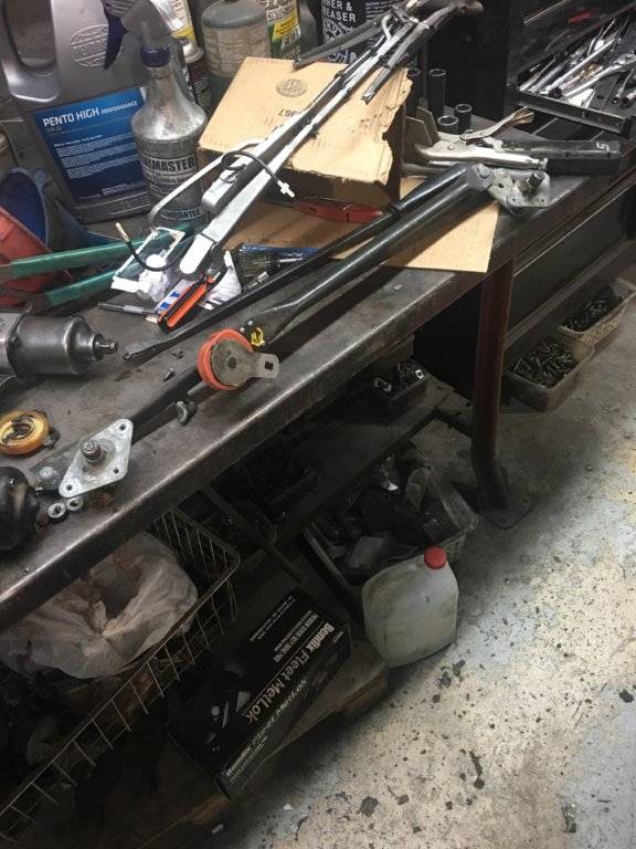

To complete the install picture stream..since FCBO only allows 10 pictures per post.
Here’s the cap that goes attached to the power arm. I used 1/2” socket on the inside. Note I placed it off center to align it with the mount for the power arm that is also off center.
Here’s the right side of the link arm with the pivot. I pulled the whole contraption out.
If the kit has a fault it is that it only brings one retainer bushing. I remember when they used to sell you just the Mopar bushing retainers. Now you have to buy a whole assortment. Marketing....
Here is the whole linkage complete and ready to go in.
I ended up adjusting a lot on the arm placement to get them where they would delay on the glass, snap down all the way in park and align the drivers side wiper to finish with the wiper blade parallel with the A Pilar but I got it all sorted.
All told, it was about 6 hours including the time to run out and get the two extra bushing retainers I needed to complete the job.

I was just about to post this, then took another look at the pics...

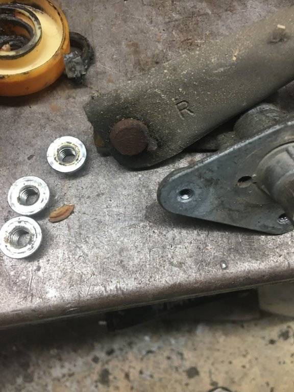

I think this cars wiper transmission has been modified before. I don't recall the end being riveted on its all one piece see below...
Notice the four rivets above the orange thing. One of them is even offset for some reason.
If it was modified its a good thing. Then those parts will always be available.

Mystery solved... thanks Kenny... IDK why nobody else spotted that... I sure didn't.
